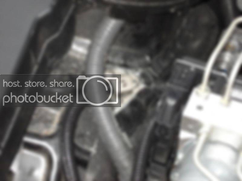

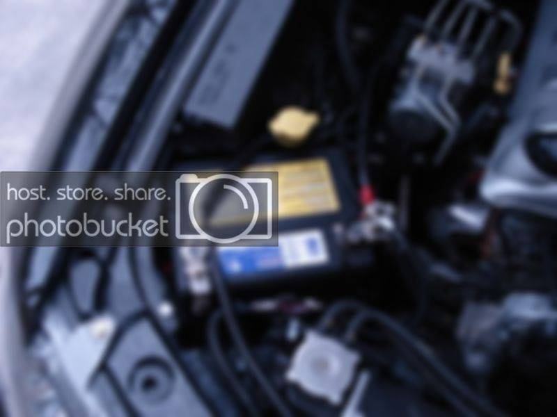

First step was big3:

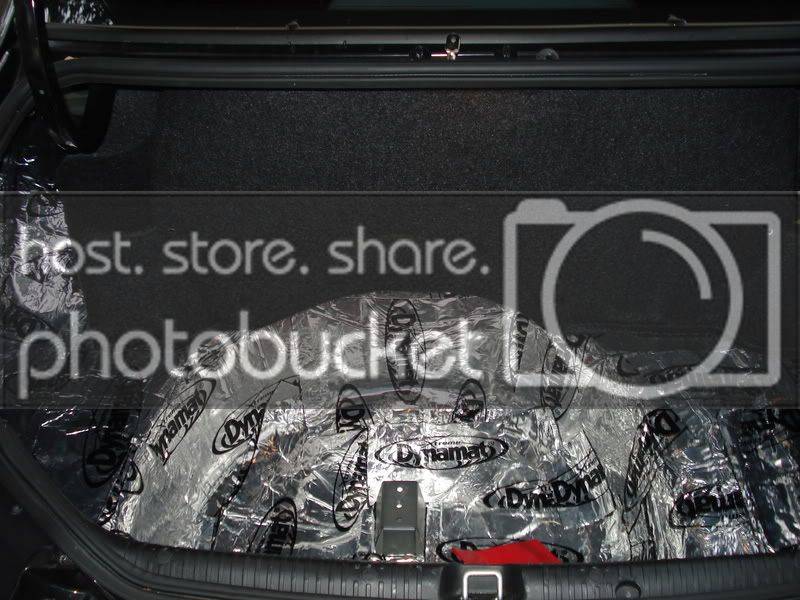

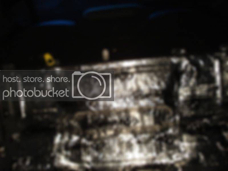

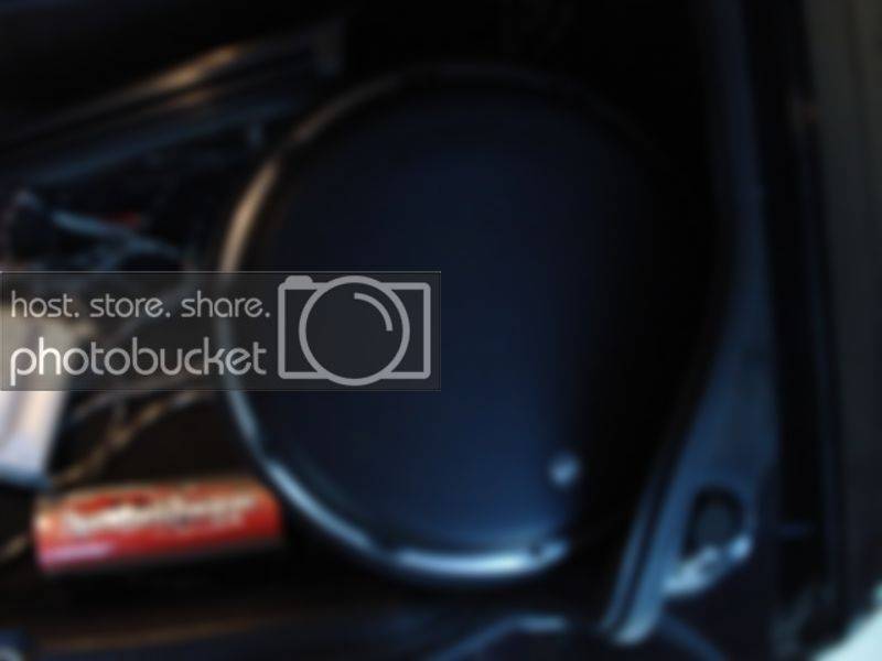

Next was the dynamat: About 75% of the car was done

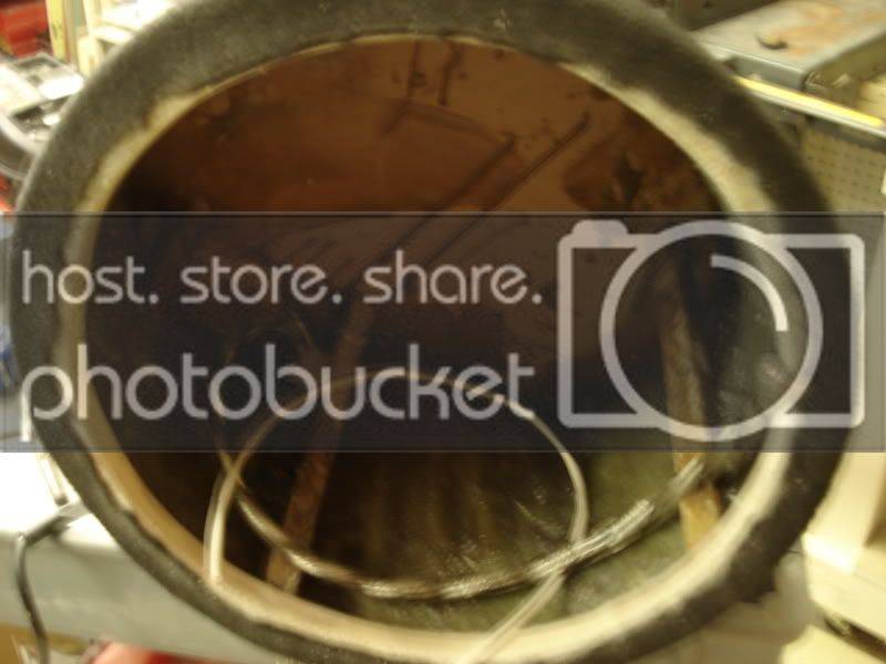

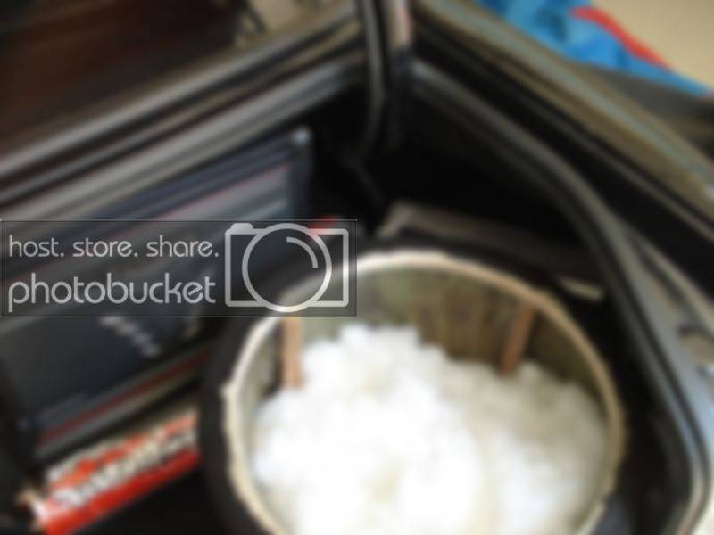

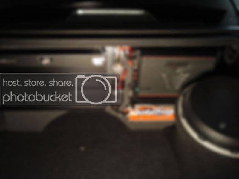

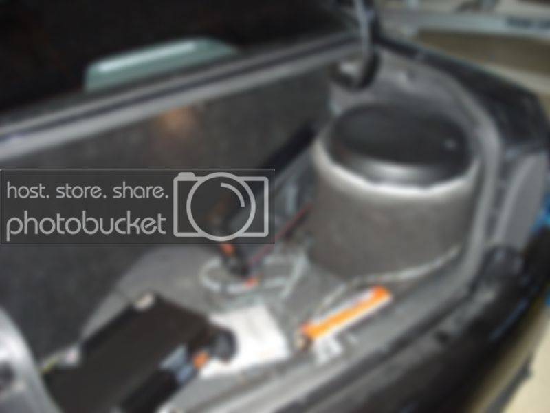

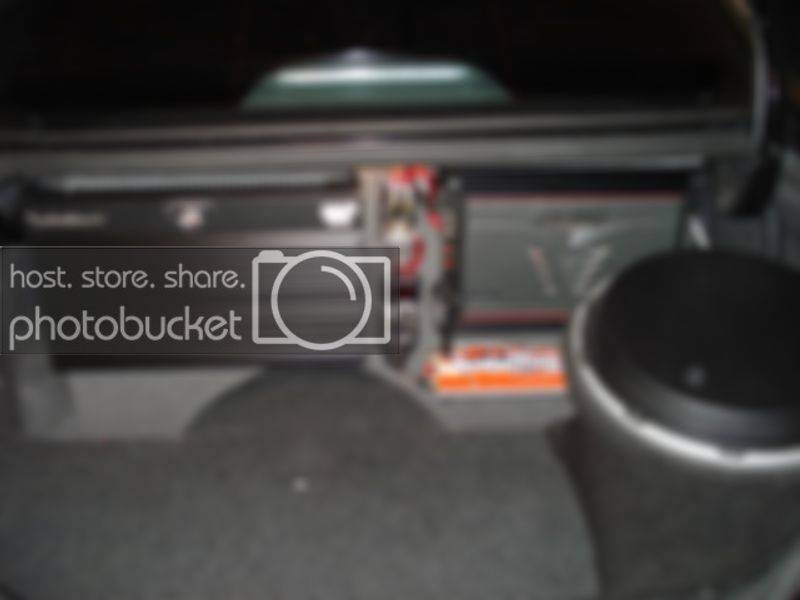

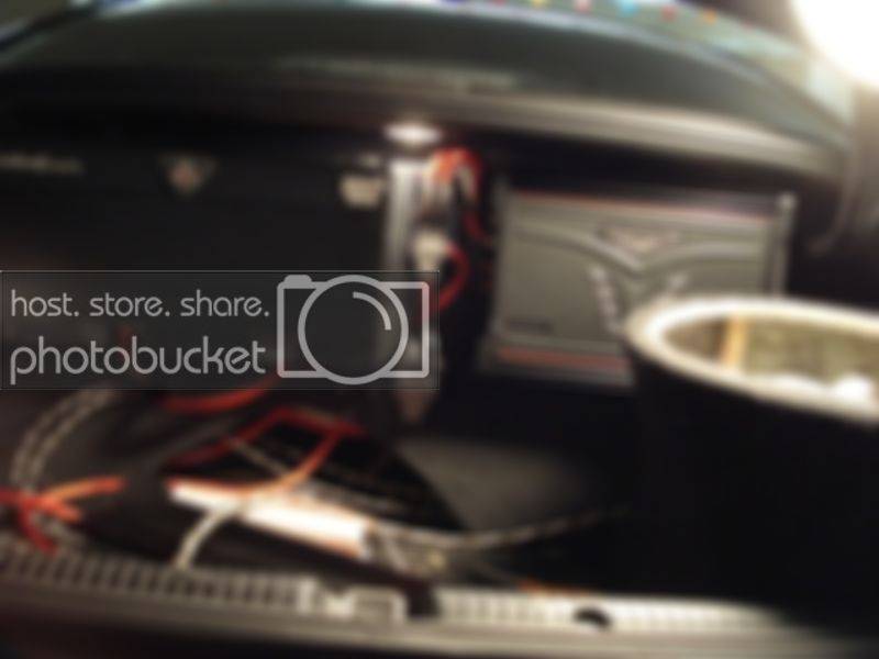

The trunk in the gto is so small I didn't want to go with a standard wood box because it would just take up so much room. So here is the fiberglass box I had made:
The gas tank in the trunk doesn't really effect any thing beside giving you little trunk space.

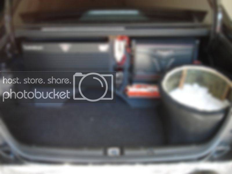

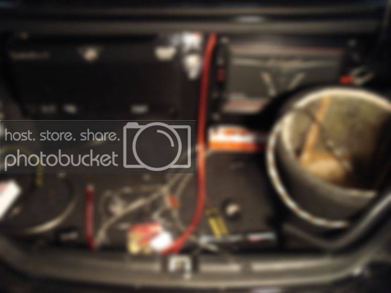

how do you kill a 56k modem with pictures?

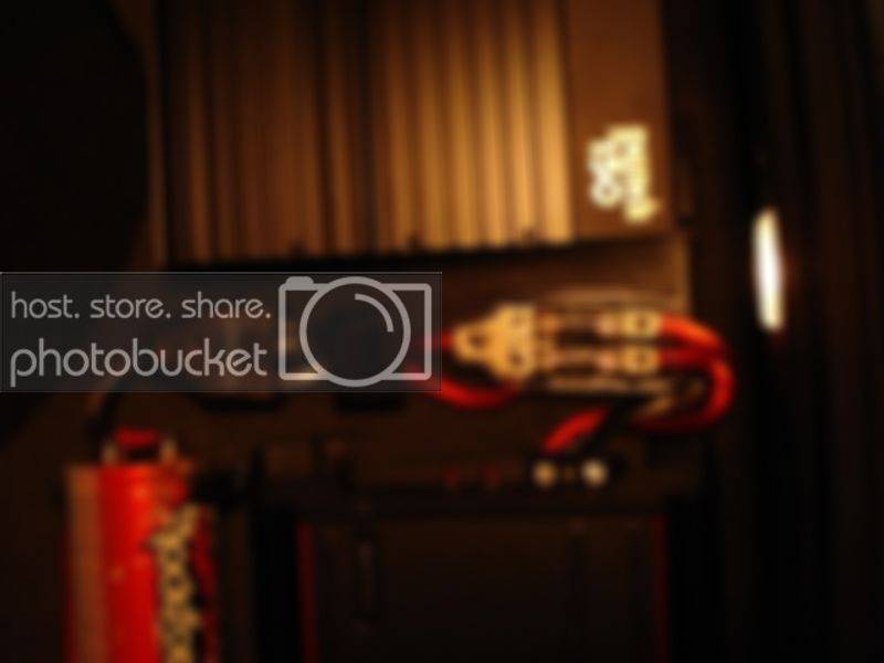

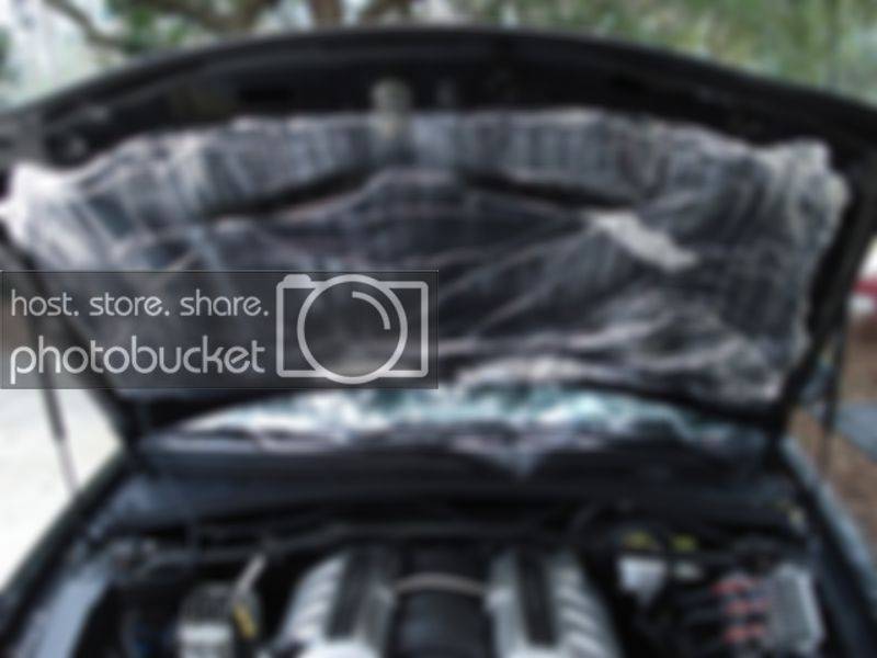

second: can sound deadening resist engine heat?
thrid: why do you have a cap?
btw nice setup
1. its just a warning //content.invisioncic.com/y282845/emoticons/wink.gif.608e3ea05f1a9f98611af0861652f8fb.gif
2. Yes, The hood is one layer of Xtreme and then hood liner by dynamat.. It really helped with keeping the hood cool.
3. The cap is used as a "noise filter".

How you like the hood sound deadned? I been thinking about that for my Caddy.
It really does cut down on heat and noise. The hood is cool to the touch, before it would be really hot.
The V8 LS2 that powers the GTO sound like a sewing machine inside the car when at high rpm. You can't heard any of that now. Big improvement.
The only thing I don't like about it is the silver color. I wish it was black so it would blend in better. I been thinking about painting it.

quick question. where did u get the stinger digital volt meter? been lookin 4 one but never could find it.
Thanks
I got it off ebay.
here the one I brought
http://cgi.ebay.com/ws/eBayISAPI.dll?ViewItem&item=360028053654&ssPageName=MERCOSI_VI_ROSI_PR4_PCN_BIX_Stores&refitem=260210130965&itemcount=4&refwidgetloc=closed_view_item&refwidgettype=osi_widget&_trksid=p284.m185&_trkparms=algo%3DSI%26its%3DI%252BIA%26itu%3DIA%252BUCI%26otn%3D4%26ps%3D41
They also have a blue color version.

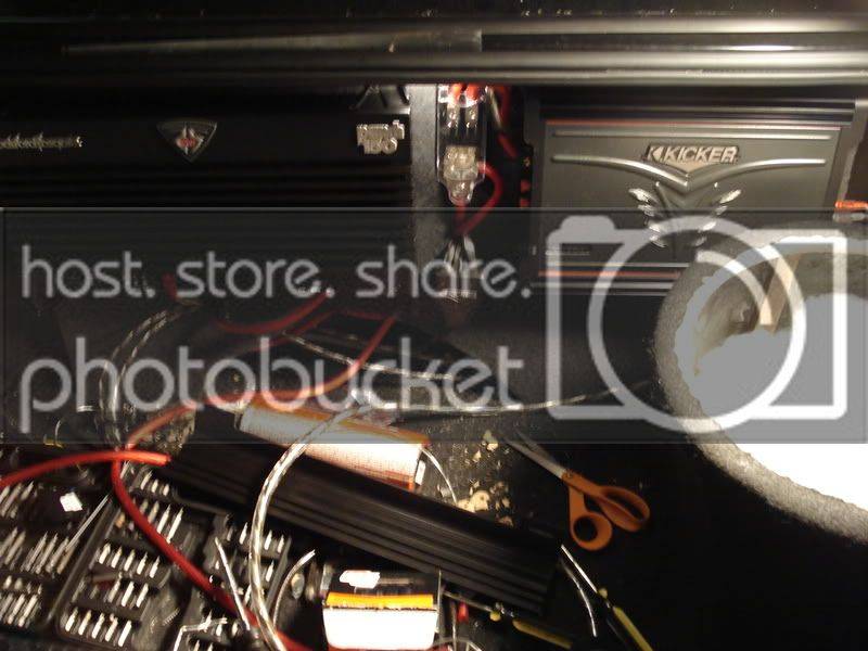

What do you mean the cap is a "noise filter"? Last time i checked the power wires didnt have much to do with noise.
Id sell it locally for $$$.
I use it to totally filter out the alt ripple from the amp power supply. Nothing more. As a noise filter, a cap works great, it doesn't need to really provide any current to speak of, just do some very minor voltage stabilization.

What kind of fused distro block is that? Not the kicker one, but the other one. I want it.
Thanks
Its rockford fosgate. I will look up the part # later when i get off work.
