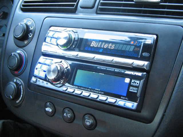

I like that too, especially since it's for my car. Once again god ole' req got out the dremmel tool and cut alot of fat off of my metra dash kit, reloacating this and that and moving some bars around. We just need to put another coat of bondo and a little more sanding, followed by some flat black spray paint, H701 will be here on wednesday, will wire the c701 tommorrow after work, and finish my trunk if all goes well

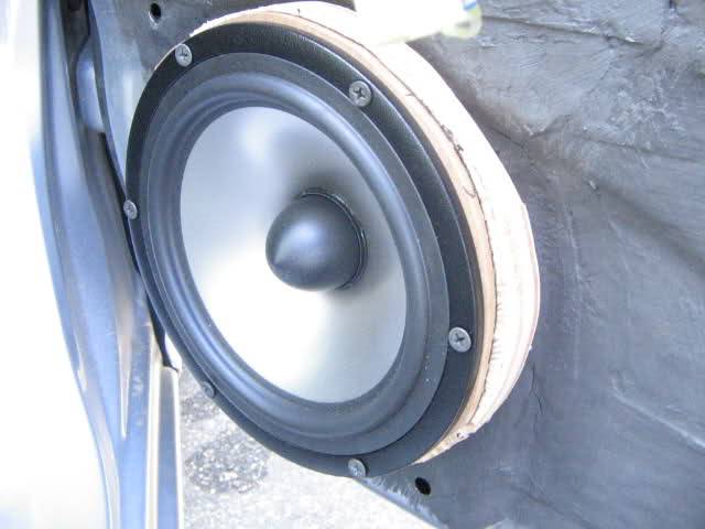

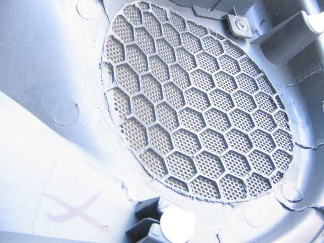

trimmed the inside of the door panel down to fit the larger diamater speakers.
thems the midbassuz

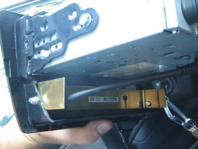

fabbed up a quick bracket for his c701

lets hear what you have to say //content.invisioncic.com/y282845/emoticons/smile.gif.1ebc41e1811405b213edfc4622c41e27.gif
