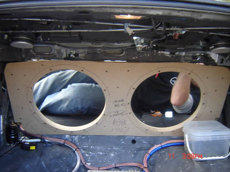

yeah i wonder if they could have raised the floor about a 1" to drop the amp flush....
nop. the subs could not go higher, and the floor clears the bottom of the motor by about 1" and the false floor (1\2" mdf) is resting on the floorpan of the trunk.
theres no more room in the tire well for anything. we were debating hanging the amp from the rear deck, but with time alloted yesterday and absence of 4 guage wire, the distance up to the rear deck was not an option.
so that is a final change that may happen before (or after) he goes to arizona. but for the time being, it is all installed, working, and somewhat presentable.

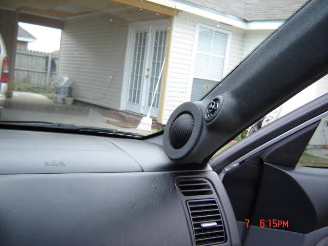

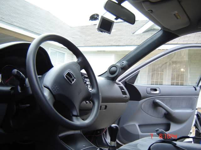

and Im interested by the use of the fleckstone paint on the pillars.. never would have thought about that before, but it came out looking really good

great build, I have the same model civic and been thinking of doing something so this RF midbass fits correctly in my factory door location. Might have to do pods. I do have a question tho, what size is this panel used as the baffle for the subs? i'm about to do a trunk wall and need a baffle just like that (only diff is it'll be for a 12 and port hole. here's the pic in case u can't remember. The baffle dimension would save me a little time and take down
actually the dimensions were written on that baffle but then it was carpeted, then the speakers were put in and wired up, so i'd have to take the subs out, peel the carpet back, and hope that the numbers are still legible, it wasn't very hard, we just used an old cardboard box to fit in there and made small adjustments to it until it fit perfect, then traced it to wood, cut the wood, and made another 5 or 6 small adjustments until it fit just right
