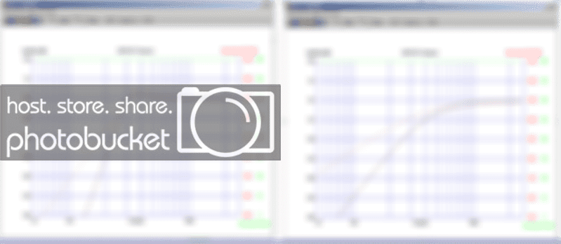

So here's the question, do the curves below look realistic if I was to turn the ported enclosure into a sealed one?
I know the volume of 1.1 cu ft net was ideal for the ported box, but when that goes up to 1.34 cu ft (ading the slot port vol) if I just seal the end up with a plate, seems large, especially as the recomendation for sealed is 0.28 cu ft per sub.
What will the it do to the subs going to over double the sealed volume?
is it like no air spring, like when a ported box is below it's tune?

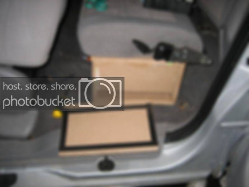

The folded port is at the RHS like this, so adding a plate inside where the port ends would also work.
I just dis this last night to the end with the port.

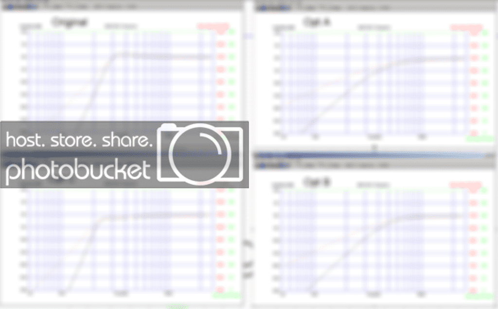

Ok, so I like the low cpability of the sealed version but normal 35-60Hz stuff obviously suffered with the curve being so shallow.
I'm torn now //content.invisioncic.com/y282845/emoticons/frown.gif.a3531fa0534503350665a1e957861287.gif
Do I...
A) Stick witht he smooth response of the large sealed enclosure and risk damage if I increase the power to it ?
B) Maybe add some blocks to remove a little volume to get some airspring back?
C)Go back to ported and rip out the folded port to gain box volume and add an external tube port (there's a space for it behind the box, under the seat backs)?

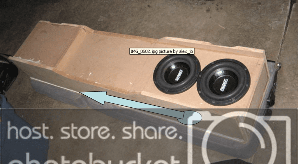

If I was to seal the folded port exit (like I have done) and cut a hole in the box near the middle, so the hole goes into the large airspace, and take 4" tubing out of the box and cut to length for the freq I want... would the volume of the old slotted port just act as normal box volume now?
I know it's a restricted size but because there's not ait flowing through this space anymore it should just now be box volume right?
Last question for today I promise...
box end of a port as shown a bad idea?
the port itself would be external in the direction of the arrow.
only oyher option would be port hole in the box at the arrow tip and the port opening would be where the oval is right by the subs.
