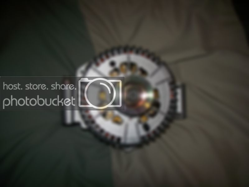

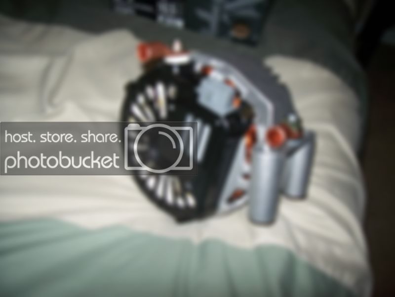

250 amp Mechman Alt. This thing is NICE looking.
beautiful. i'm really dig'n mechman's work.
