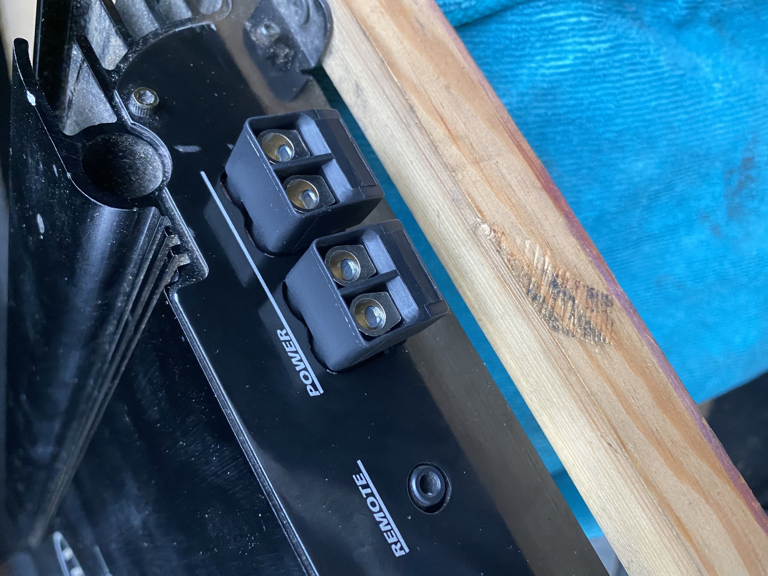

They are very powerful..A 2nd battery would be a must .. i haven’t used mine in a while but if I remember correctly they are only two ohm Mono stable .. also I think the input plugs fit only 8g power wire which is crazy on an amp that is so strong
this is the problem I’m facing now. Run 0awg through the car for the second battery however the input plugs are 8awg which isn’t strong enough surely? How can I get around this because running reducers they will contact and cause a big firework display to say the least
You can use a distribution block a few inches from the amp to go from 1/0 to 8g . It's crazy that Orion did that for that powerful of an amp . There use to be 4g plugs on ebay to fit these amps . I'm not sure if they are still there . Be careful with the gains my gain pot broke on my amp and killed it ...I guess with age it had gotten brittle
Never easy is it. So in theory going to need 2 of them as there’s 2 power 2 ground. PITA springs into mind. So buy two of these, one for power one for ground and run 8awg to the connections basically? Is that safe though? 8awg? Seems way too small for this amp, won’t them small bits of 8awg get way too hot as they’re obviously the weakest component on the wiring?
If the ground is the same way, then yes you'll need two of them. Its weird that Orion designed it that way, I assume it must've been so people could have aesthetic wire runs for builds. No need to worry about the wires heating up because the load is split between all four 8AWG wires, or eight between power and ground, either way the load is split and it should be fine as long as you use ferrules for the connections to make sure all strands of those 8AWG are being used.
Personally due to the PITA of it - I'd sell that amp and get something else with 0/1 connections, but if you really like that amp then you'll have to run all the weird wiring to get it connected.
Right okay cool thanks for the reply’s, i have two adaptors from 8wg to 0 awg so I could use them for the earth then use the distributor block for the powers. Yeah I understand about making sure all the wires make contact otherwise like you say it’s not going to be ideal. Yes very annoying about the amp but I’ve heard good things about them and I’d rather run it than sell it.
