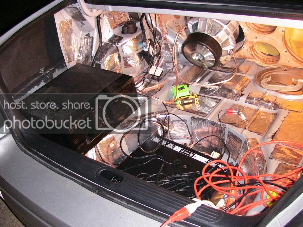

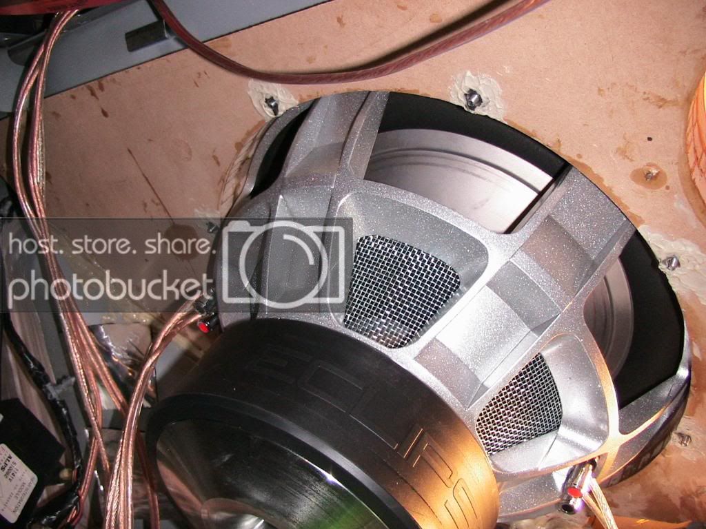

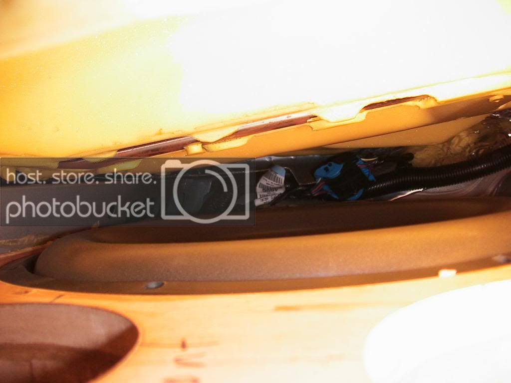

mounted one woofer to test excursion and make sure that it wouldn't hit the back seat
unfortunately i had to use a CD player to output the test tone because my zune can't drive the behringer amp well.
i think there's just enough room. Maybe 1/4" of clearance at full excursion. That'll do.
glory shot. These are some **** woofers

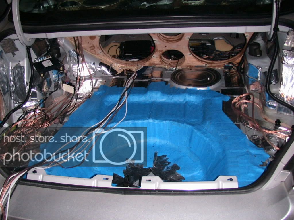

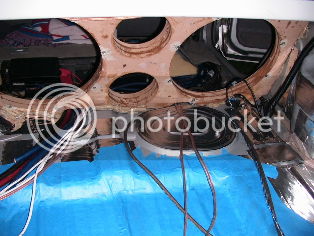

prepping for some glassing in the trunk

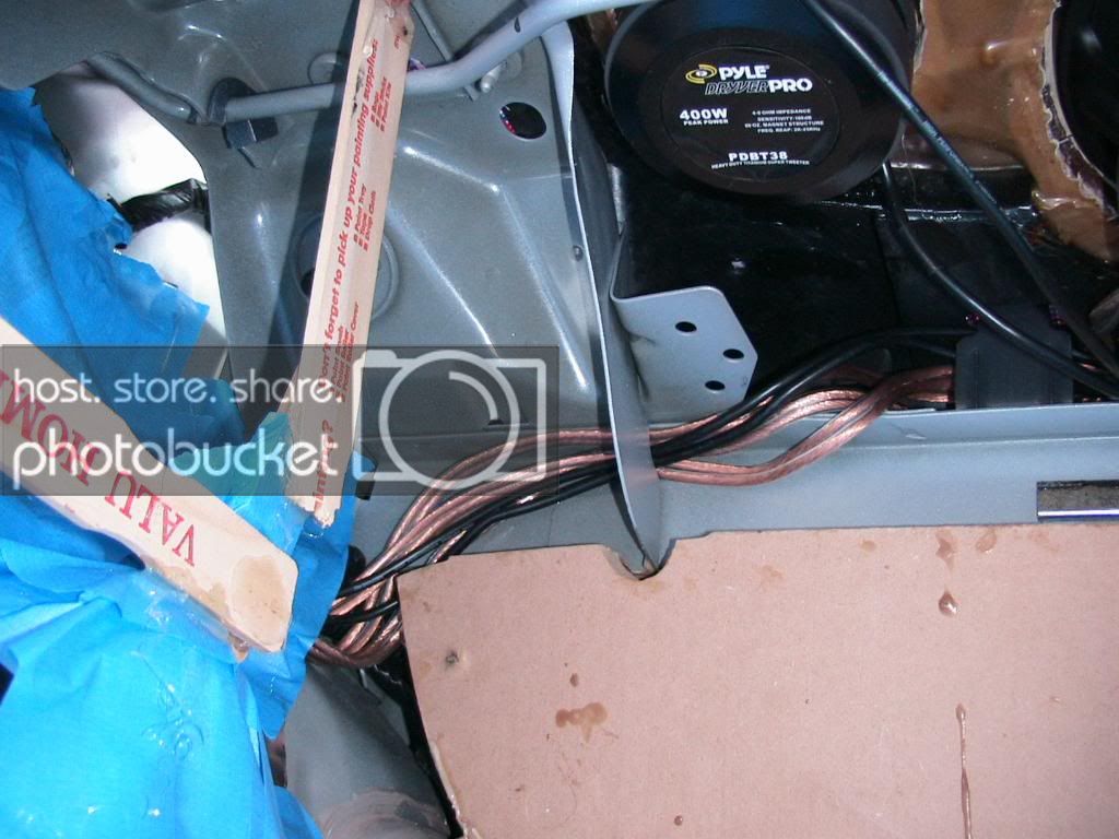

wire mis-management //content.invisioncic.com/y282845/emoticons/smile.gif.1ebc41e1811405b213edfc4622c41e27.gif
weather's supposed to be crappy on the entire east coast for the next couple of days, but i'll probably try to do work anyways!!

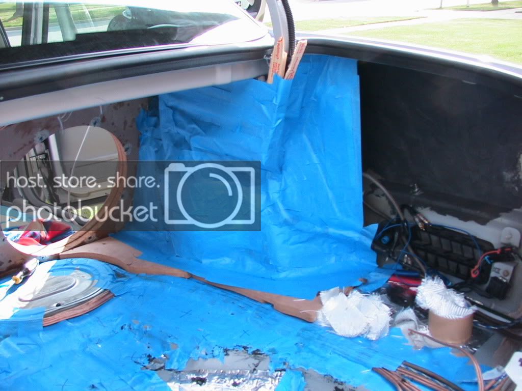

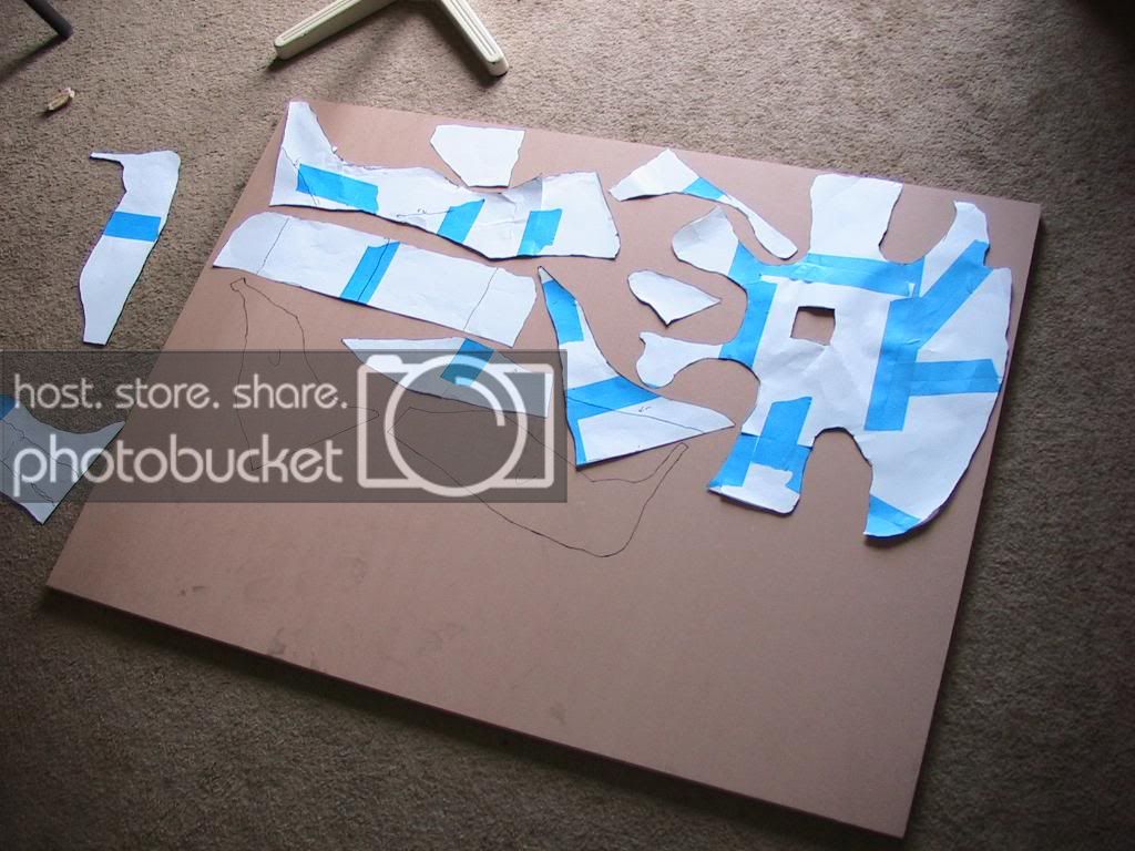

don't worry, it doesn't make much sense to me either. The pieces of paper are pieces of wood that will end up on the bottom of my box somewhere.

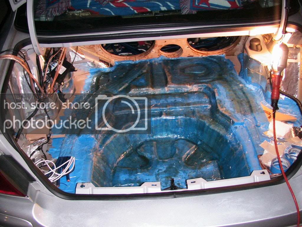

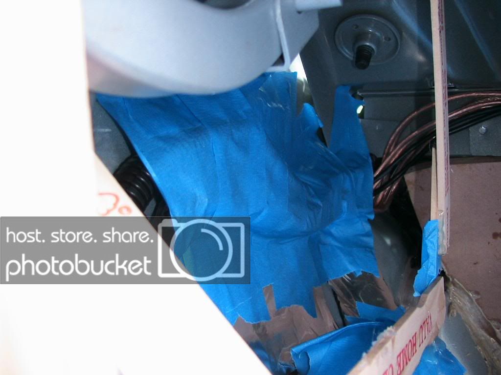

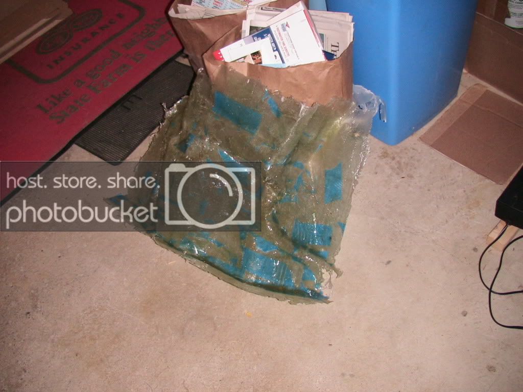

this was annoying. Pieces of wood got cut and taped over, and glass got put on stuff. More coats tomorrow and then I pull it out of the car (hopefully) and really go to town.

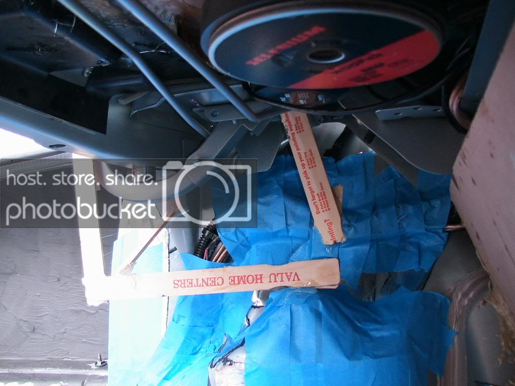

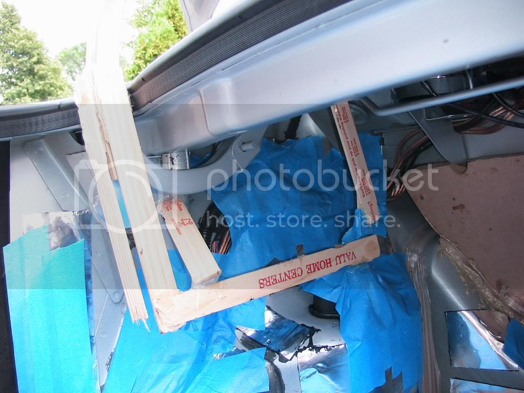

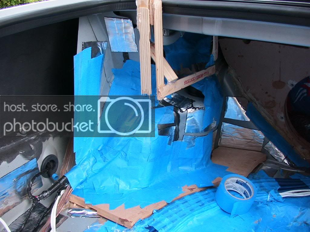

molded the right side of the trunk today:

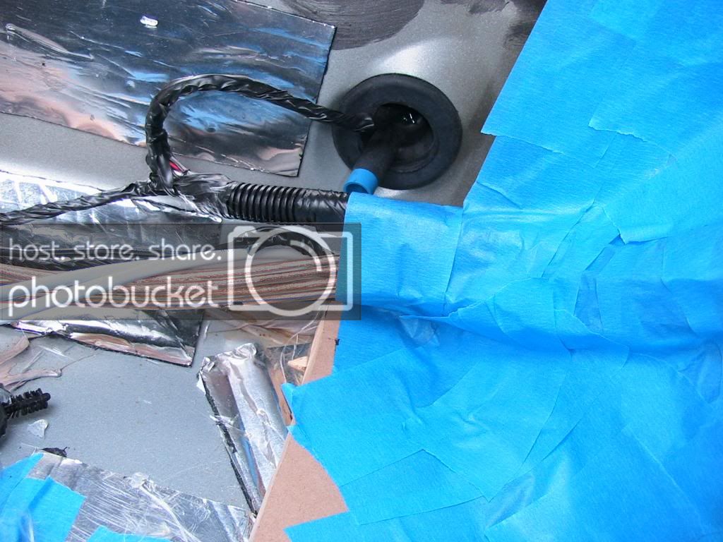

this was a giant pain in the ballsack, mainly because of the trunk opening and closing. Essentially, I built a small frame in that area that barely clears the bars in both the open and closed positions, hot glued it into the trunk (for easy removal later), then taped around that. I made a small mistake due to the wire looms attached to the trunk lid but it's an easy fix (or ignore, really. I could just get rid of the stupid looms....). The other side doesn't have the same problem so it'll be a tad easier.

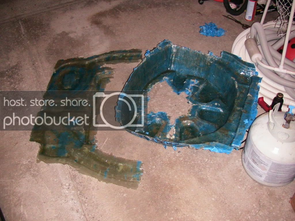

mold glassed and removed from the car. Later i'll be beefing up all three molds with lots of mat and resin. Probably another 2 gallons worth of resin or so. Also, there's a technique that you can use to add curves (strength) to the mold which I will do as well. All of this nonsense will be braced extensively as well, hoping not to lose any SPL to a weak box.

more pics showing what I did, i'm too lazy to explain most of them but you'll figure it out.
that kinda sort shows how and why my side molds ended up like they did. The idea of all this is to get as much volume from the trunk space i have as well as reduce added weight, since MDF is both heavy and takes up a lot of space.

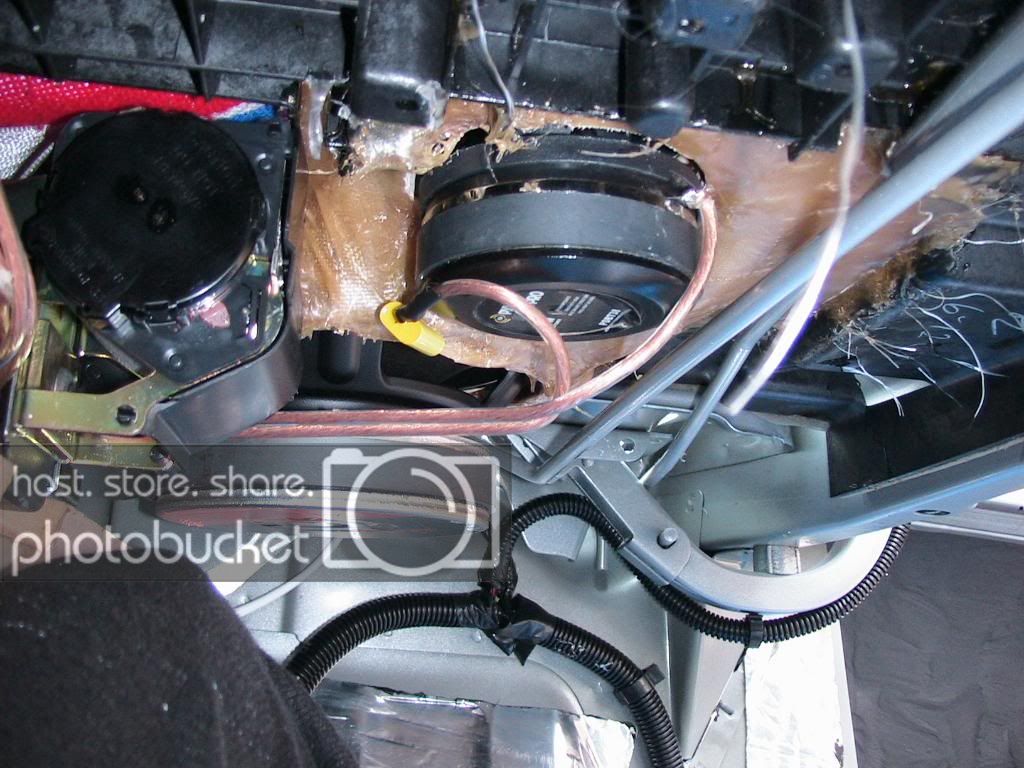

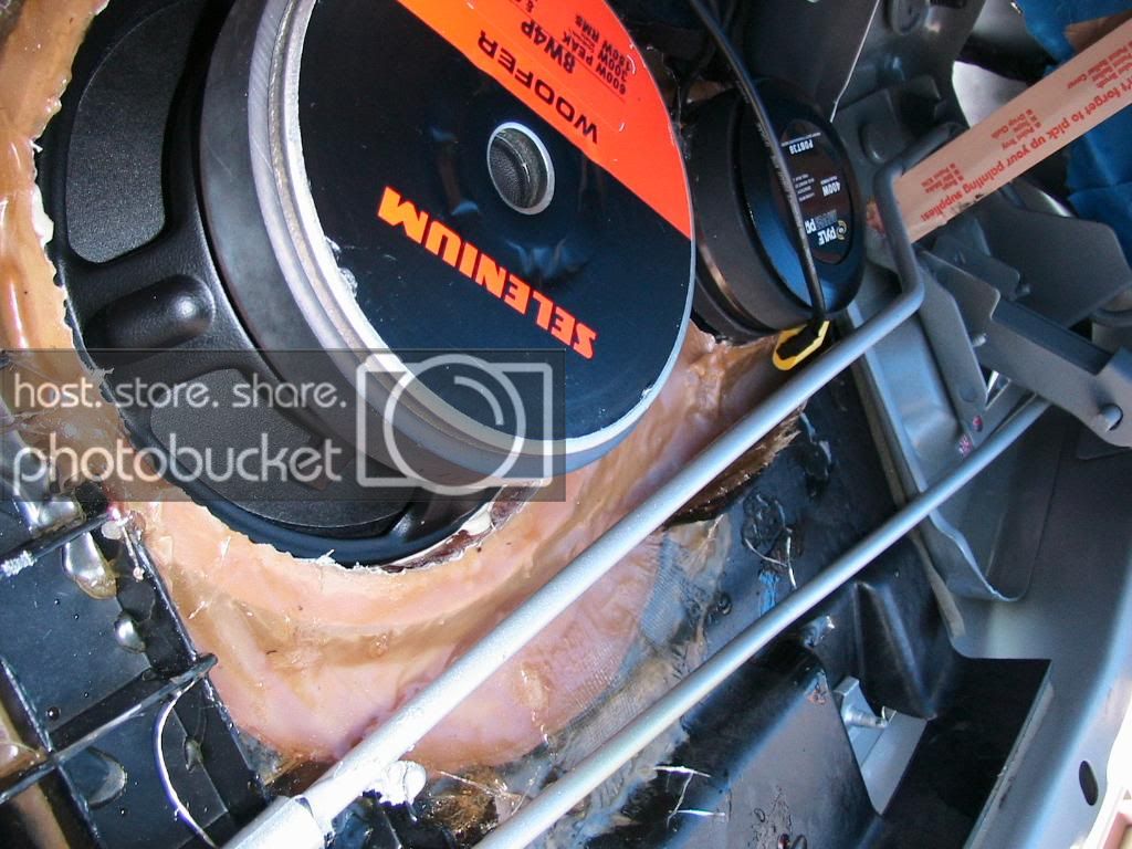

Lastly, some pics of why I mounted the tweets/woofs for the back deck in the positions I ended up with - you can see what I was dealing with. It was annoying.
