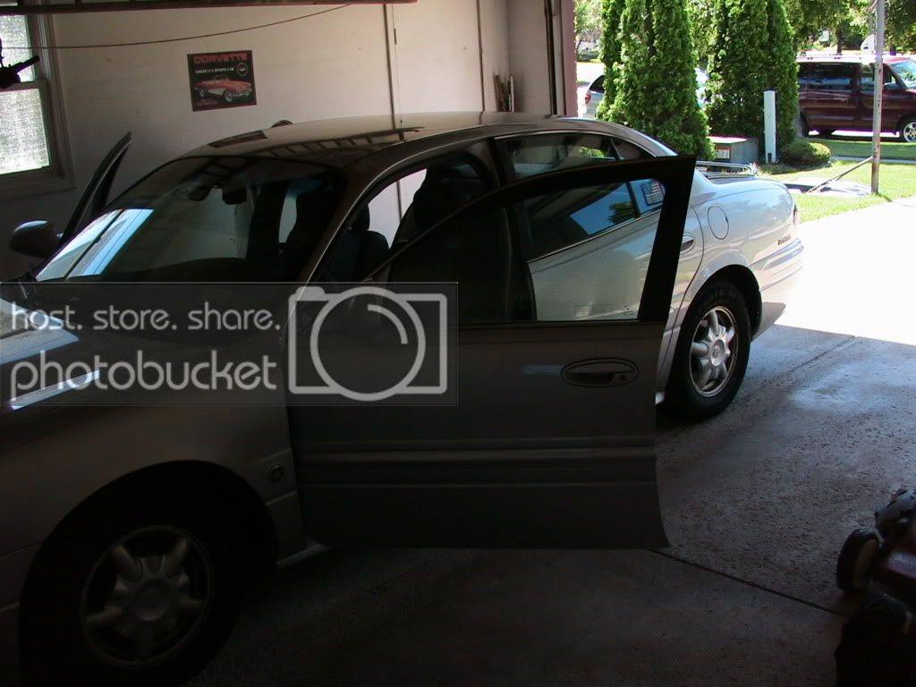

Alright, let's get some pics here. First, a pic of the car, in one piece, atm:

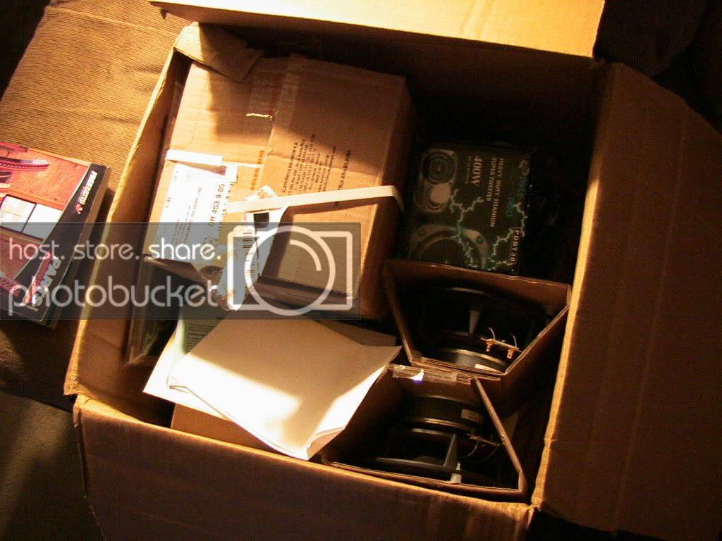

next, some of the equipment that's going in (my PE order lol)

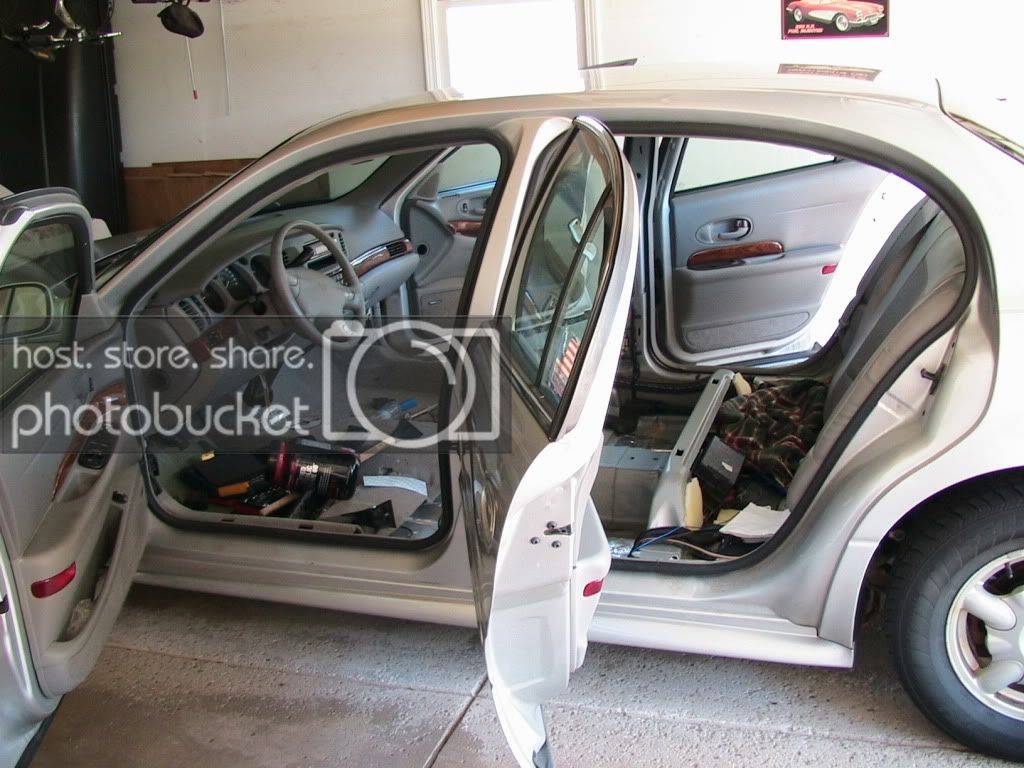

Obviously, the first step here will be to rip the entire car apart and start deadening. So, here we go:

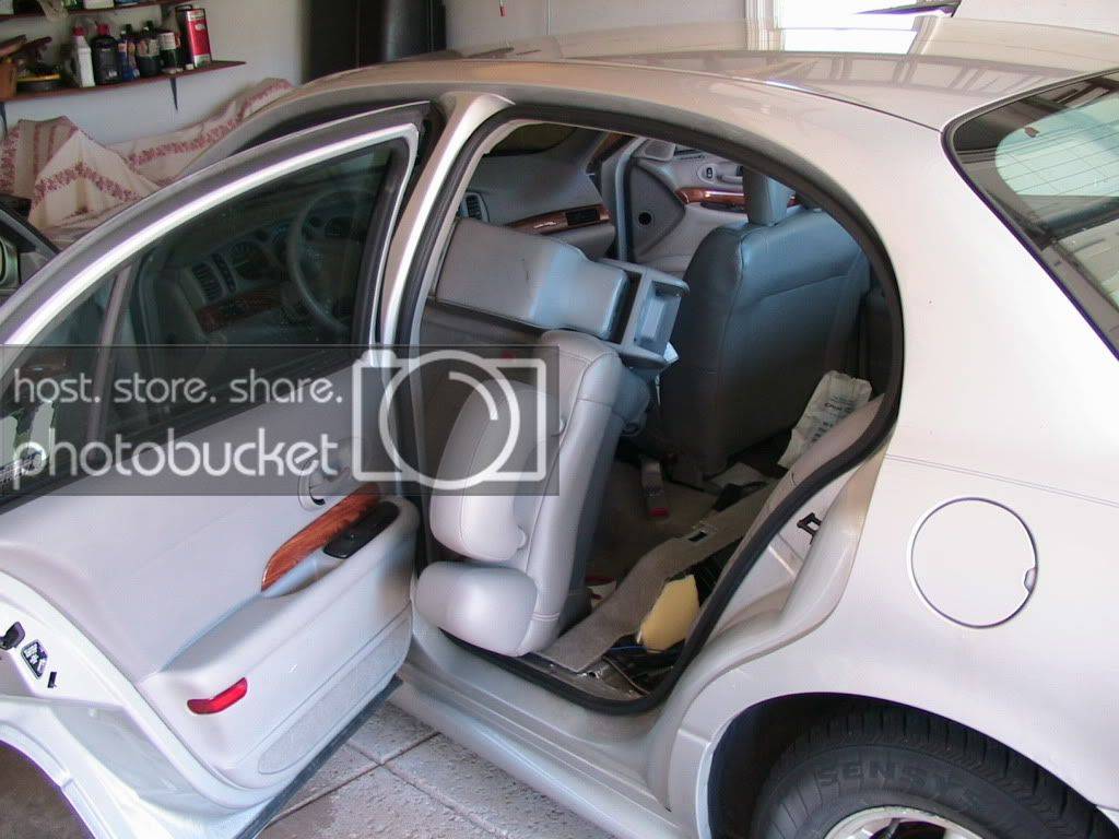

lol. Those seats were HEAVY. for real.
seats are out at this point, moving on
gotta love that part of the install where half of your car is sitting in the house....lol

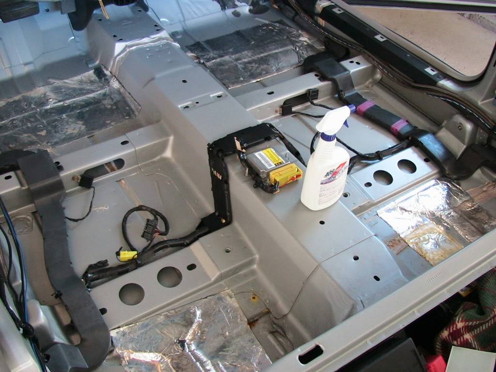

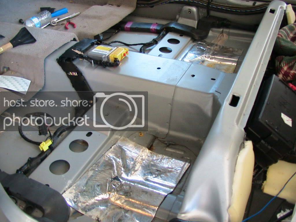

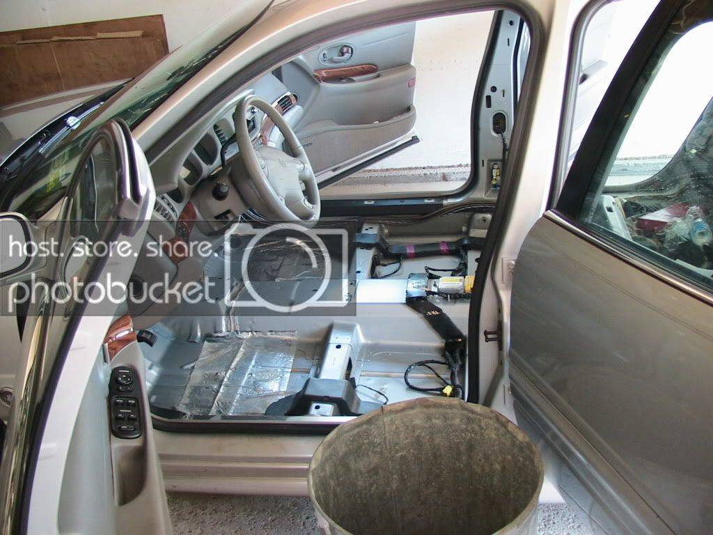

Believe it or not, the car had, stock, 4 cld-ish pieces in there already. Obviously they're not as good as the stuff i'm putting in, but hey, it's the though that counts here.

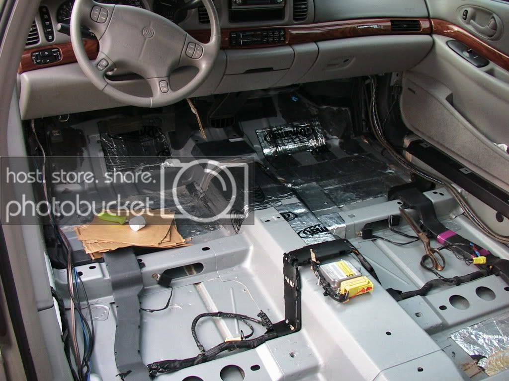

next, before applying the first deading layer (CLD, aka dynatmat, fatmat, whatever), clean that sucker up with residue-free de-greaser. I used 409 for this.
let me start the deadening portion off here by saying this - don't waste your time, JUST BUY YOUR FRIGGIN CRAP FROM DON @ SOUND DEADENER SHOWDOWN. Seriously. I made the mistake of not buying everything from Don and it was just a horrible waste of my time. As a result, i'm stuck here this weekend with 2 forced days off, missing the second layer of my deadening.
So anyways, back to the fun pics:

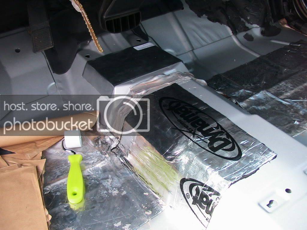

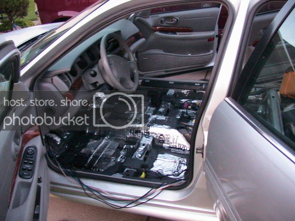

Don says that, with the CLD layer, you really only need 25% coverage. (Now, this may be different if what you're going for here is SPL - for that you probably should use several layers on dynamat on top of a thick base layer of Edead v3). However all i'm really concerned about here is a quieter ride, so i'll be doing less than 100% coverage.
This is probably enough for the front, but because i'm a paranoid nerd, i'll be doing more. I have 20 sq. ft. of dynamat extreme so why not cover more.

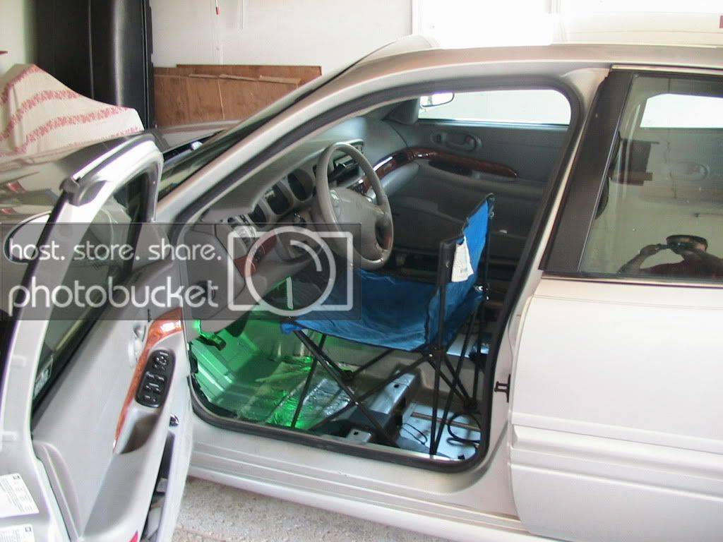

Ever try to move your car without the driver's seat?
makes for good times //content.invisioncic.com/y282845/emoticons/smile.gif.1ebc41e1811405b213edfc4622c41e27.gif

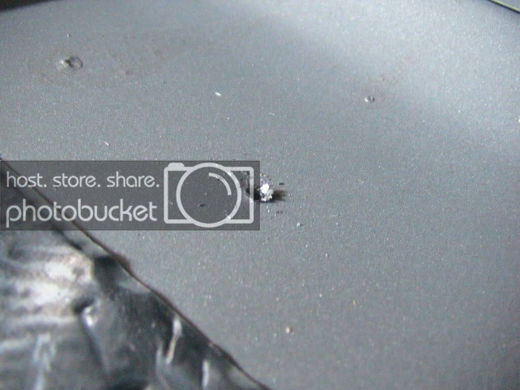

Before I started laying down CLD tiles, I first figured out where I wanted my zero-gauge wire to enter the cab. Due to extreme congestion everywhere in my car, I decided it was just gonna pop out in front of the passenger seat.

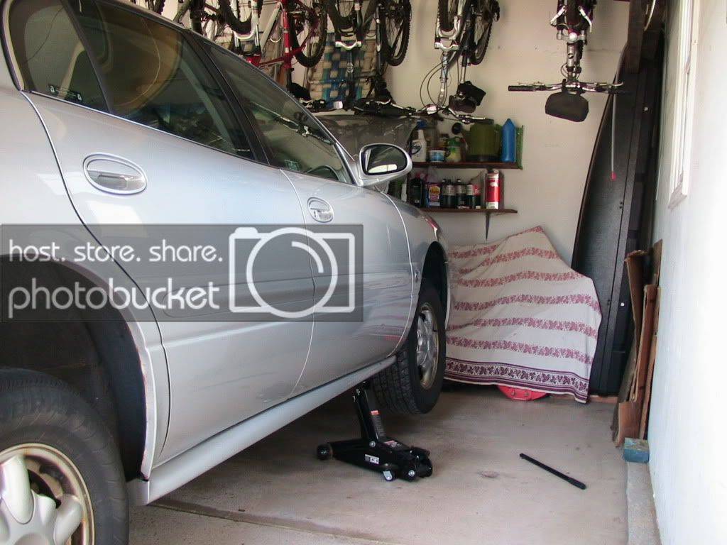

Jacked the car up, and drilled the hole from the underside such that the wire will come out right by the brake lines
For now it's just a pilot hole, but at least I know not to put CLD there. Also, the hole is small enough so that I can plug it up with JB weld if I want to use a different location for some reason or other.

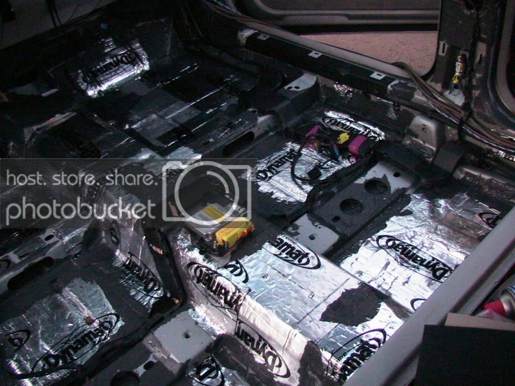

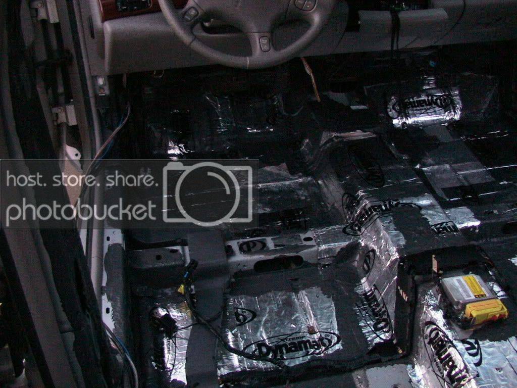

Alright, got some more deadening done today. Safe to say i've got the first lay of my deadening pretty well squared away:
the dark charcoal-looking stuff is eDead v3. My understanding is that it serves a similar purpose to dynamat/whatever other CLD tiles get your jollies off. However, I find it's much easier to work into tight corners or whatever so I use it in addition to CLD.
yes, I did much more than 25% coverage. Sorry Don, but I really, really don't ever want to rip my car this far apart again.

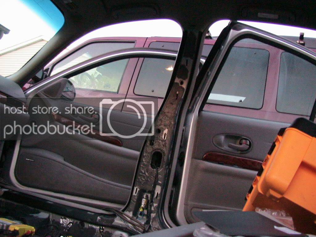

I coated the B-pillars with the v3 as best I could. I'm obsessed. My neighbor came over and told me I was nuts. Pretty much made my day.
