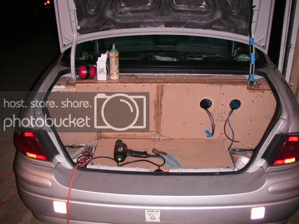

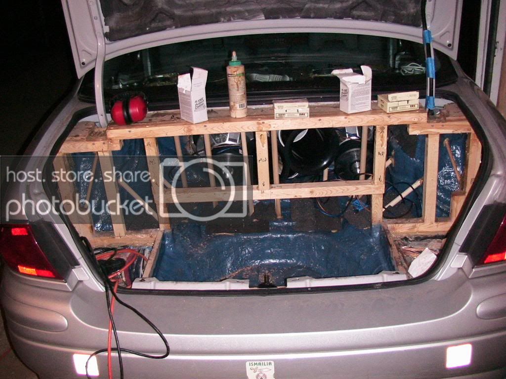

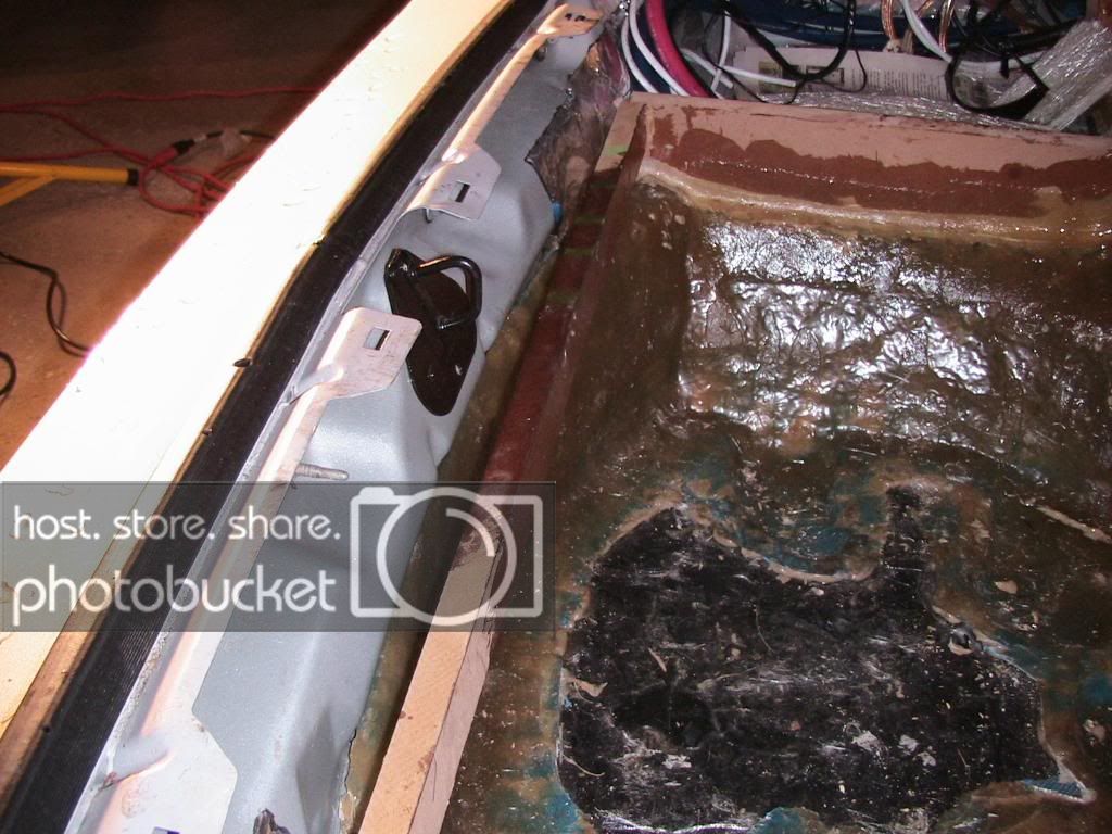

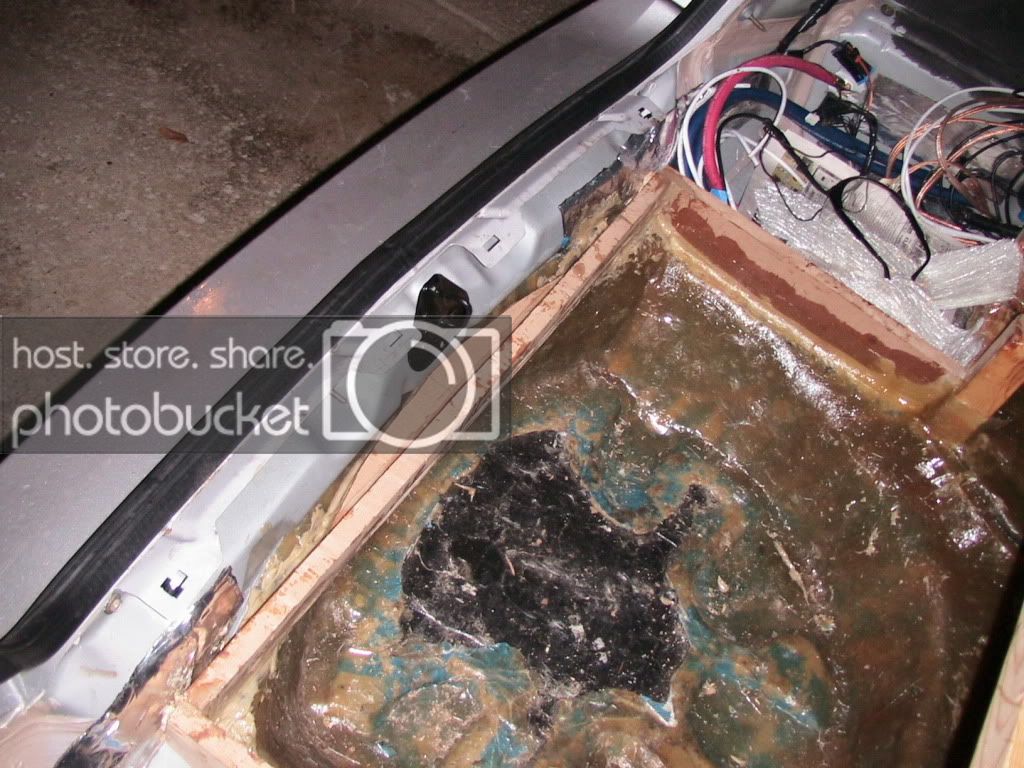

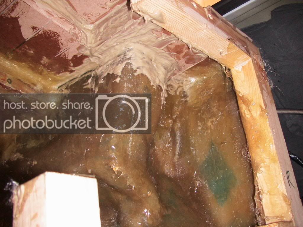

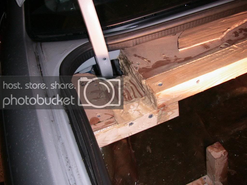

lil more progress, i ALMOST have a box (minus the back and spare tire well cover) - ie, it's almost sealed up. Did this today:
i know it's messy and all that but it's sealed up for sure //content.invisioncic.com/y282845/emoticons/smile.gif.1ebc41e1811405b213edfc4622c41e27.gif

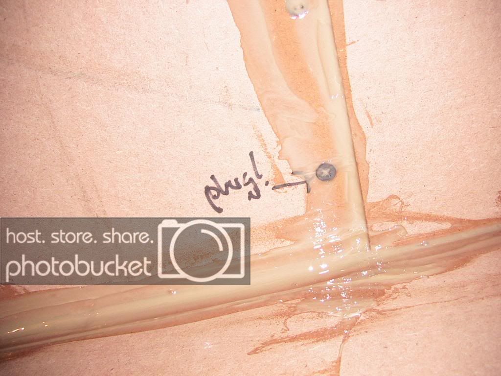

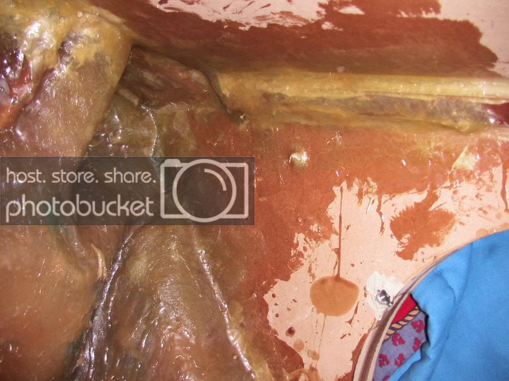

this is the last part i need to seal, was hoping to do it with just glass but the gap is way too big so i'm gonna cut up a piece of mdf for it and PL the crap out of it like everywhere else

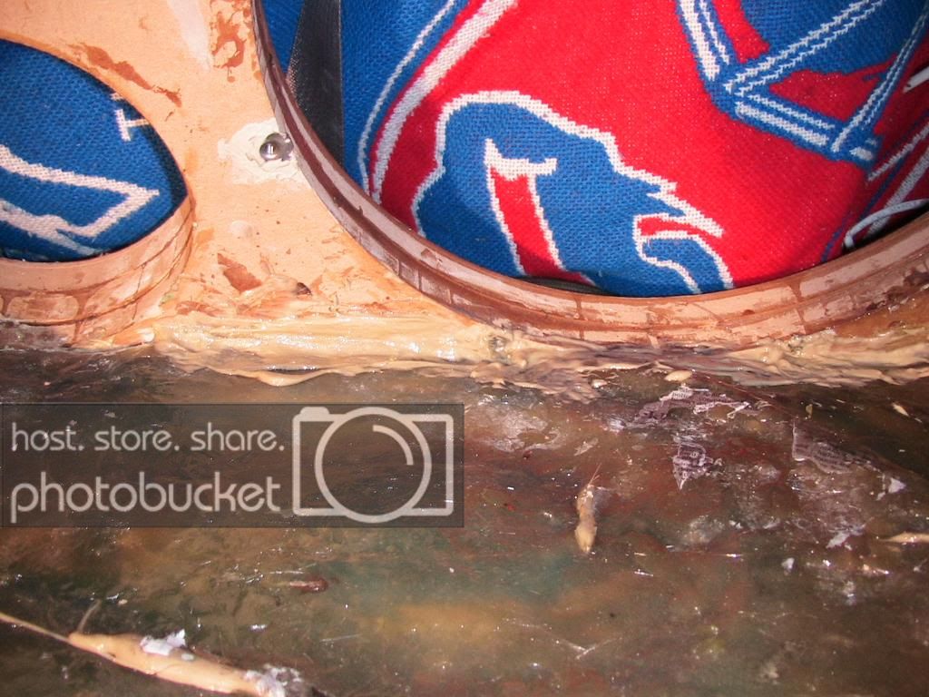

sealing the bottom to the wall with PL - some of this will be glassed over but not until I make the ports fit
this is one of the top corners, some glass here and some wood.

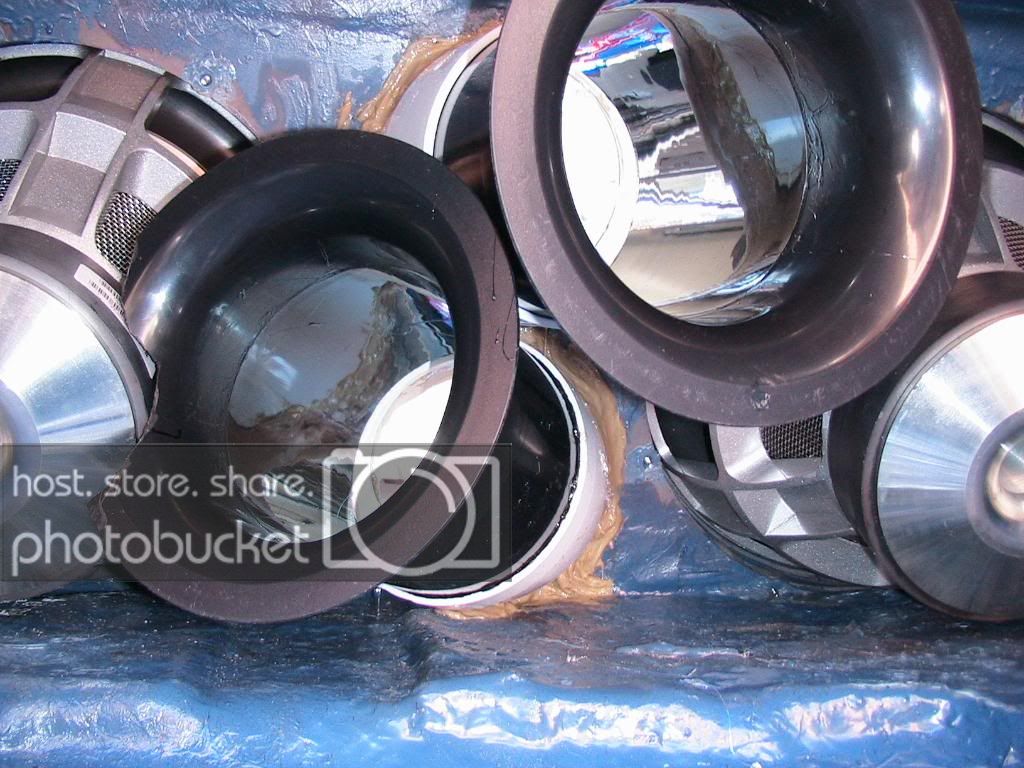

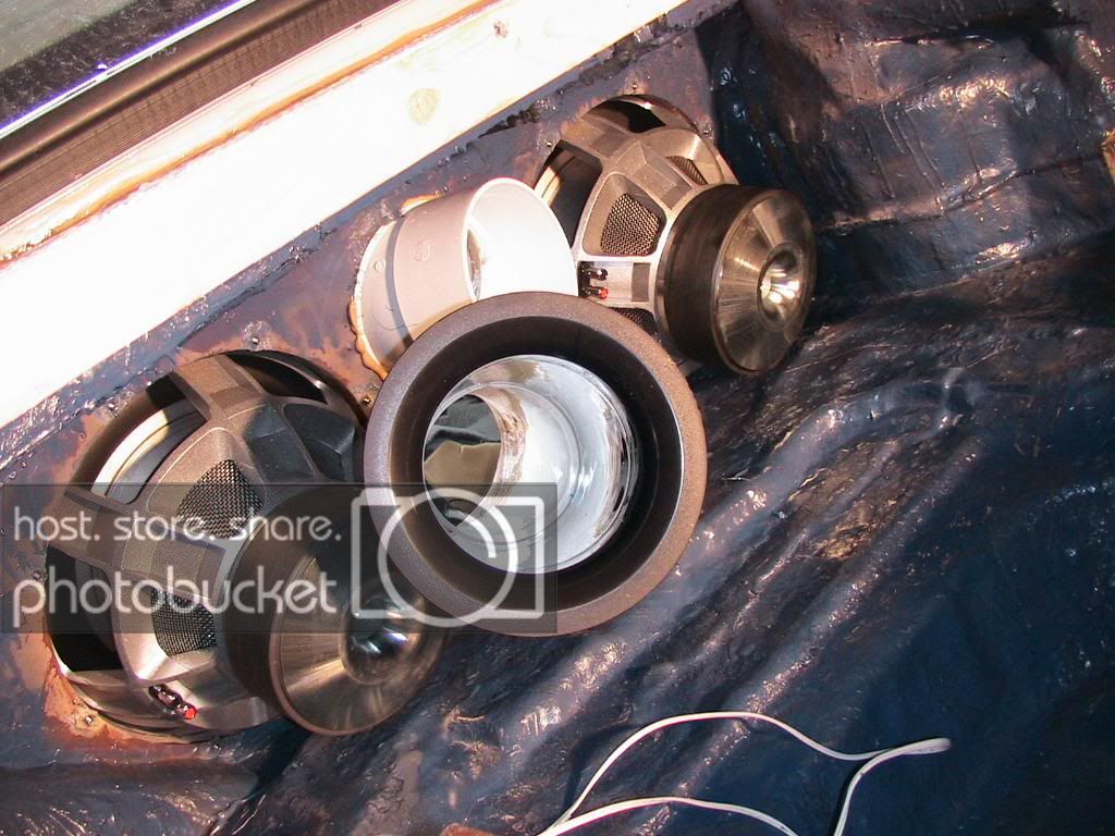

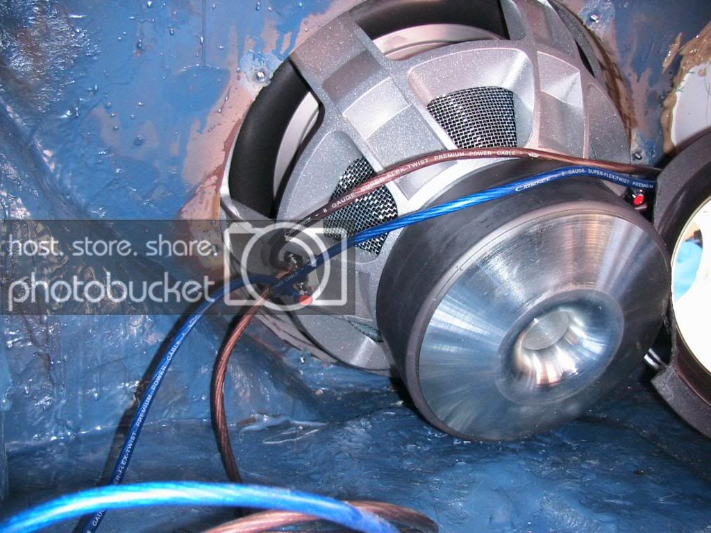

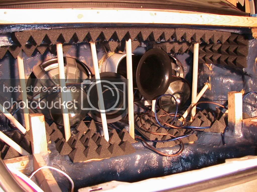

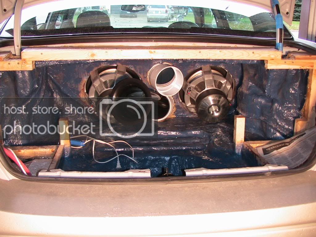

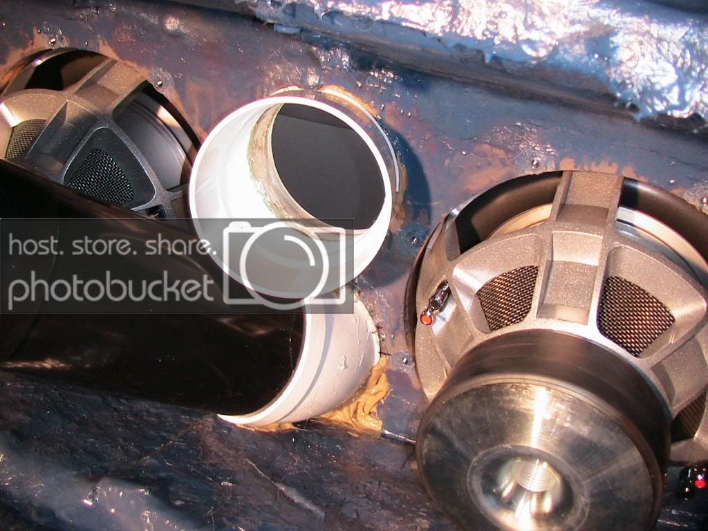

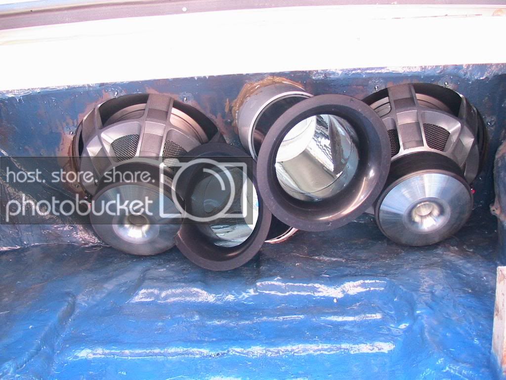

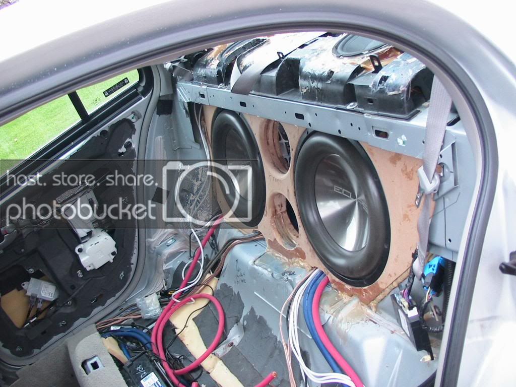

//content.invisioncic.com/y282845/emoticons/smile.gif.1ebc41e1811405b213edfc4622c41e27.gif :) //content.invisioncic.com/y282845/emoticons/smile.gif.1ebc41e1811405b213edfc4622c41e27.gif :) //content.invisioncic.com/y282845/emoticons/smile.gif.1ebc41e1811405b213edfc4622c41e27.gif :) //content.invisioncic.com/y282845/emoticons/smile.gif.1ebc41e1811405b213edfc4622c41e27.gif good progress!! W00t. In reality, i had to mount the drivers before I attached the ports, because I needed to reach through the top port hole in order to mount the drivers.
i don't even wanna talk about how difficult it was to squeeze these ports in, lol. As it stands i'm probably going to need to remove a portion of the roundover from the bottom port, because it interferes with the motor on that driver. What i ended up doing to get these in is using a 45 degree bend for the bottom port and a 22.5 degree bend for the top.

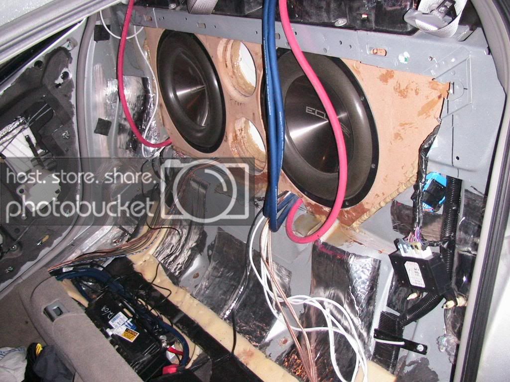

the next step will be figuring out all the electrical nonsense:
also, i started deadening the area back there. Seems to me that a lot of noise comes through there so hopefully i do a good enough job with this.

those bends made the whole port system work, i had to modify some stuff back there to make everything fit but it wouldn't have happened without those. They were actually pretty cheap too, and the sewer and drain spec elbows actually fit the port piping, so it's all good.

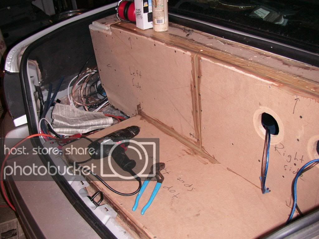

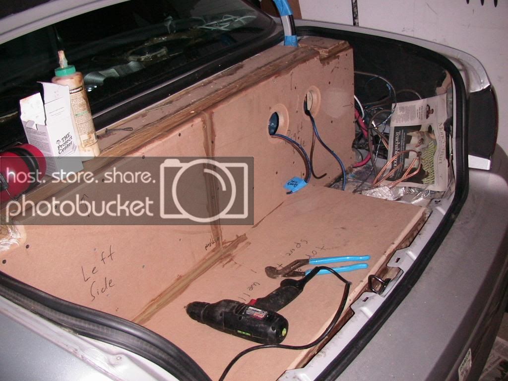

alrighty, on to a better update.

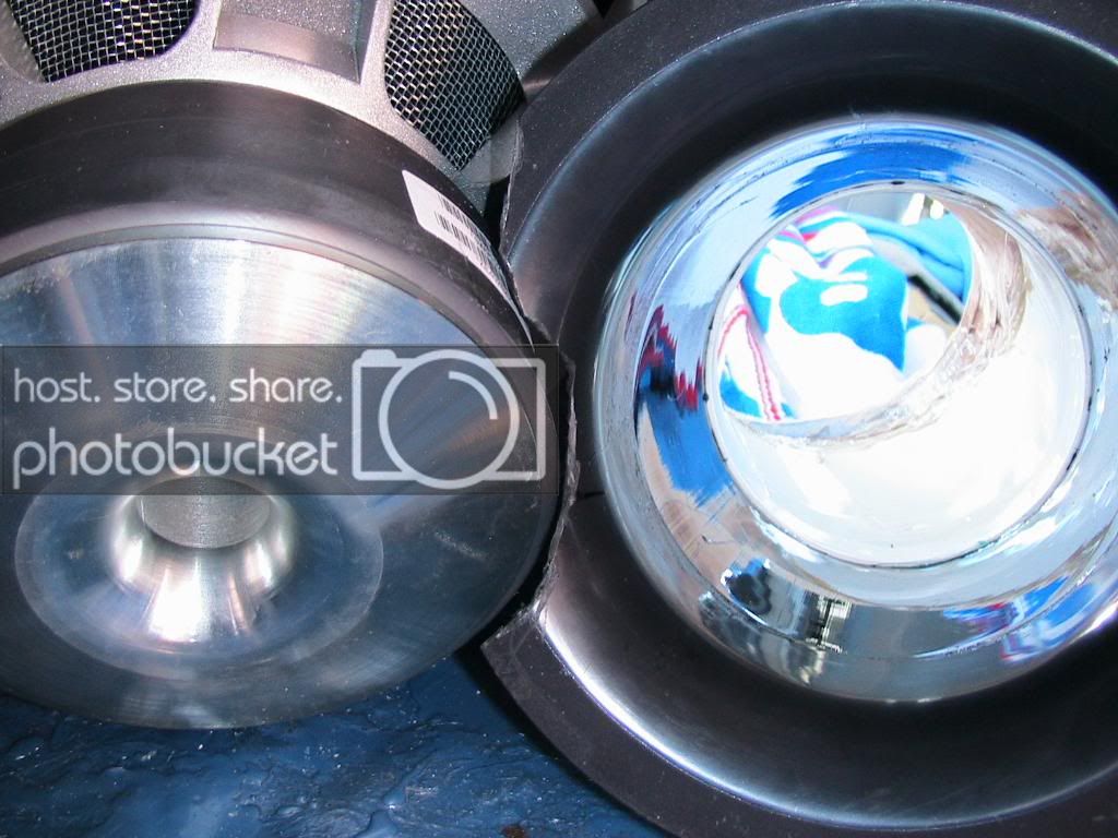

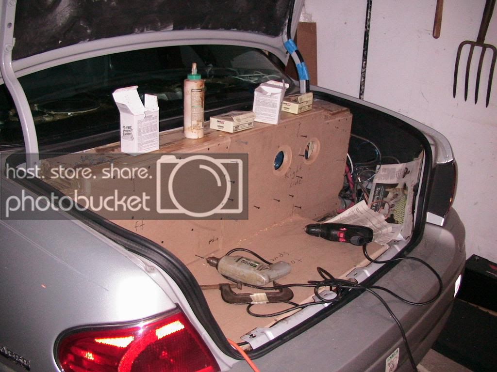

first thing i did was make the ports fit, ala this:
sadly, as you can see, a little bit of the round-over on the bottom port had to go. The approximate length of both ports is 13.5", because that's what the psp calculator told me for 2 6" ports, 10 cubes, and 30 Hz.

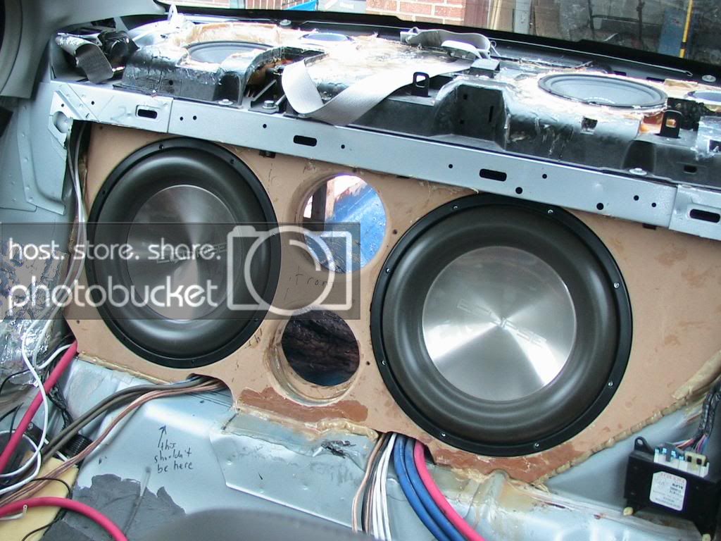

next, wired up the drivers. I've got some 8 gauge cadence wire that I used for this.

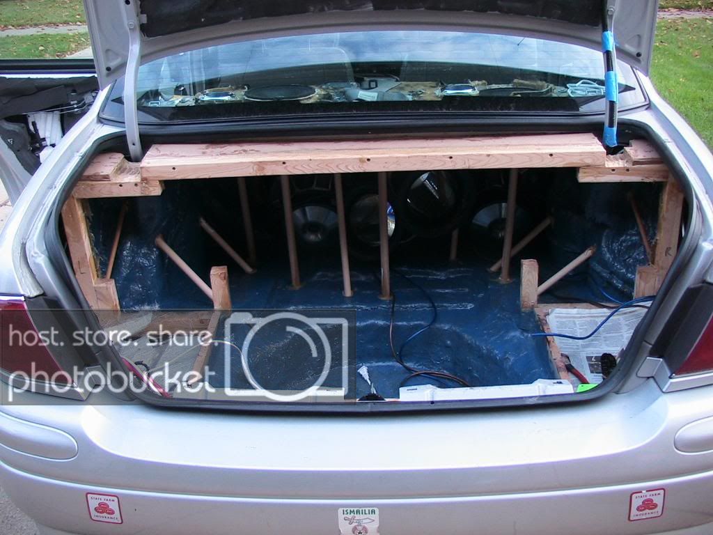

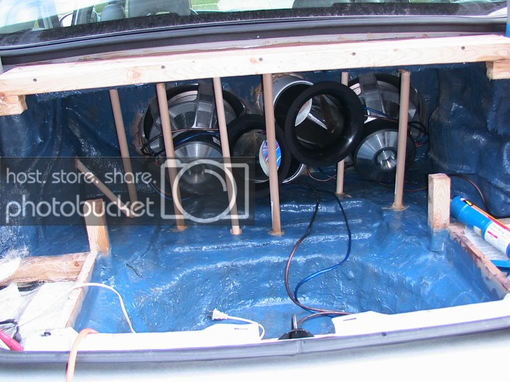

then , on to bracing. The top and the bottom are the flimsiest, or so I would assume, so i tried to brace them as much as i could without going too overboard:
added some eggcrate foam:

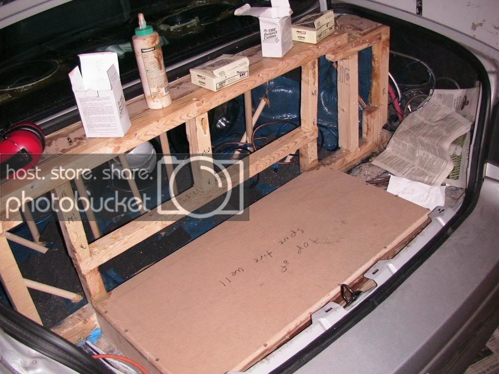

built up the frame in the back:
dry fitted all the back pieces (screwed them in but didn't glue yet):
removed, and worked from the bottom up:
and....i have a box now!! W00t!
