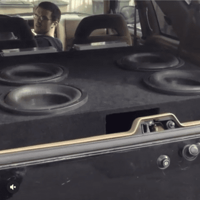

I might catch flack for this, but I like Q power deluxes. They are damn good subs for what they are. IIRC, one of JL's engineers designed the Q power deluxe, but don't quote me on that. We did high 140's with 4 of their 15's in a jeep cherokee back in the day, on like 1500w or so. They'll take 400-500 watts and run in a 4th order, if you want something cheaper.
We did 4 q power 12's on like 2000w or something, and he was in the 140's for sure. Probably low 140's. I assume they're still the same design today.
This is the 4 12's:
25771

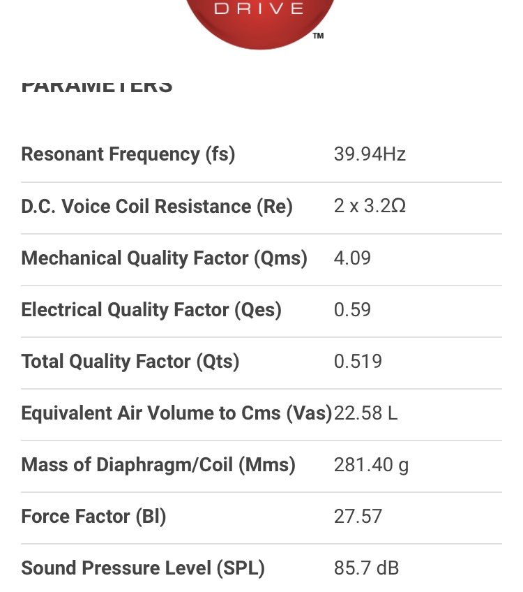

I see somewhere than for a 4th the sub may have a factor of fs/qts below 46 is that true ? The DB WDX G5 have a factor of 76.9 so better in a 6th 🤷‍♂️?

What you're looking for is EBP, which is Fs/Qes. But that isn't always 100% true, it really depends on Fs, Vas, and how big of a sealed box the woofer can use with full power, and the Fc of the sealed box.
Holy crap, you can put those in a HUGE sealed box and ported box, according to their recommendations. Yeah, seems like it would work in a 4th to me. EBP of 64.34, Fc would be good for 4th order.

You could do ported, 4th or series 6th order. That sub is going to have a huge box no matter what you do. I can design it any way, as long as you have enough space.
