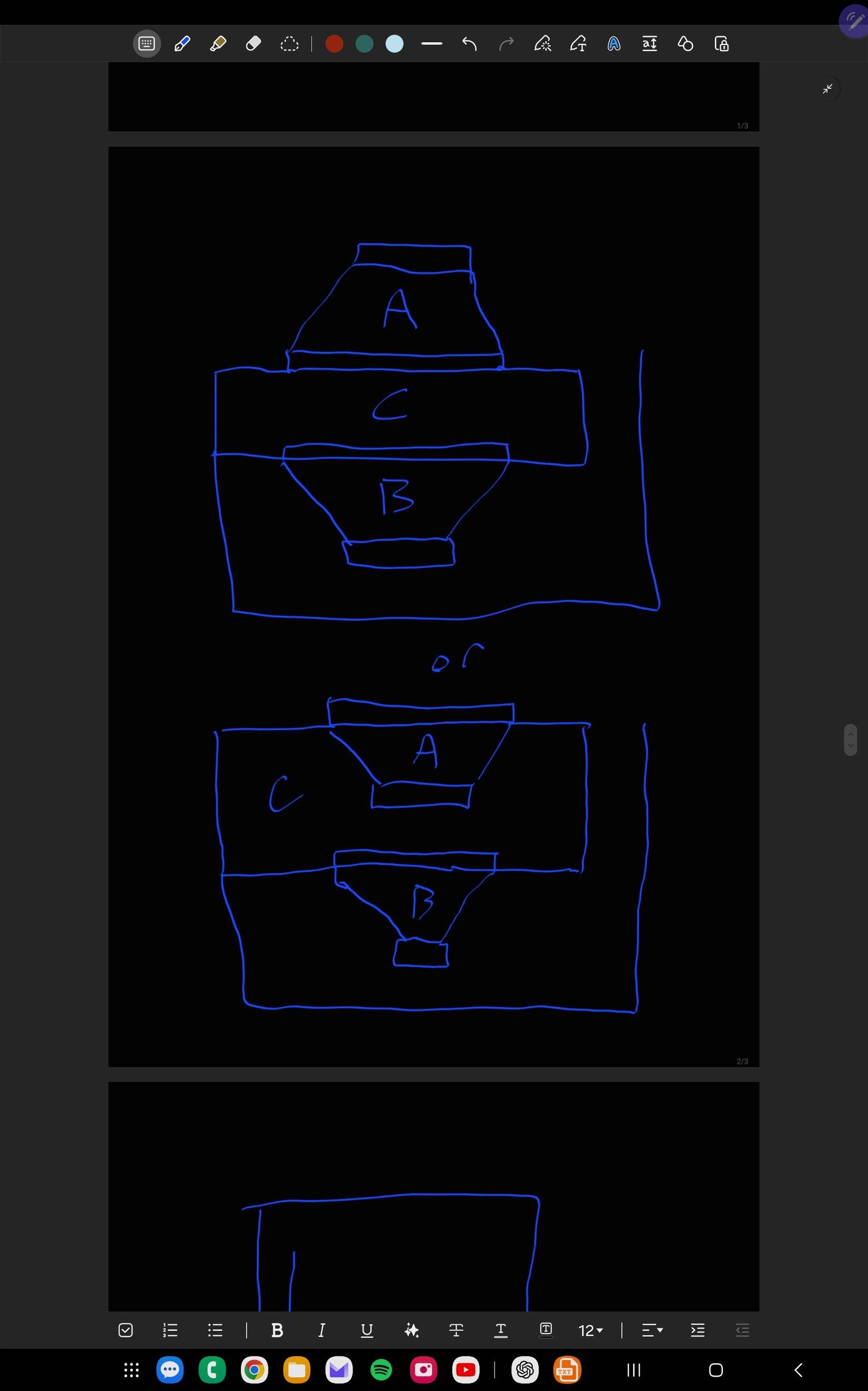

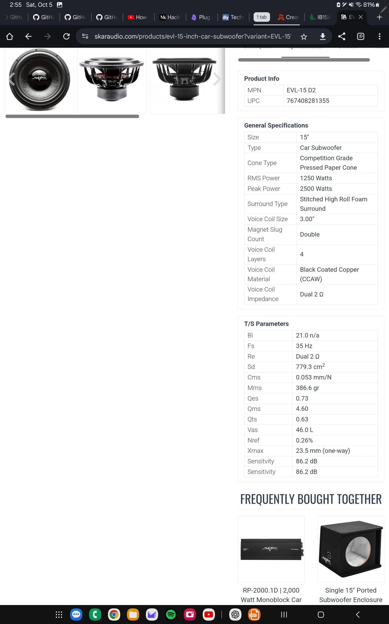

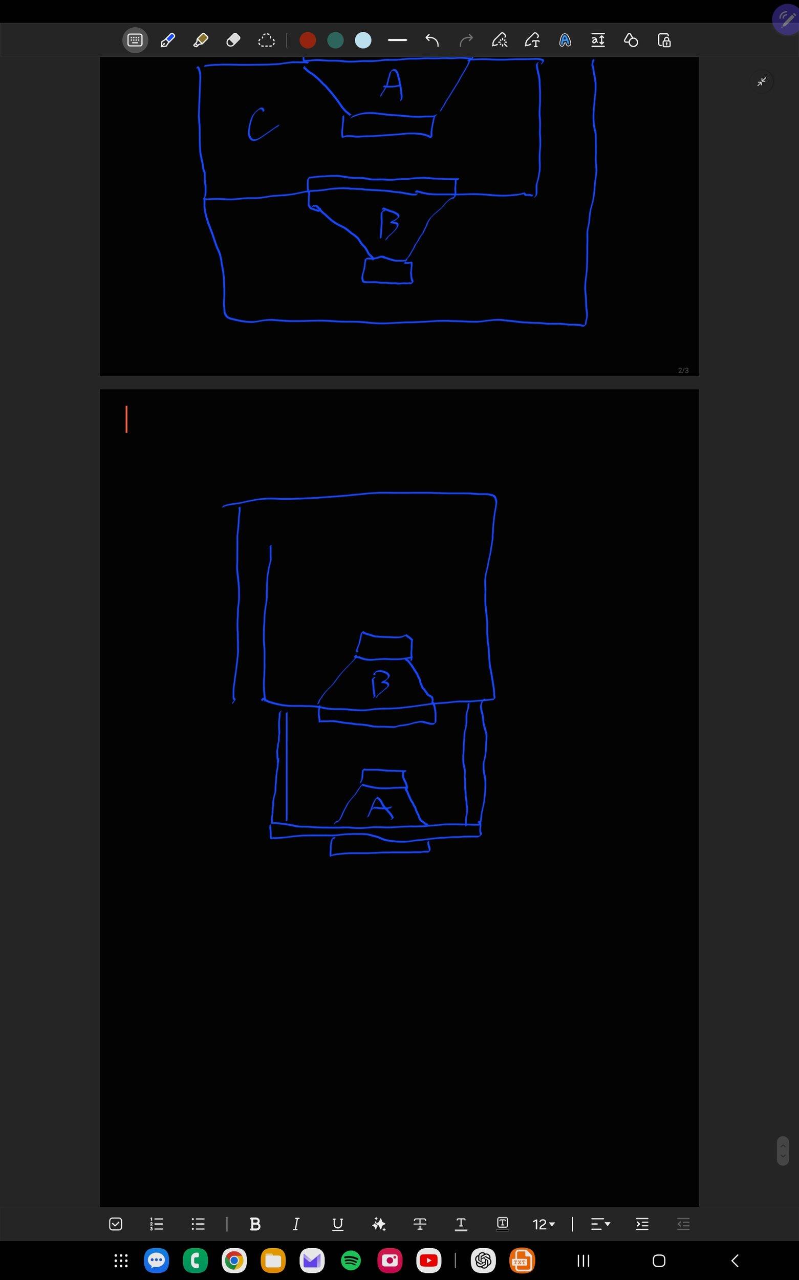

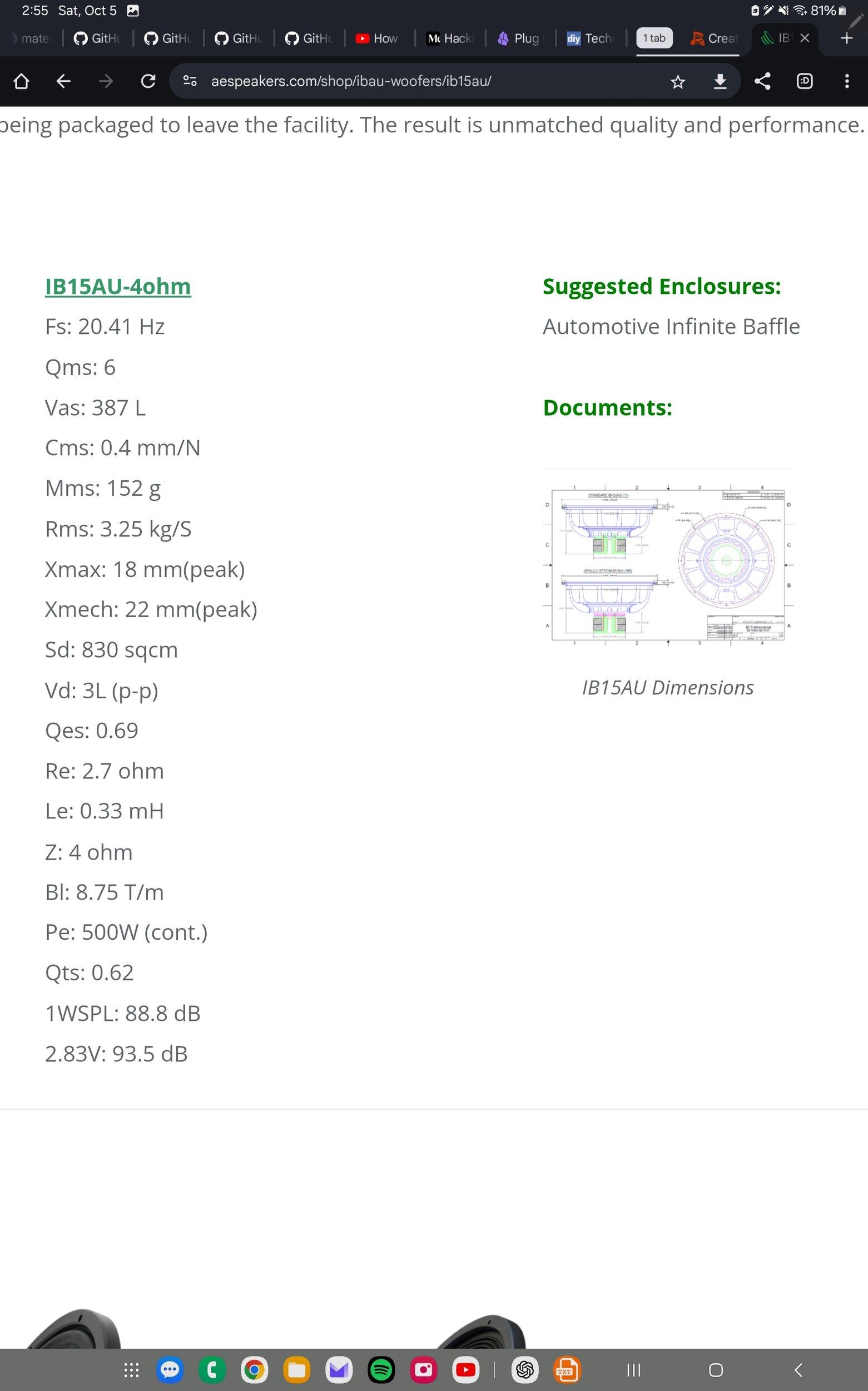

I would like use both my subs in a single application. I have never built a bandpas or isobaric box beforeso i need a little help.Sub A is theIB15AU by acoustic elegance. TS parameters attached. Sub B is the skar evl 15 TS PARAMETERS attached. I want some help thinking my way through how to properly design this enclosure. I figure this set up will allow Sub A to act as though its in an IB environment and sub A as though its ported allowing both to play to there strength. I plan to wire them to the same amp treating the phases appropriately so they push pull minimizing change in pressure in the sealed cavity C. This would give around 900 w rms to the 2 ohm load so it should be safe for both subs. What i don't know is how to size my pbox and port correctly for this set up. Anly help is wellcome
