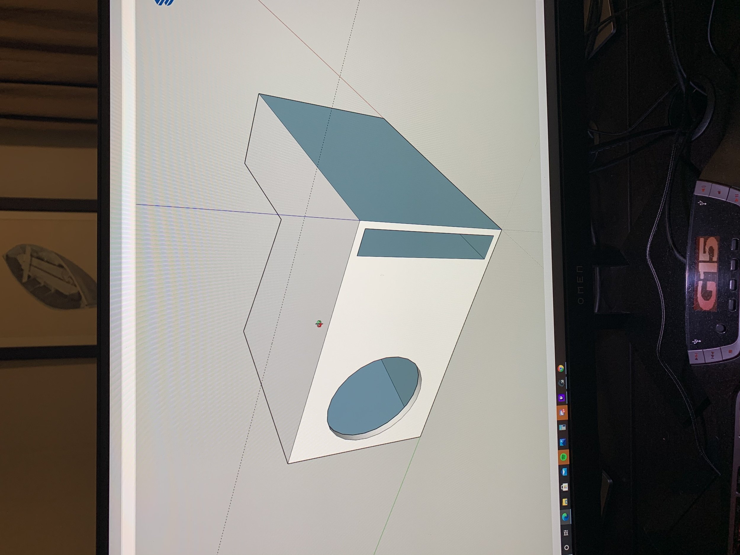

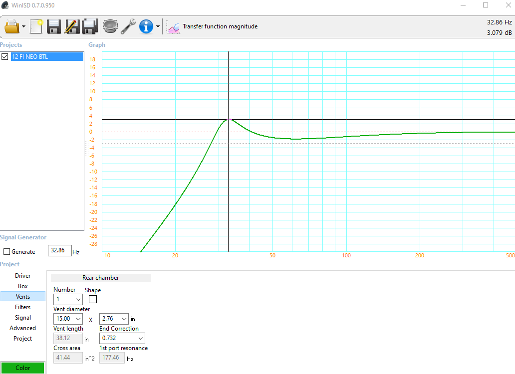

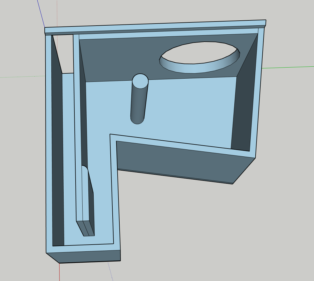

Hello all, any thoughts on this enclosure? It ‘s going to sit on the back seat of a 2011 Toyota Tundra in the center. The box is tuned 2.5ft3 at 32 hz after port, sub, and bracing displacement. Plan on running a Fi neo btl at 2500w. My concern would be the odd shape of the box and port. The port ends before it opens up into the sub chamber so I’m wondering if it would throw off the tuning. Any opinions would be appreciated.
