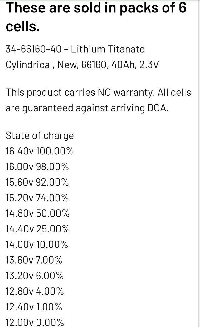

Technically at 14.4v he only has 25% capacity and 14.8v would be 50%, 15.6v is 92%
His bank is huge at 240ah so even 25% of that is 60ah×10c= 600amp
600amp×14.4v=8640w
320amp alt×14.4=4608
He has 13248w capacity before dropping .1v and that's on a sinewave music is transient.
.1v increase is alot on a lithium cell. The yinglong cell would go from 25% soc to 31.35% just buy going up to 14.5
240ah × 31.25%=75sh
75ah× 10c=750amp
750amp×14.5=10875
320amp alt× 14.5=4640
15515w before dropping .1v
A 2267w increase over a .1v increase

Except that 5s is 100% charged at 13.6v and will be damaged above 14v
Idk how the chart for a 6s pack does you any good to support your 5s claim
I'm not sure what 5s claim you are talking about?
Your chart is actually quite helpful. I was aware that lithium has a mostly flat discharge curve but I wasn't aware of how such a little voltage increase adds such a large percentage of capacity.
600amp×14.4v=8640w
240ah × 31.25%=75sh
75ah× 10c=750amp
750amp×14.5=10875

He was saying 5s was good for most people. It isn't not at all. Unless the vehicle charges exclusively below 14v 5s lto will fail.
The chart is fine.
Each cell can actually hold 2.9v. You will be good up to 14.5. Are you running a 5s bank? Have you ever ran one? I'm running one 40ah 5s bank of XS Power in my truck.

It was my chart. No worries.
Unless you are running a high voltage system, which most people aren't, there is no reason to run a 6s. You can believe whatever you want. I've seen a boat load of 5s that did perfectly fine up to 14.4v - 14.6v.
