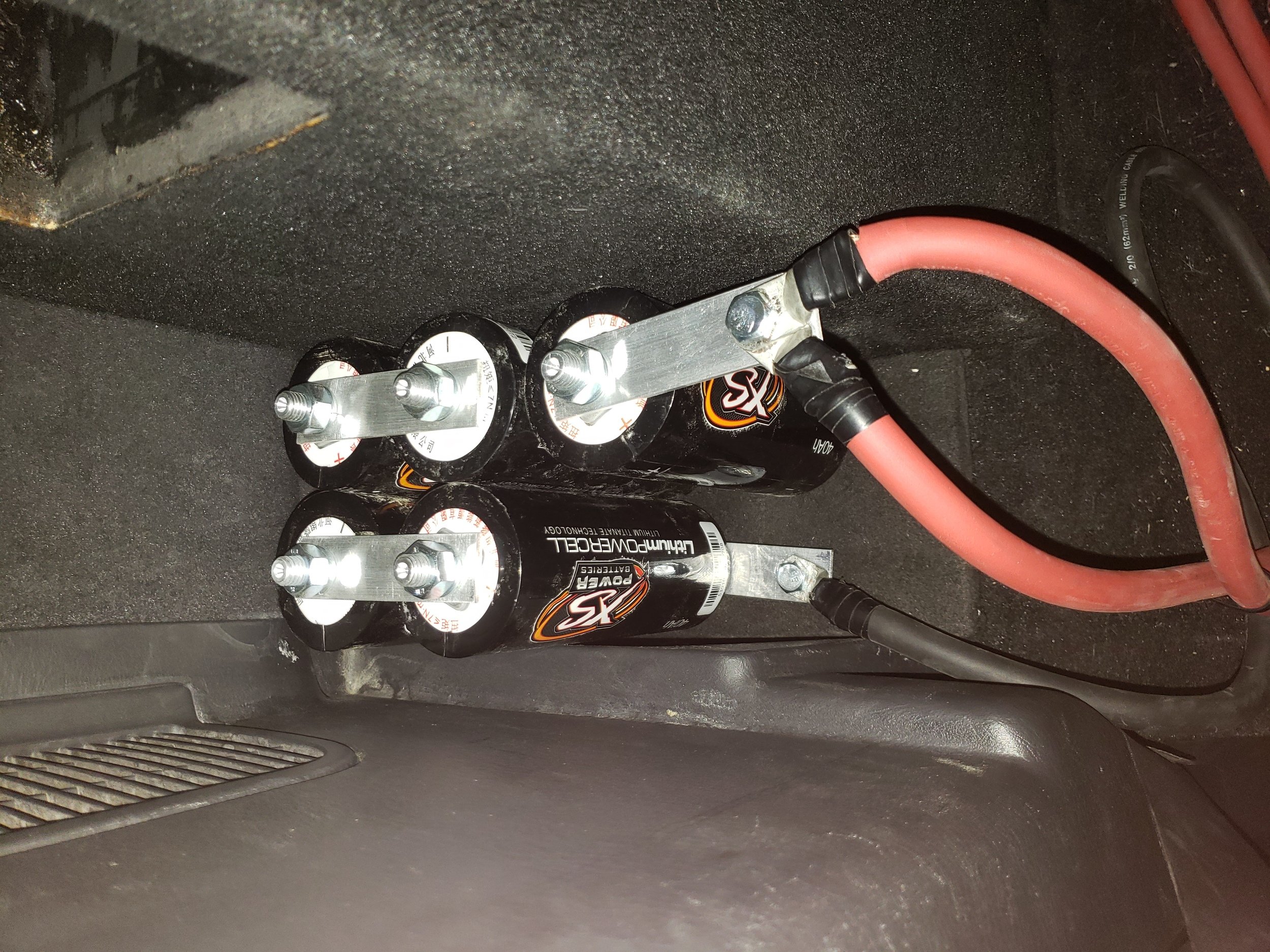

Each cell can actually hold 2.9v. You will be good up to 14.5. Are you running a 5s bank? Have you ever ran one? I'm running one 40ah 5s bank of XS Power in my truck.

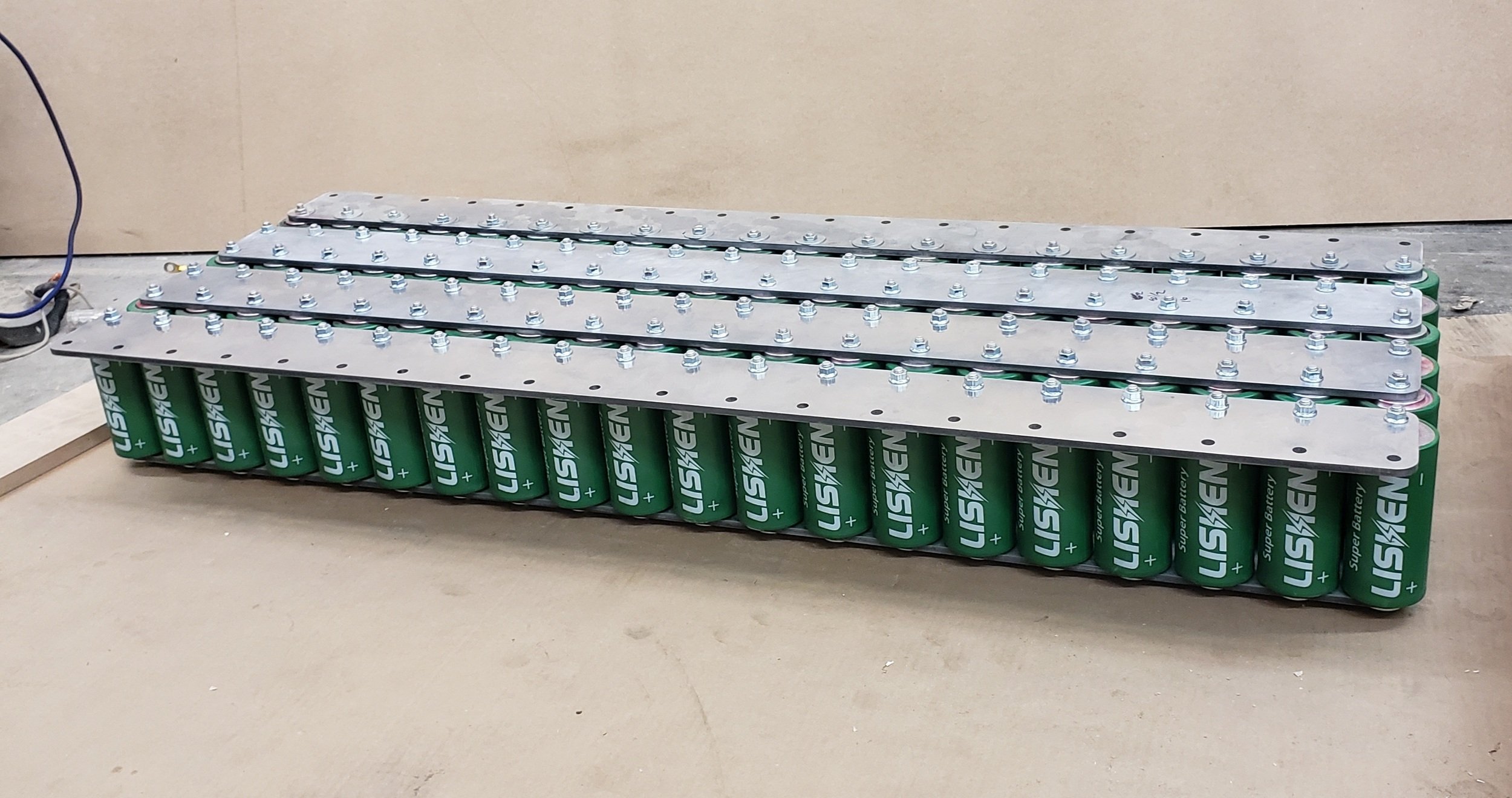

I was running an 18 ah of lishen before. This is my buddy's lishen setup. 120 cells.
Your point? Thats a nice 6s setup of lishen lto.

Nope. The info that I was given was the max voltage per cell is 2.9v. 5 times that is 14.5v. My truck is never charging higher than that. I might add a sixth cell just to have a little more reserve. My voltage is all over the place. It will range from high 11's to 14's while playing music. IDK why. I've done everything besides getting an external voltage regulator.
