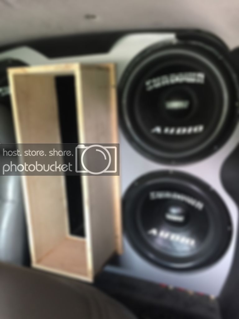

Port exstension like this^

Box dimensions (outer) are-
Width- 39.5 inch
Height- 18.75
Depth- 45.
Port
Width- 35.75
Height- 5
Length- 23

Just want to now see if i add on an external port piece, what my dimmensions should be to be able to smash the lows.

So all tips on what i should try with extending the port.
And if that dont work then im just going to have to either make a wall or a 6th order. (Is 6th good idea for 2x18s?)
