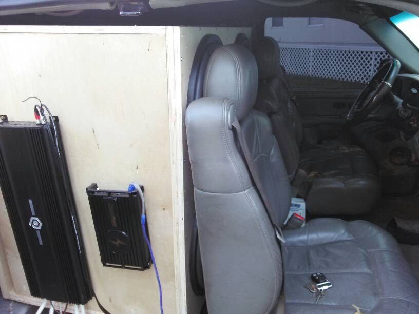

Thats what I thought but pics make it look thin lol But that might have been good too still would have been 1 inch thick ? I should have done that. I didnt have enought space for doubled up 3/4.
On small boxes i usually only do double baffle on sub side.
imagine 1.5in all around, its frikken huge. I was scared because if i wreck it will fly if not mounted good enough //content.invisioncic.com/y282845/emoticons/biggrin.gif.d71a5d36fcbab170f2364c9f2e3946cb.gif.
In your 96 ext cab it would have been fine doing the same.
Thats the reason I didnt wall mine, tough to secure safely ! I built a base out of 2x6 bolted through the floor with 1/2 bolts and big washers and box bolts to platform so its pretty solid.

I succ at wood work so i made lots of ugly cuts and uneven cuts. I have to fix wayyyyyyy too many issues hahah..Anyway if i see the bondo is not holding i will go fiber glass which i did not want to do.
This was my first wall so i plan to tear it down in the near future to make an even better one. Once extra bondo is done and subs are mounted and wired i will make a video of it in action.
I may even record how i crawl in the box thru the sub hole //content.invisioncic.com/y282845/emoticons/biggrin.gif.d71a5d36fcbab170f2364c9f2e3946cb.gif

Question ? Why do you guy build these in the truck ? Seem it would be much easier on the bench ? or will it not fit through the doorway ? Looks like it would, But I am old and hate crawling around in the truck. As far as wood work I am pretty good and if you lived near me I would have fixed you up with getting it all pre fabed up. I would like to build a wall- not for my truck but for someone else. I think it would be fun.
I know mine wouldn't fit through the door if I didn't build inside. Also, it would be awful to build your box and then you were off by an inch and it wouldn't fit

I'm also worried about wrecking. I'm double or triple layered 3/4 all the way around //content.invisioncic.com/y282845/emoticons/crap.gif.7f4dd41e3e9b23fbd170a1ee6f65cecc.gif
I just had to do it and it made a **** storm for me //content.invisioncic.com/y282845/emoticons/frown.gif.a3531fa0534503350665a1e957861287.gif
I went ahead and tested without bracing the top single baffle.. After a few songs i tried la roux decaf version and all i heard was a large kabooooom!!
Top bracing in the back blew apart so i have to fix that now which i may just do a 45 to cover the crease.

Your seat is soooo close to the steering wheel lol. You need wayyyyy more power I was waiting for the bass to hit and it never did.
Haha amp isnt even half gain.. I havent tried going full since my wall was... Made imperfect....
Port wall joint busted from the pressure unloading and my smart idea of doing a single baffle roof for the wall.
Also the roof and floor is deadened to hell.. No flex homie //content.invisioncic.com/y282845/emoticons/biggrin.gif.d71a5d36fcbab170f2364c9f2e3946cb.gif

This is my first wall so it wasnt easy for me.
x2
If you ever get them moving thats seats going forward again lol but you couldnt drive with it up that loud so i it could be that far back when cruising.
x2
Yeah thats why previously i put grandma driving //content.invisioncic.com/y282845/emoticons/biggrin.gif.d71a5d36fcbab170f2364c9f2e3946cb.gif.
But i still have room to drive, but uncomfortable.
Ima leave it as is till im ready to rebuild.
I didnt fully check my measurements top to bottom so the front baffle made it close.
But its running and bumping..
Im just cleaning it all up now.

Wow thats crazy ! Seats could no way work for me ! But if it works for you its all good ?
