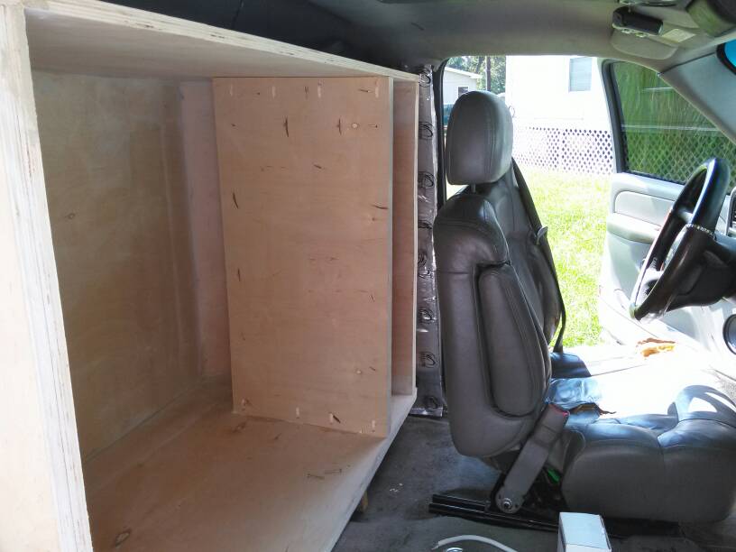

Added some back wall support //content.invisioncic.com/y282845/emoticons/smile.gif.1ebc41e1811405b213edfc4622c41e27.gif
I will wait to deaden fully to see if i need more layers to even out the back.

Those are cute little batterys what are they for? backup for alarm ? JK looks good so far. How many cubes is it going to be ?
[emoji14] i almost blew them up by arcing them..
Im aiming for 25-28cuft net.
Will be 4 18's so its gonna be tough.

Those trucks have a little more room in the back than mine. Plus I got only one audio rule, seats gotta stay all the way back! If I wasnt long legged I would be able to build a little deeper box than I did but I should have around 14 cubes after displacement for two 18s and its about 3/4 the height of yours but only 21 inches deep.
Im using 3/4 birch double baffle all around. So space gets used adding so many baffles.
My port wall will be triple baffle for bracing.

Ya I was going to go double all the way around but lost to much space so single 3/4 it is but its got lots of pipe bracing and double top baffle, wanted to do tripple top baffle like my last box but its already getting to tall now and my poor roof is probably going to blow off as it is lol!
Could have gained space by making it wider... probably adding your amps on the side?
I gained space by removing the panel by driver side and yes i am gonna mount my amps on the open side as i do not want to put anything in the bed.

Im so close to getting the subs in..
Gotta fix my errors i made leaving open spaces due to bad cuts.
Gonna bondo everything then start on port wall then face baffle.
Once all is done im gonna mount the subs and amps and meter test.

Looks a little rickety ? LOL JK looks like it will be a solid box with all that doubled up 3/4 ! I worked on mine today too, new headliner and finished the back wall reinforcement. Little by little I inch forward
Grandma front seat driving coming soon //content.invisioncic.com/y282845/emoticons/biggrin.gif.d71a5d36fcbab170f2364c9f2e3946cb.gif
Just noticed space on bottom is good but top is tight
