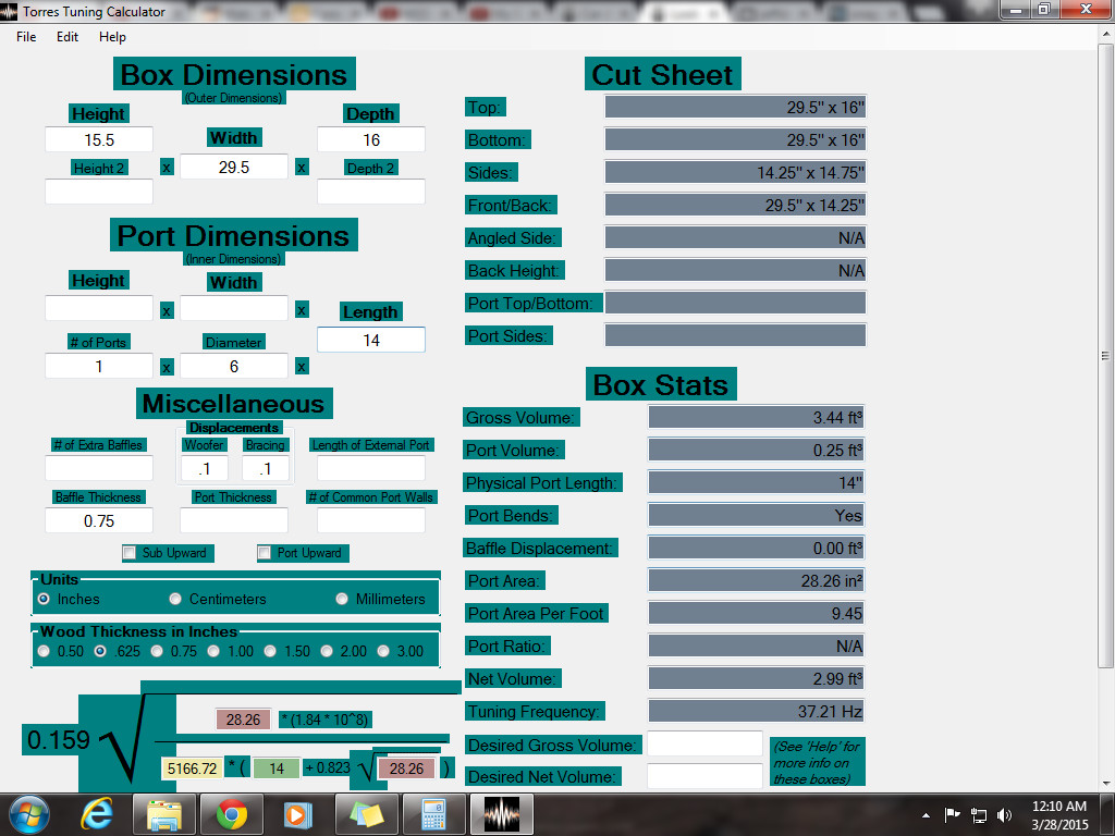

you can use a 6 inch aeroport at 14/15 inches long. Flare the ends and you should be fine. I would not go lower than 3 cubic feet for a 15 man. That is just pigeonholing a lot of bass response.
That's a ****** program there. You're right, it does look like I'm right on the cusp of too small. I'll go with the 6" @ 14" long. I still have the issue of where to put the port. Tips? //content.invisioncic.com/y282845/emoticons/smile.gif.1ebc41e1811405b213edfc4622c41e27.gif And thanks for the info Jeff, you're a huge help!

Just wanted to update I did the porting today. I ended up having to go with two 3" ports rather than the 6", because there would have been absolutly no way to put the 6" on the baffle and I couldnt find any 6" pvc that wasnt that cellulose core crap locally. Did em at 5.56" long which is what the calculator I used told me and have them 4" (I know someone said 6" but I just couldnt make it fit) from each wall of the box. Have them top and bottom left side. It sounds pretty freakin nice. I need to go in and seal everything up tight, but other than that it's fantastic. Thanks for the help everyone!
Glad to hear you rescued your box. Just to point out to anybody that might read this two 3" ports do not equal a 6". The area of a 3" port is 7sq" x 2 = 14sq" A 6" port has a area of 28sq". You would need 4-3" ports to equal one 6"
