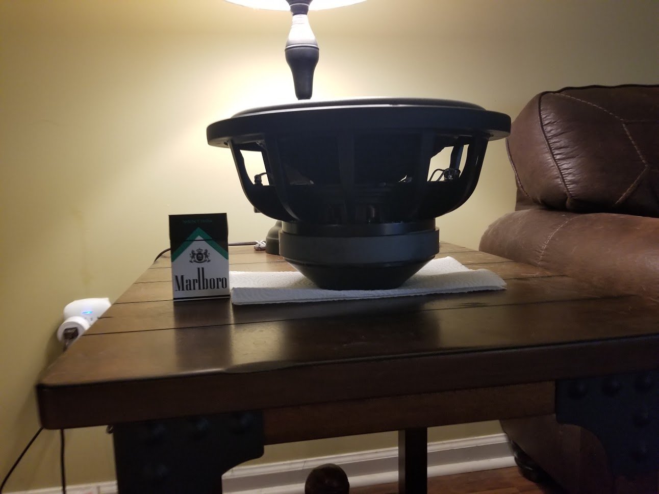

The sub looks great. Beefier than I expected. The spider is pretty stiff, but then again, I haven't held or played with a sub in like a decade.

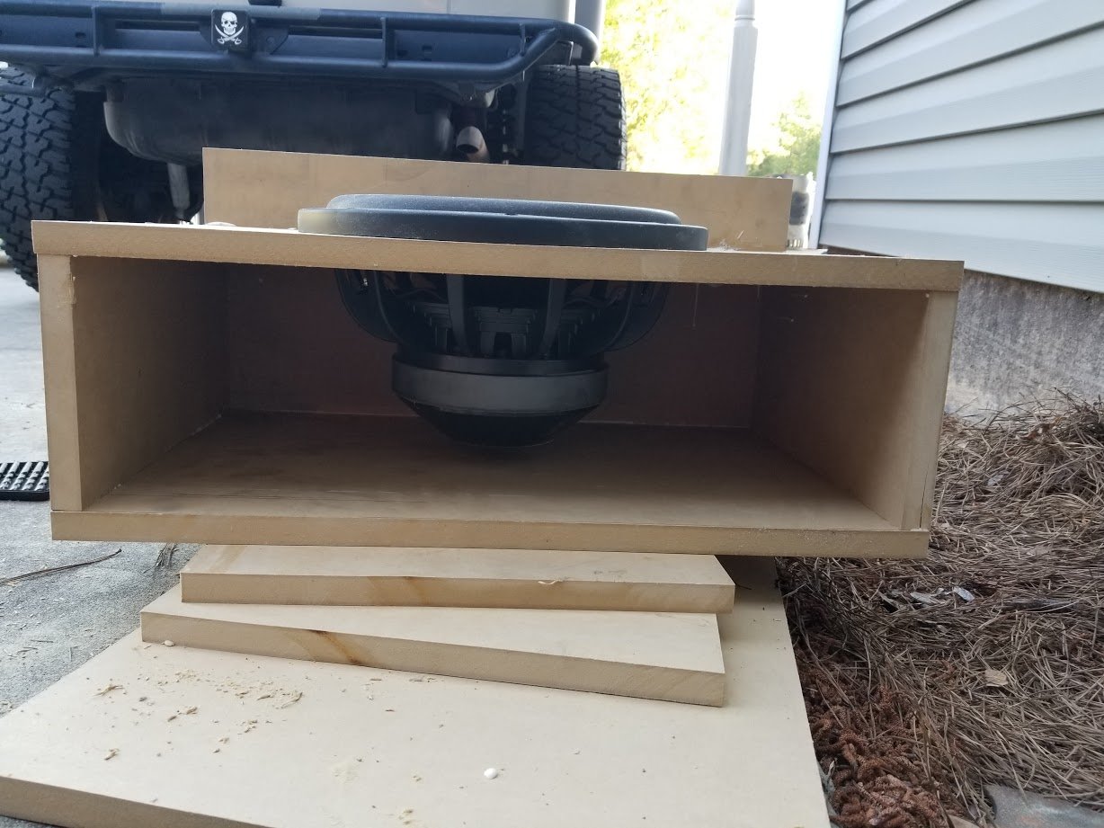

Here are some preliminary pics.
27845

Didn't have a table saw saw so the cuts weren't the best on this end. I went back and sanded it really flat.
27848

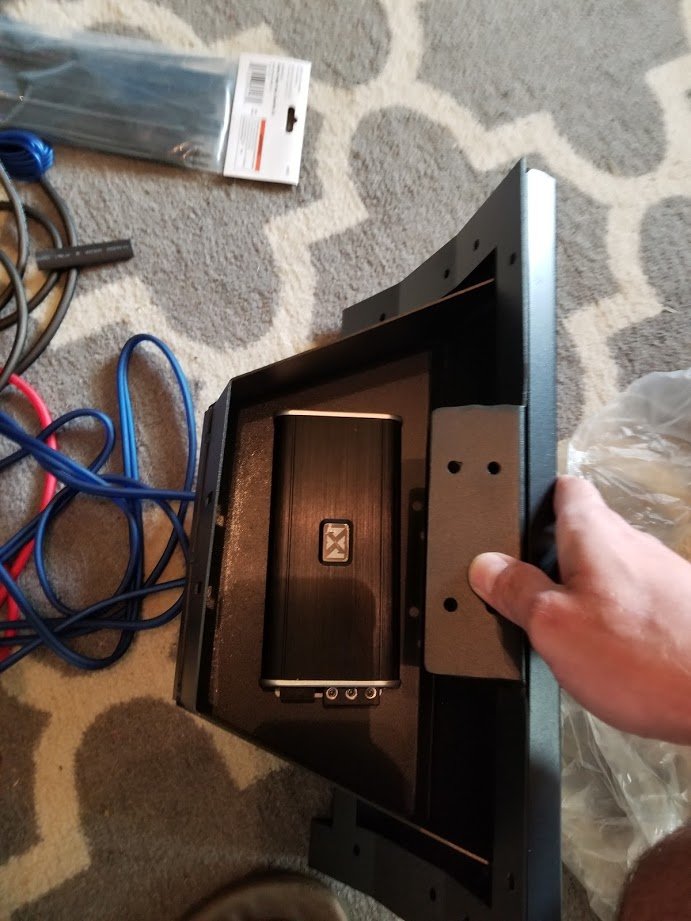

Test fitting the amp in the new glove box.
27849

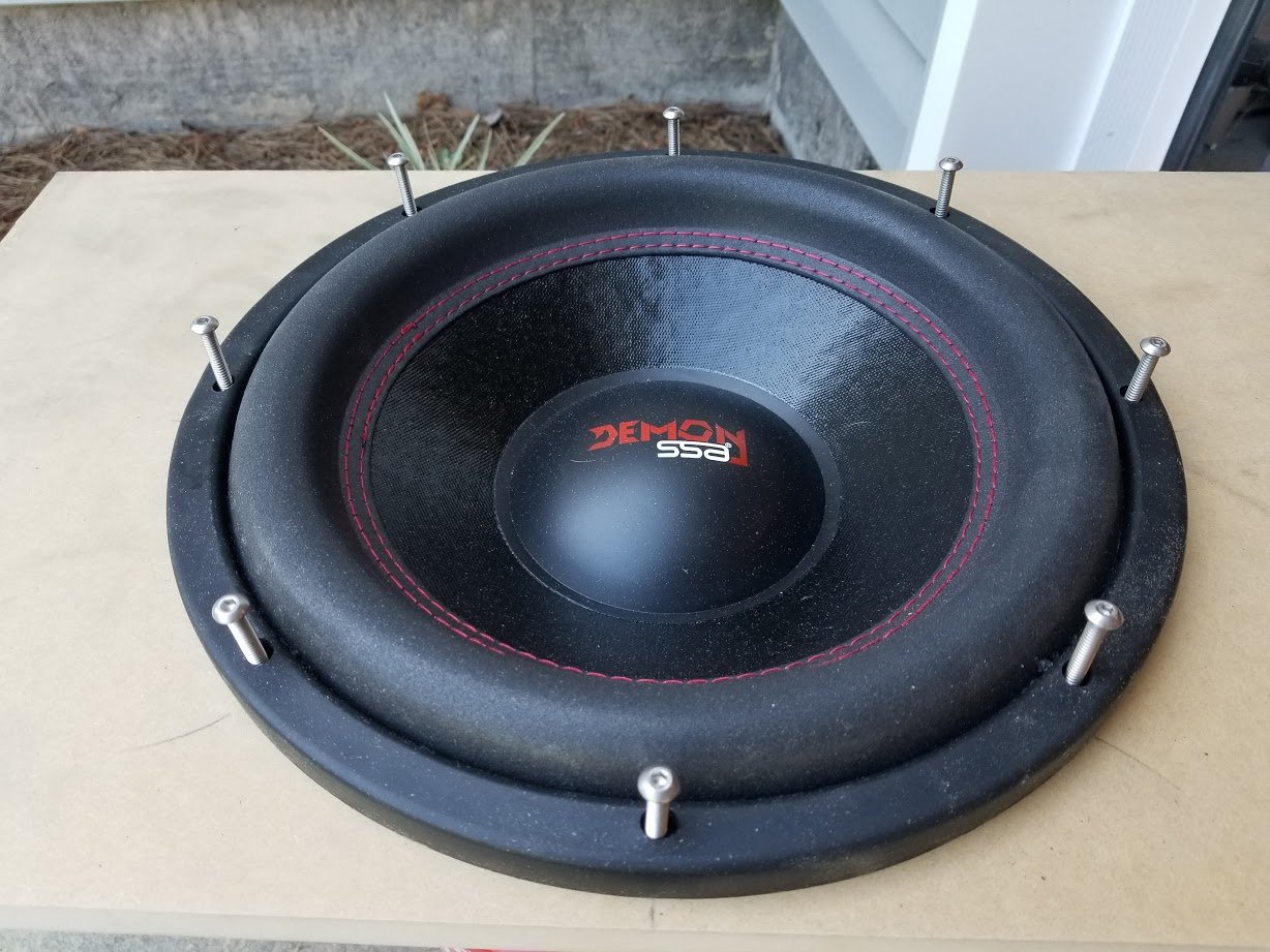

I think your sub box needs more height/depth and more air space. Looks like your sub is jàm-packed in there looking at your third pic. I personally haven't seen a box like that.
The Demon doesn’t have a pole vent so the motor being that close is fine. I’m sure his airspace is within what SSA recommends sealed.
Correct.
It's down-firing and within spec. I have a big cooler that I carry around in the summer (priorities) and the box was pretty much built around it. There's about an inch on either side of the cooler with the box in the back.
