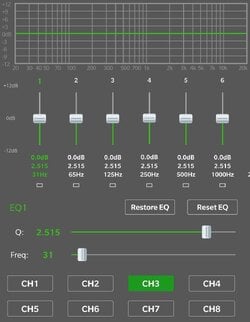

it doesnt reduce the signal, it reduces the voltage to safe level the amp can use. What you want is a flat signal BUT your head unit is giving you a high passed signal like this.
Solutions would be
1 get a JL FIX86 and let it put out a restored flat signal
2 get a new head unit which i dont think you want.
