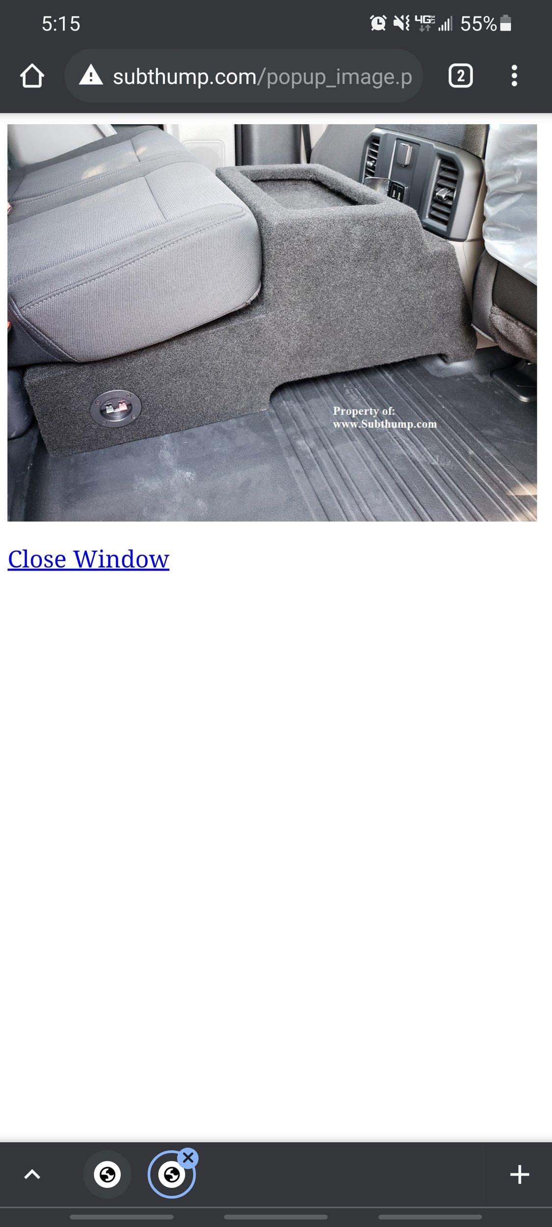

Wanna start off saying that I've tried to do all the research myself but got a headache so I came here to cheat.
So, site says its 1.3 cubes, I had a sundown sa12 classic in it, realized the speaker wire was too small for watts I should be running...changed wire size, threw pollyfill in it cause Google said it was a good idea...used a volt meter to adjust the gain and had the poor guy booming exactly how I wanted it....for about a week.
Now that I'm lookin for another sub what are the suggestions? I'm all for SQ but I do like the rattle the cup holders and make my nose itch from time to time
All feedback is welcome

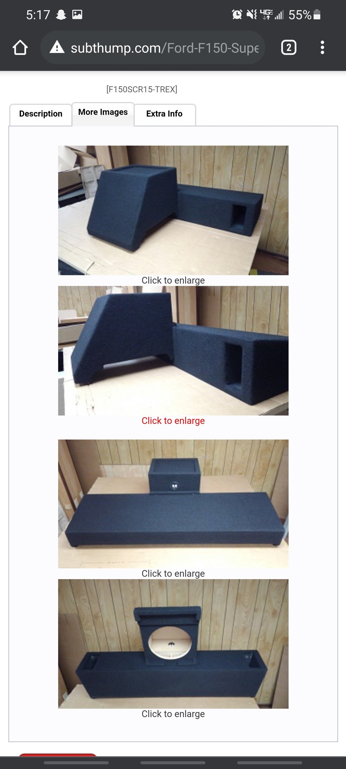

Subthump sucks. I had a box from them for my '03 Explorer. Biggest waste of 150 dollars I ever spent. Wanted to keep it clean and not deal with a bigger box. Now that thing is only good for firewood if that.
Horrible design, horrible product plain and simple, cheap materials and so on.
You are best contacting @Buck and having him design you a box for the subwoofers you choose and to work in the situation/space you have. If anyone can do it he can.
Main thing is, I'm going to stick with one of those box designs and wanna know if going up to a sub that can handle the power provided is going to be ok or if the box size is the issue and I just need to lower my expectations and turn the volume down regardless of the sub I put in them.
