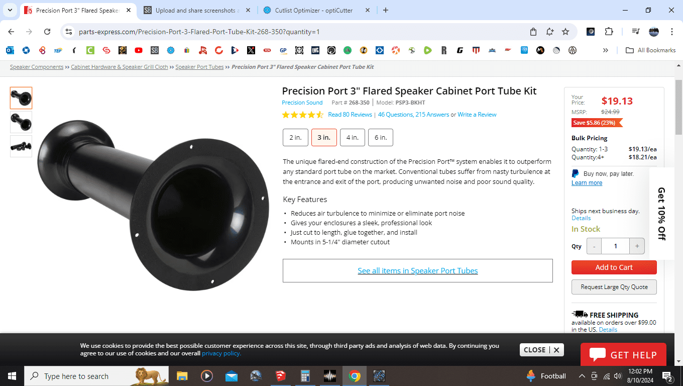

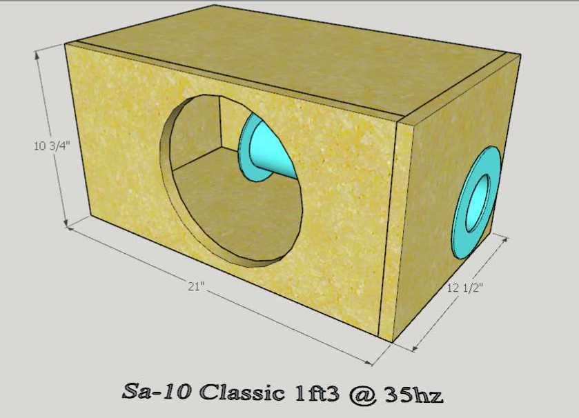

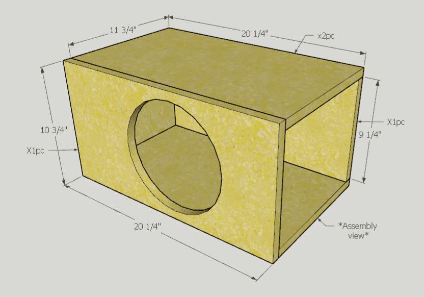

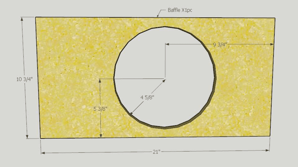

audiobaun 5,000+ posts CarAudio.com Veteran 15,936 2,446 USA Aug 13, 2024 #2 shredder1 said: Precision port 3" kit recommended. Click to expand... sweet!! Ill prob use this eventually after I get settled back in from moving!!! Thank you for sharing these enclosure designs!!

Doxquzme Premium Member Current build, 2012 Mazda 3 Hatch 2.5T 2,952 1,494 Boise, ID Aug 13, 2024 #3 I've done pretty well with those ports from PE, pretty much all i use.
