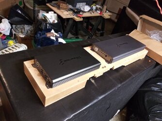

ah yeah, it's definitely a learning experience. I basically did the 5/8 mdf for weight reduction and I  cut the supports to 6inches and rounded out middle. All my builds have been 5/8 thick. I'm thinking for anything around 1k watts that may suffice with proper bracing. If ya check my box build post I  remounted the amps off of box and still they vibrate. I'm thinking the only way is to build a stronger box that won't vibrate as all and mount them to it. What do u brace ur box with?
I used cutoffs rounded over for airflow, vertically and horizontally where the panels were large because I felt they'd do the most in those locations.
It's only .75" single ply, single baffled (the double thick corner panel is there as I had to fab something cause I ran short on material) with an around 30lb driver on 2Kish so everything is solid. I had a little more power on the last vehicle/build and it was .75" single ply and baffled with 60lb of drivers but it was braced and configured (center port) in a way that worked out well with the rack mounted solid but still on the box sort of...
Boxes look good and solid. I see the amp rack with the two on hinges to hide all the wires? Nice. The amps didn't see any vibration at all in that position? The one with amp mounted directly to there is still no vibration on amp?
Ah... there was MINIMAL vibration... very slight, I felt like it was very solid and had no detectable flex but vibrations... sure.
Hell everything in that Blazer flexed to some extent... but the box flexin'... nah

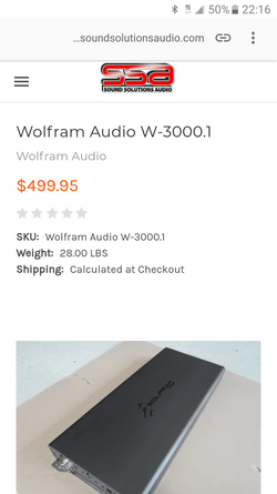

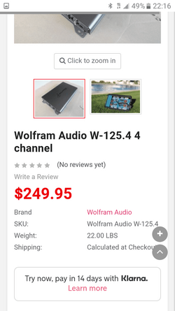

My bad I  missed those. So subs are 3 10inch soundcube hdc3. 1200watts rms.
Amps is wolfram 3000.1 at .67 ohms and the wolfram 125.4 together amps gotta be almost 50lbs in weight. Big mofos.

I have those same amps. 30 lbs at most, nowhere near 50.

They definitely weight more than 30lbs. I'll have that amp rack out soon.  I'll put them on the scale with a handtowel between. At least 40-50lbs. I can't seem to find their weight on wolfram sight,  u?
u do? How u liking those amps? Also do u have urs wired below 1 ohm? And no, highly doubtful that I  am feeding them more than 1500watts rms on stock alt. Can only turn head unit up to 15 outta a possible 28 before distortion. Anything over 15 and voltage drops way to low. Like down to 11 or more.  15 is thw sweet spot until I  can get some lto cells.

Well damn. Idk, these amps feel heavier. They are nice. I really like them.

Different wood isn't going to fix that, what you need to do is figure out a way to firmly secure the box to the floor of the vehicle if you want it to stay put.   That box looked sound enough with the bracing and all.  If panels are flexing add more bracing or double wall that side, if it's just the box itself moving work on bolting it down somehow.   IF you do redesign figure out how to leave yourself room to mount the amp not on the box.
