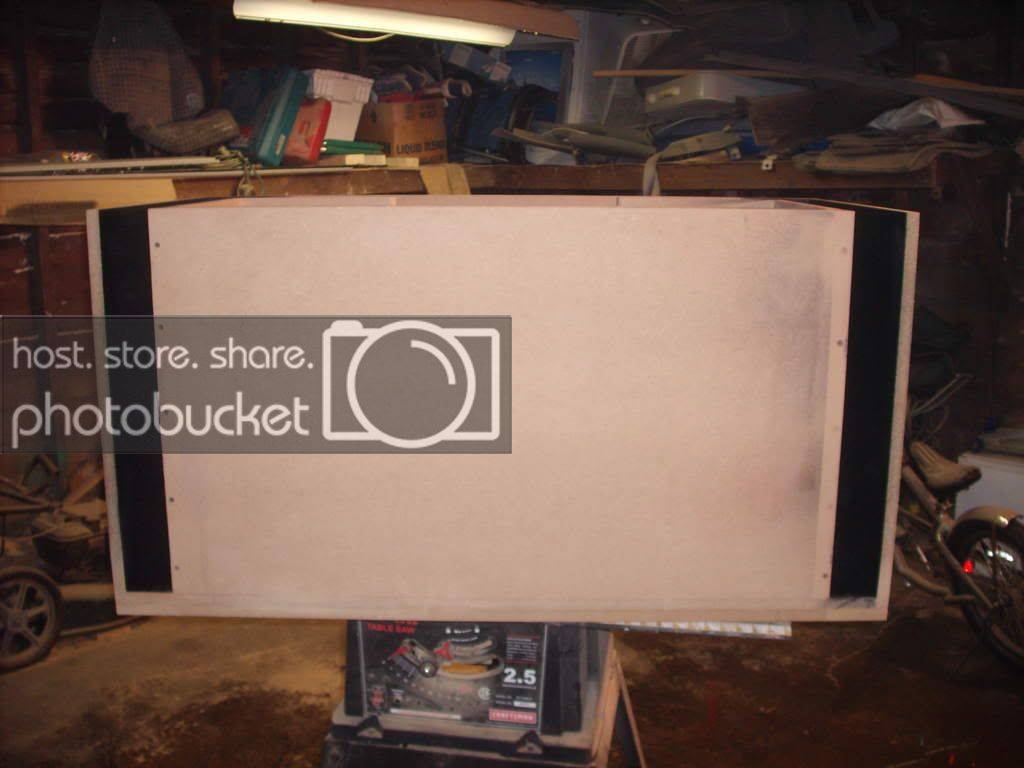

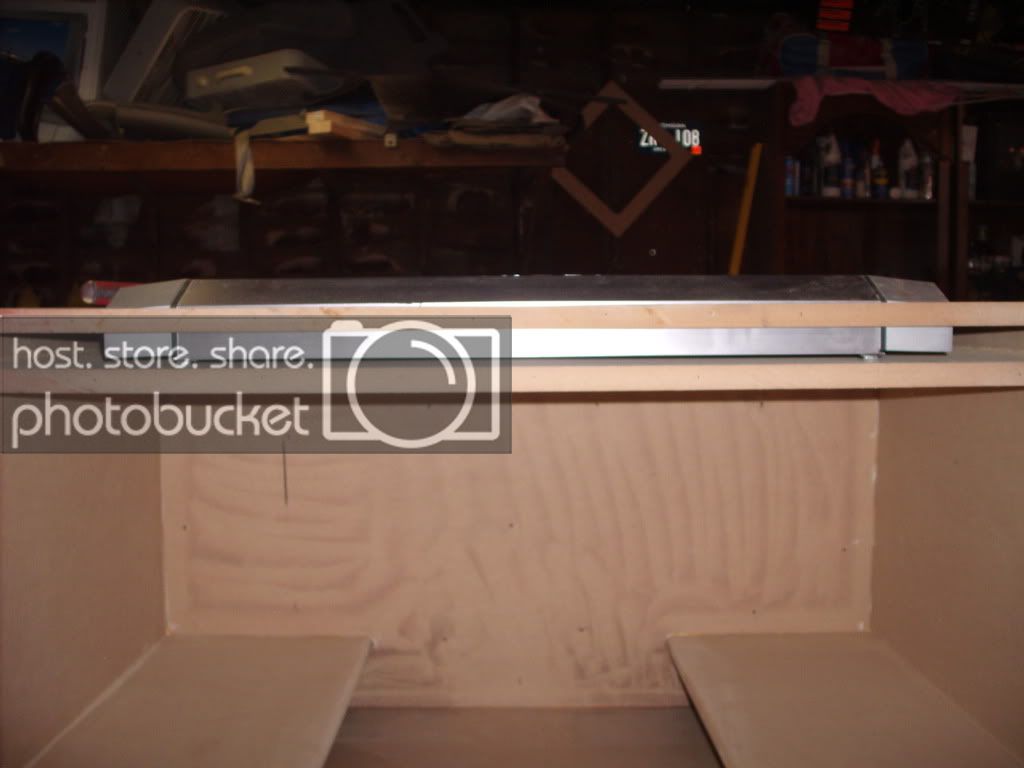

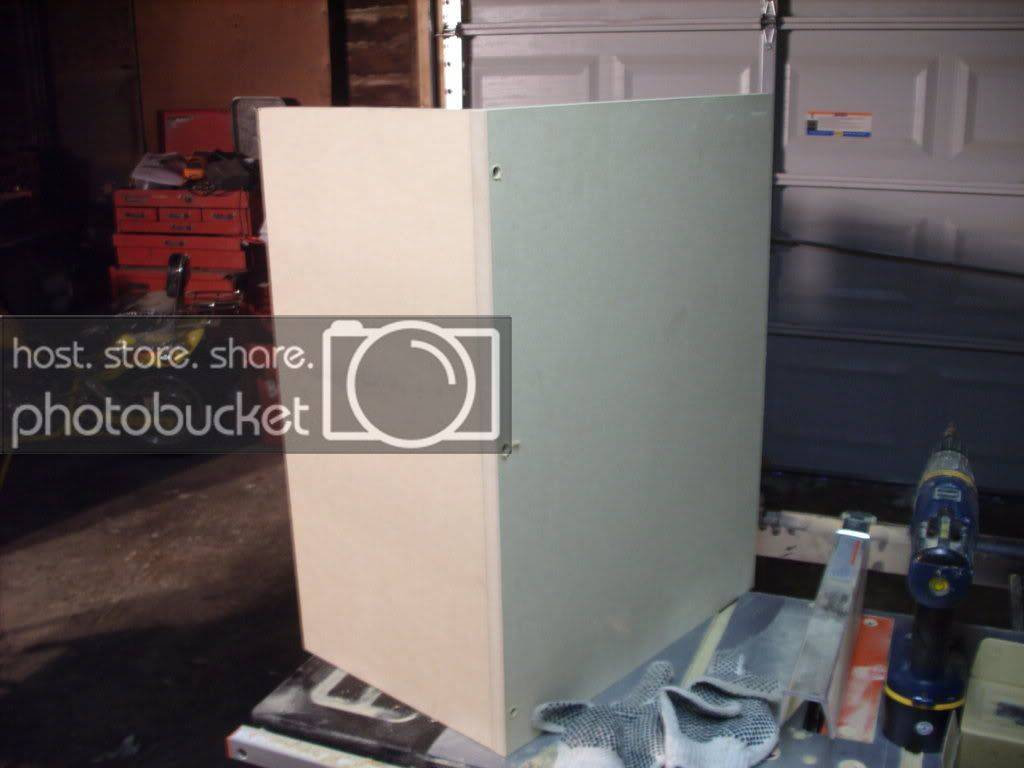

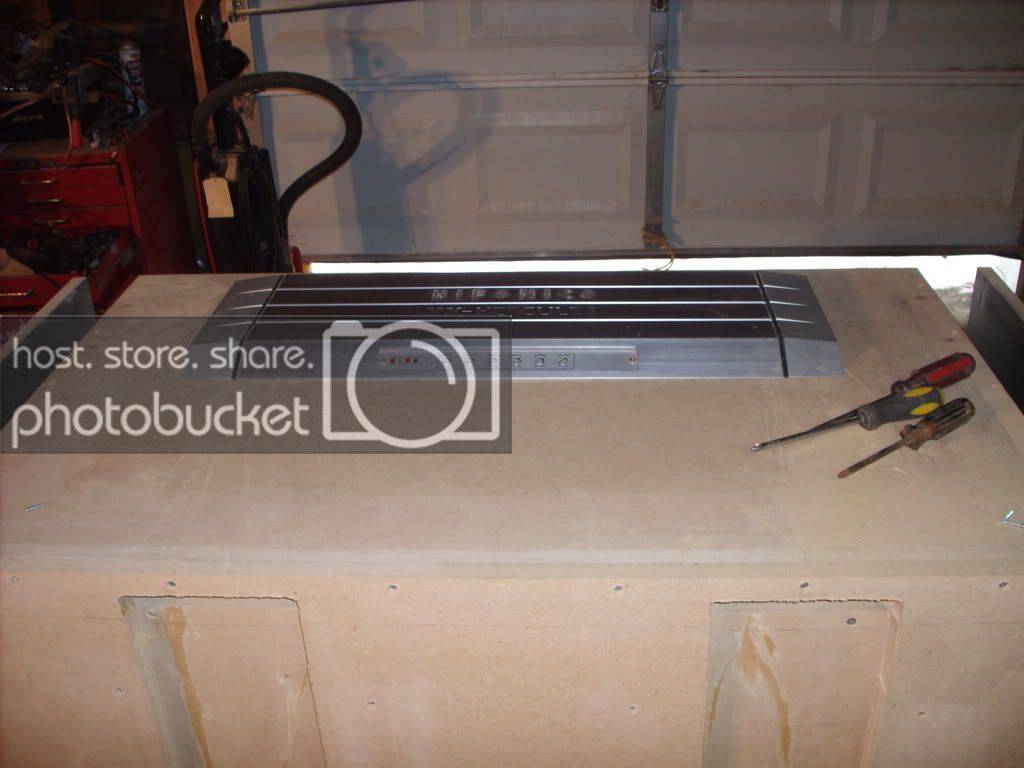

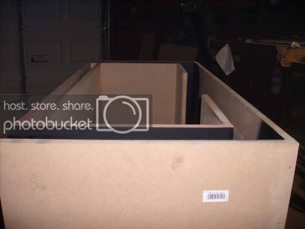

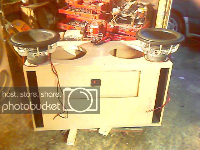

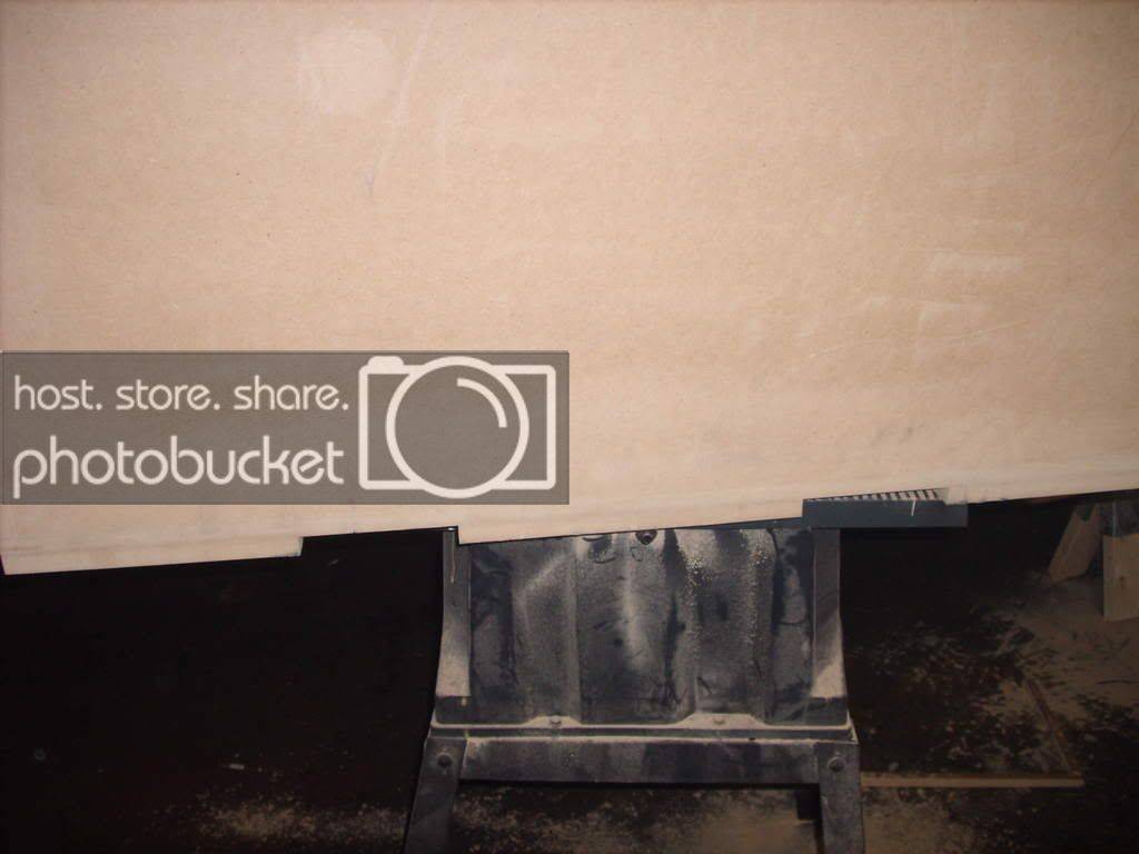

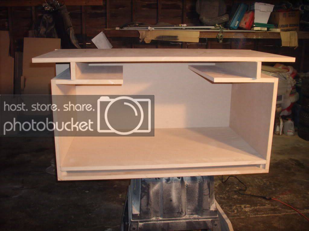

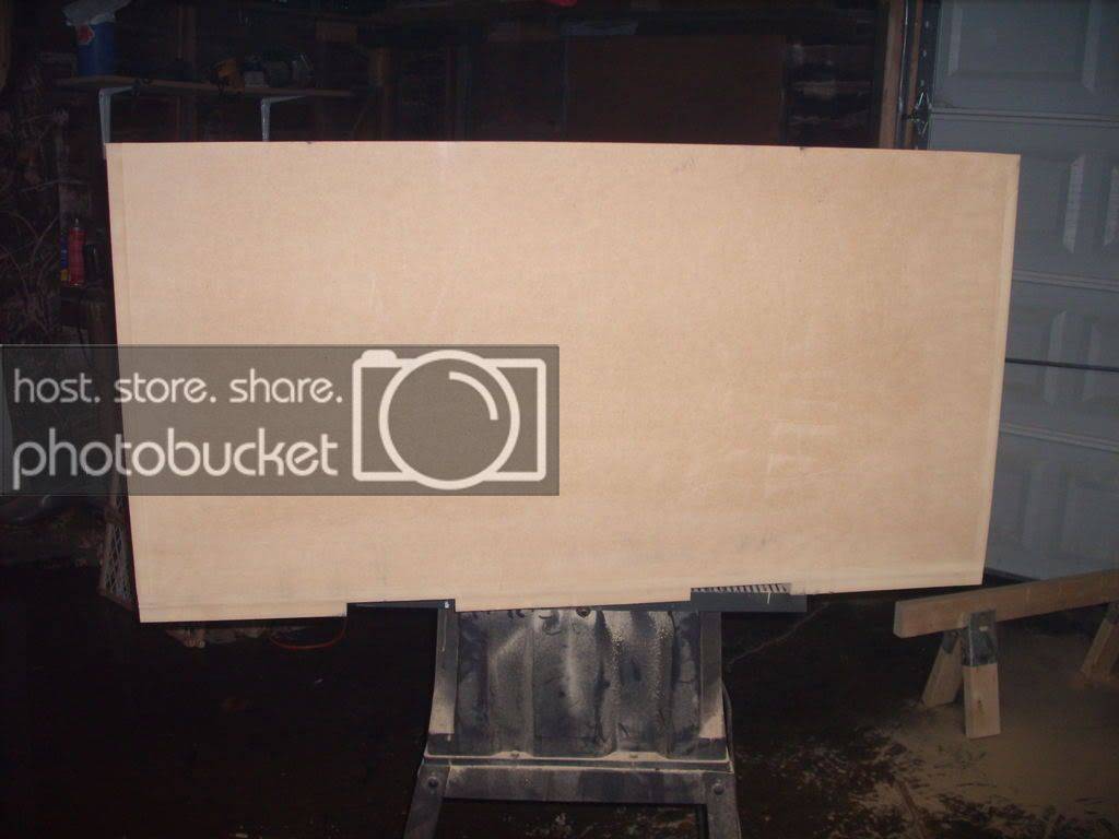

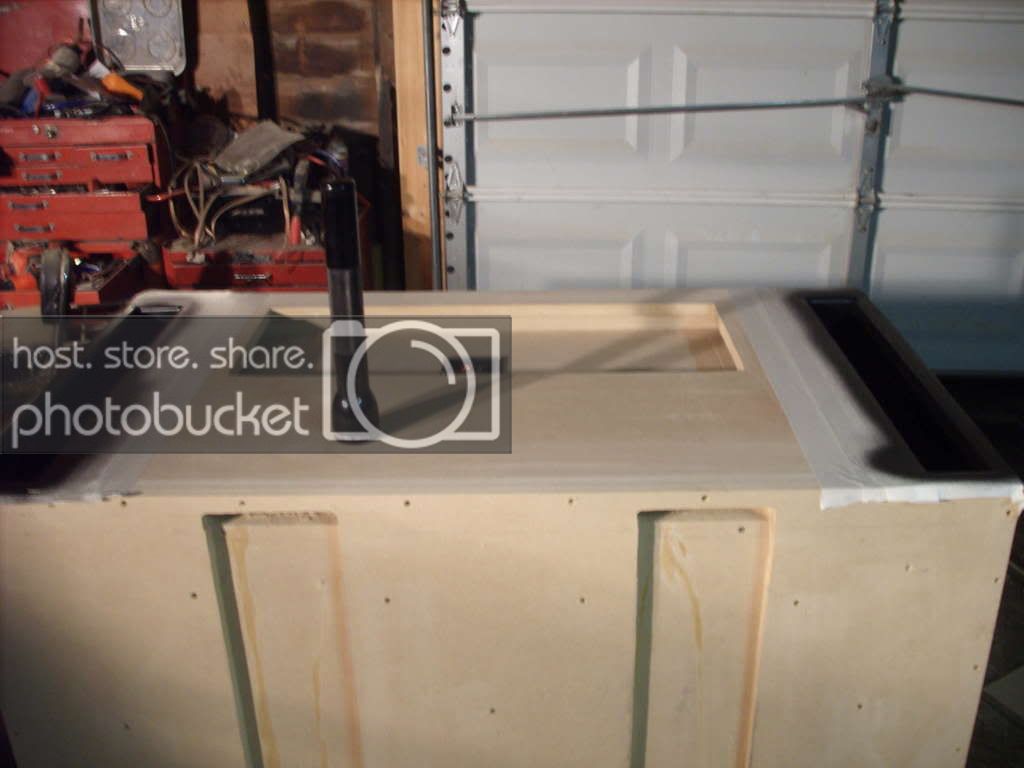

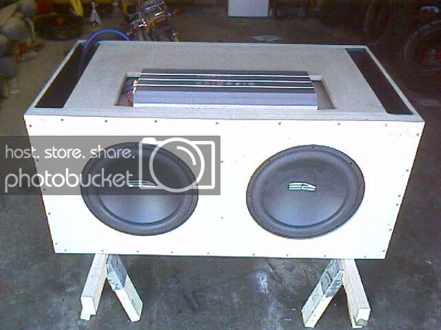

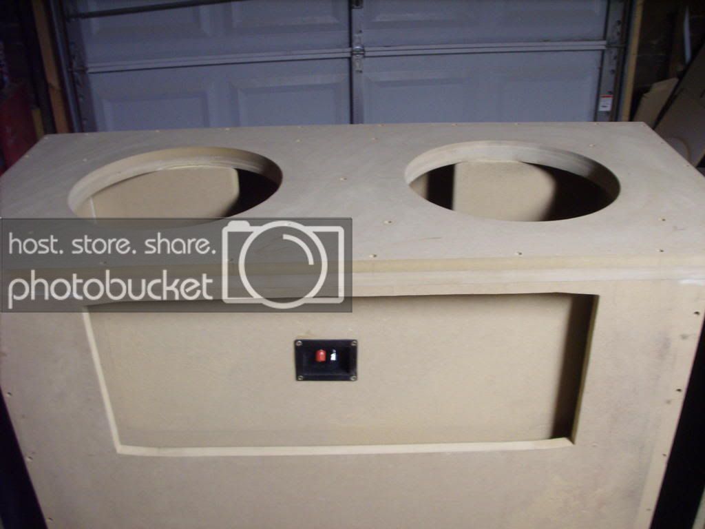

I guess its my turn to post. Here are the box pics. Its 8 cubes tuned to 32 hz with 100 sq inches of port

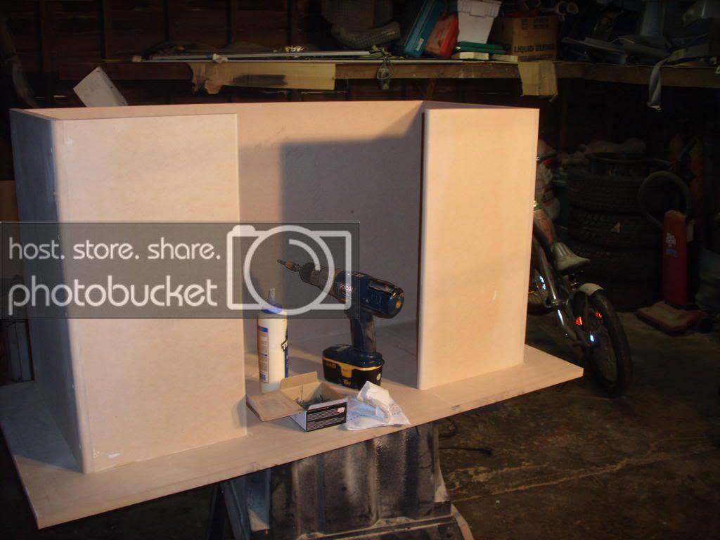

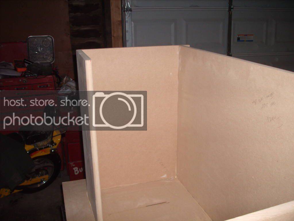

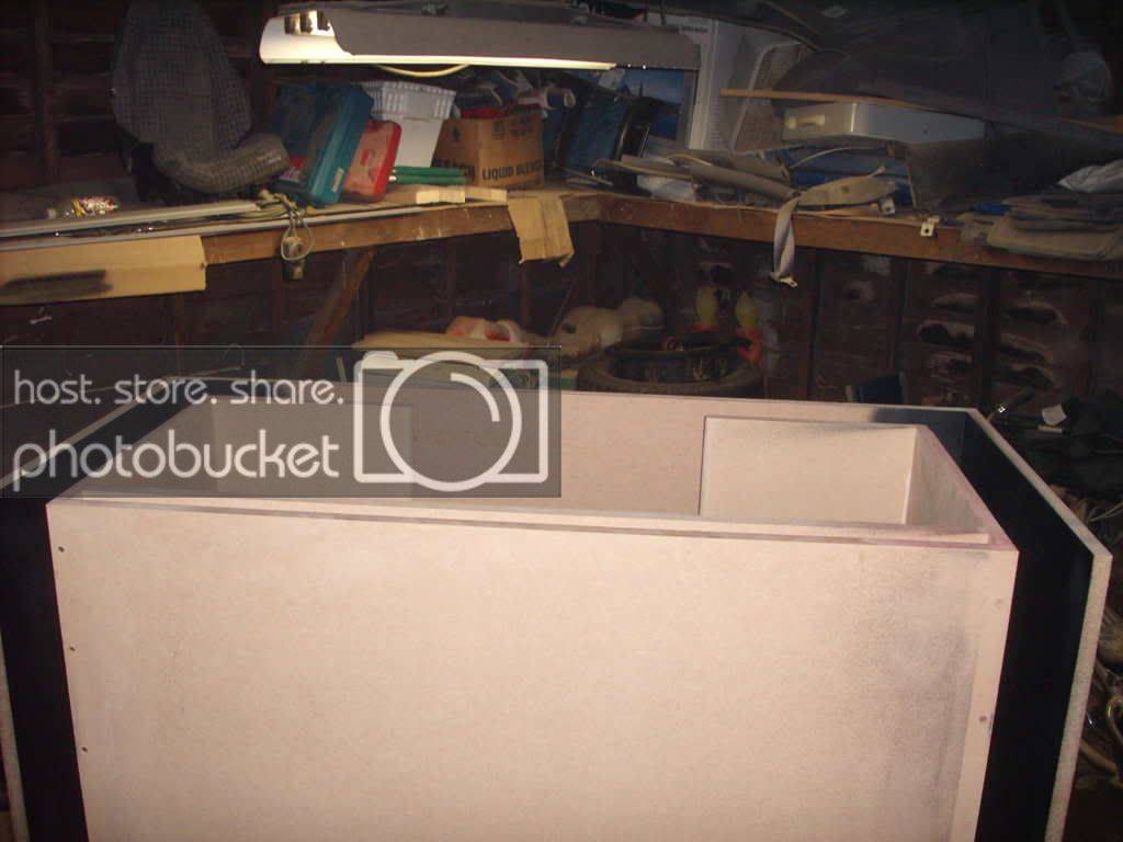

Starting off

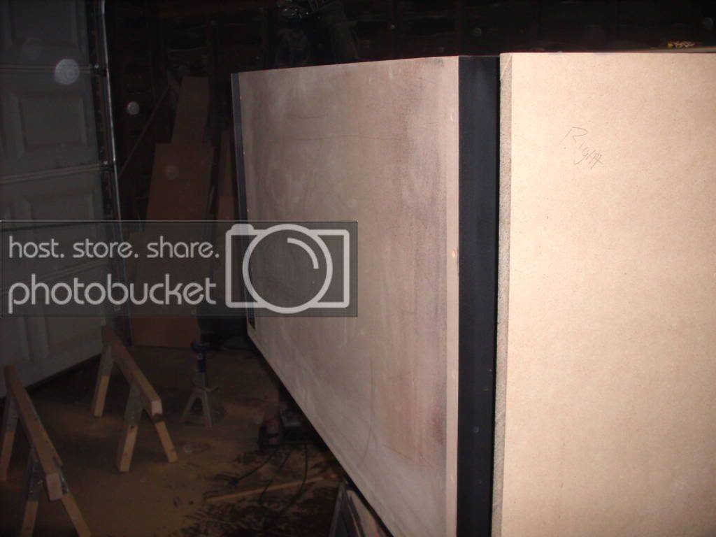

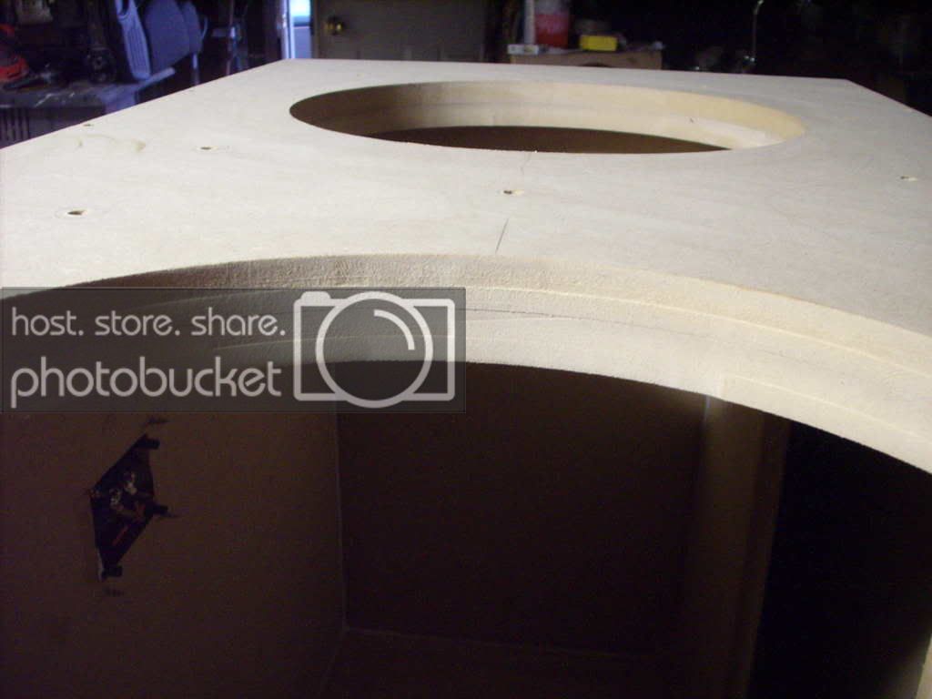

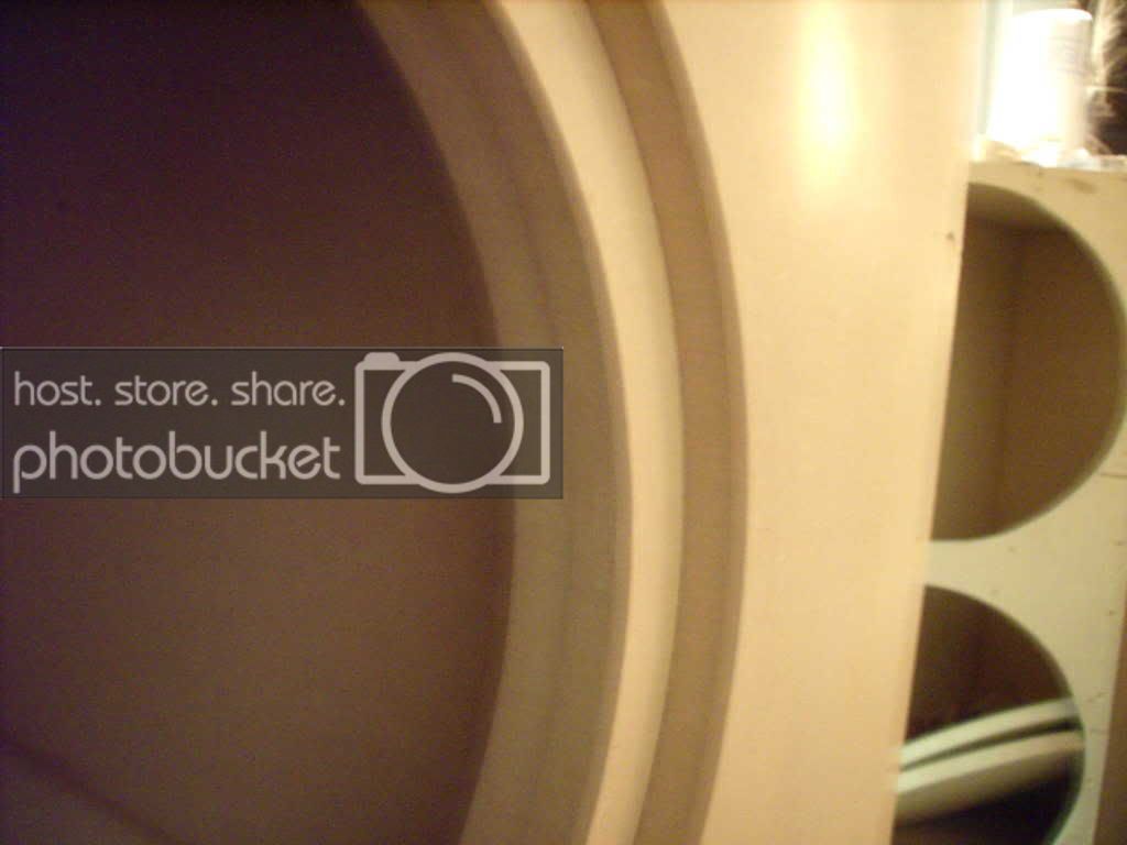

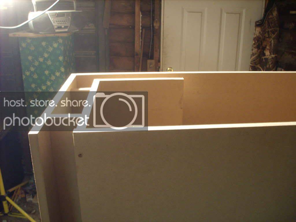

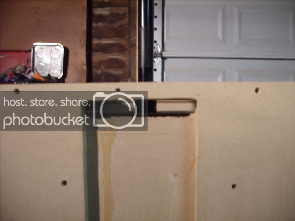

Working a port

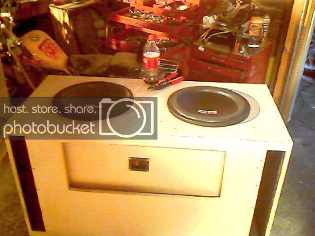

Getting there
Painting the ports
Just a couple more of my low quality pics lmao...

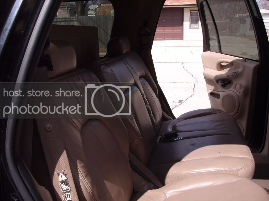

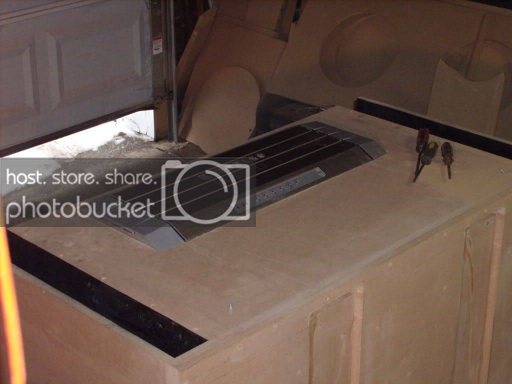

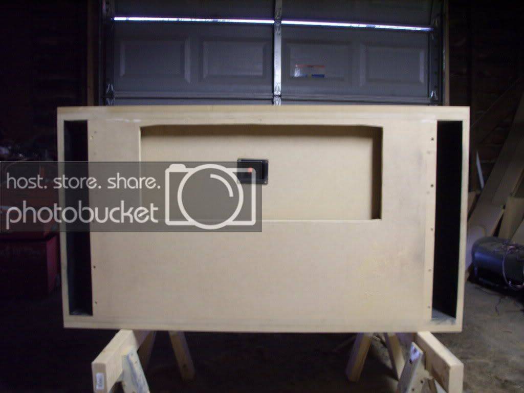

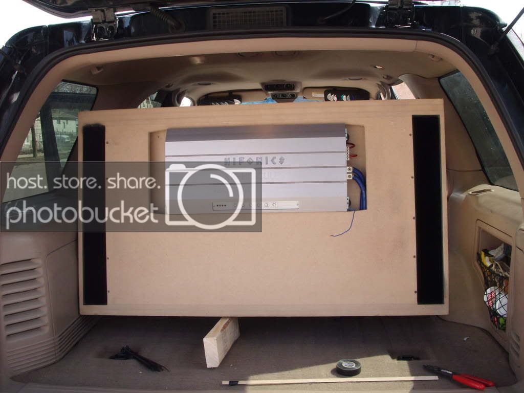

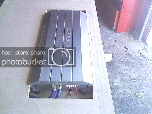

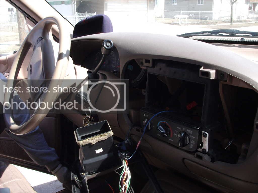

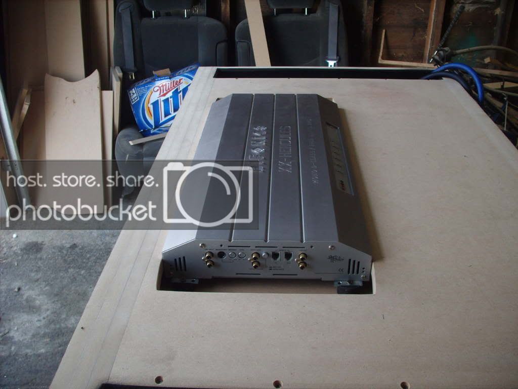

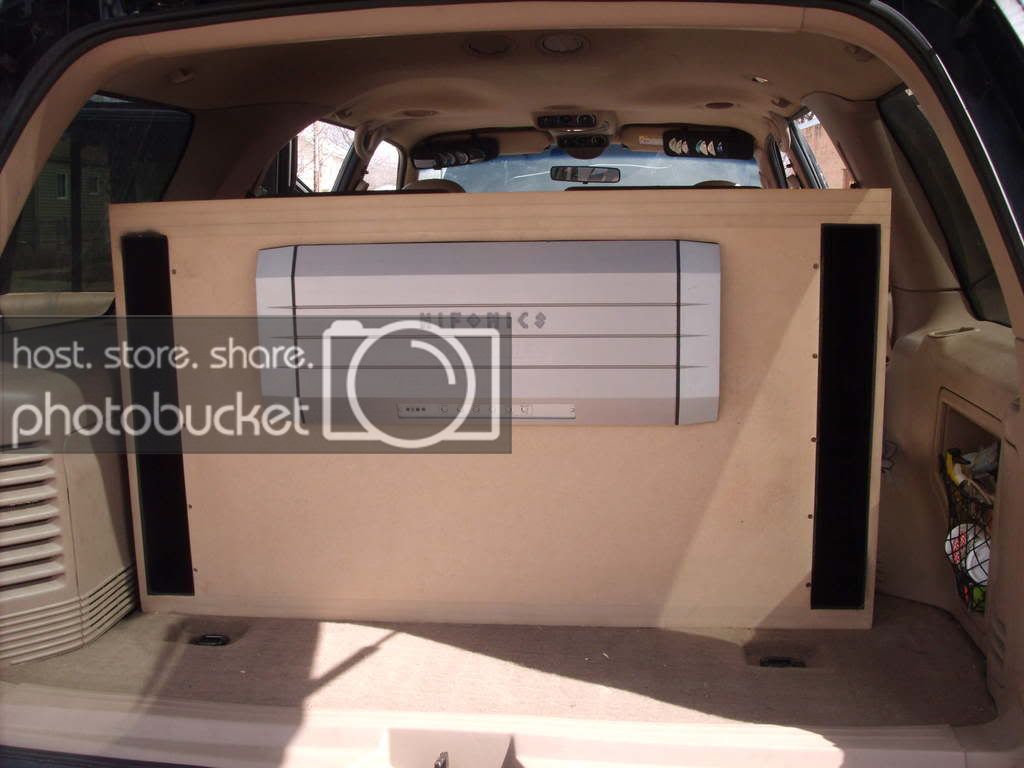

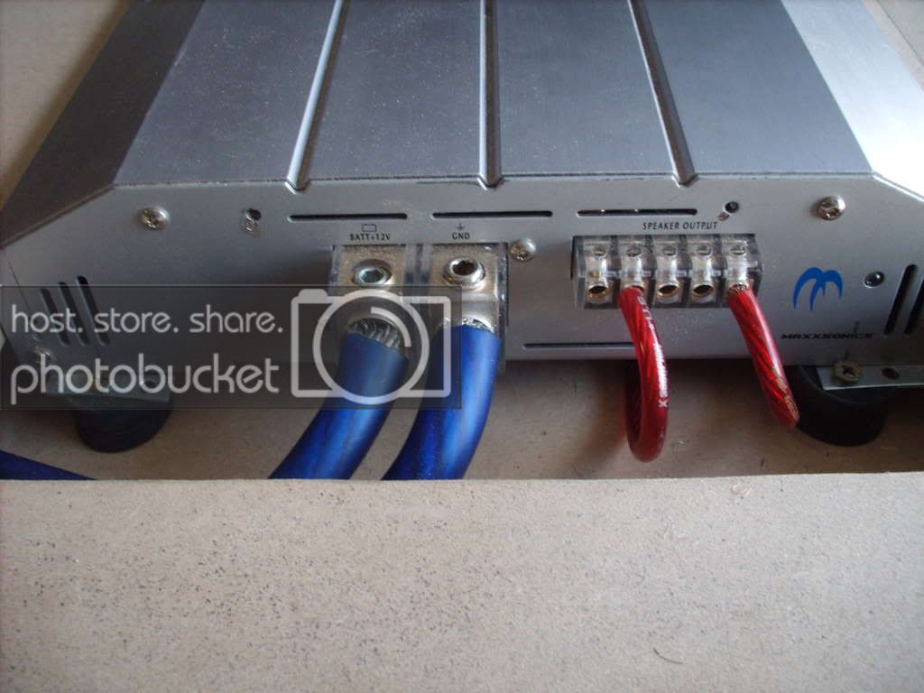

Had to Flip the box on its back to mount, and wire the HERC...

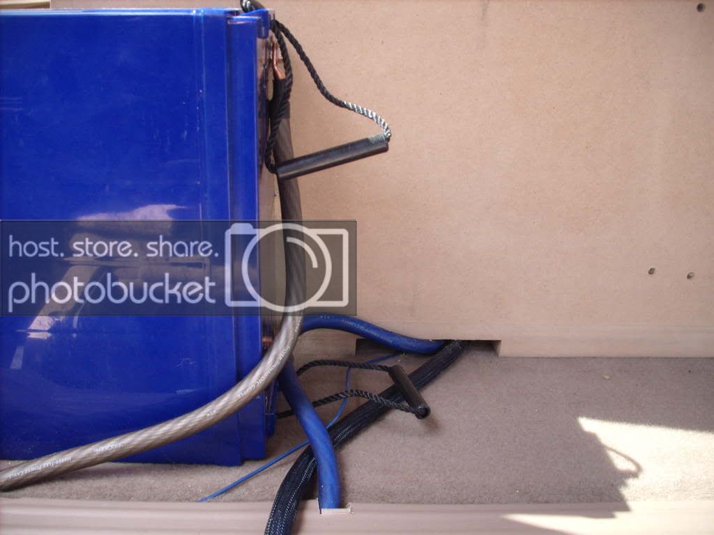

Nice and clean all wires out of view once end caps are in place..
Just Running and rerouting some wires....

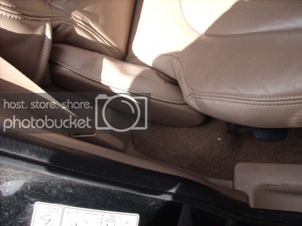

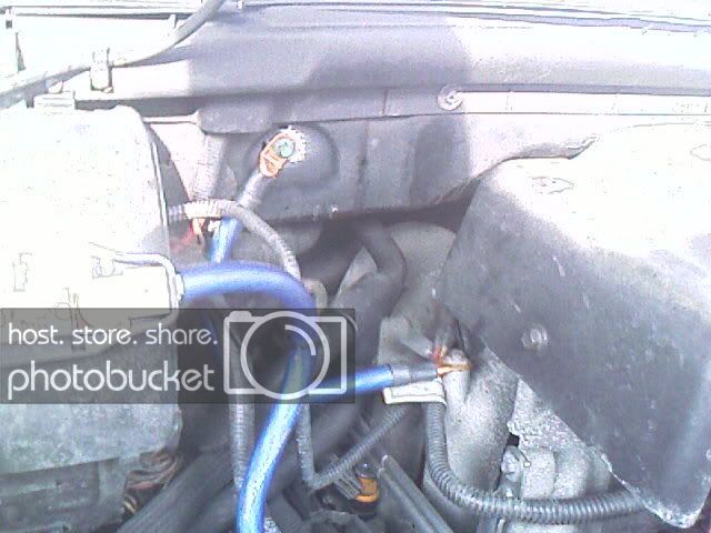

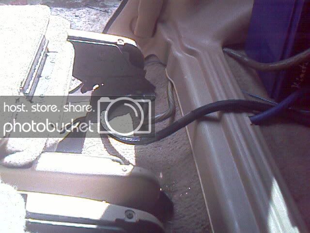

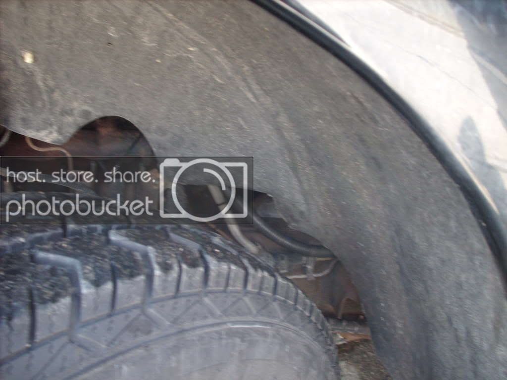

They say don't ground to seat bolt But.......
My bolts go into the frame so screw that...

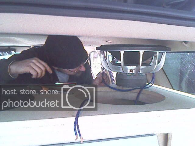

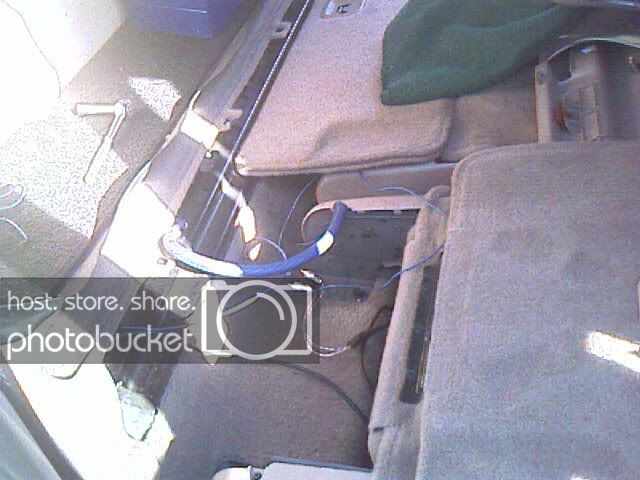

Had a small Snag wires came out of subs....

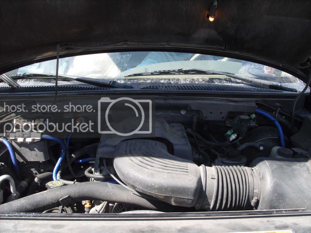

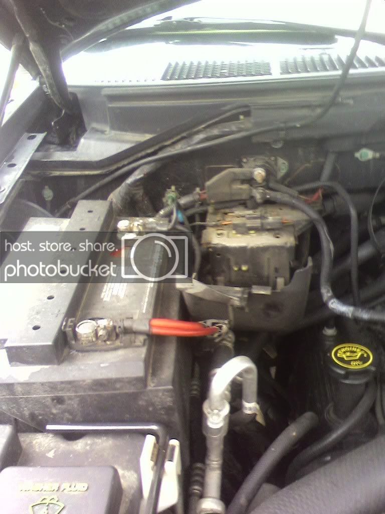

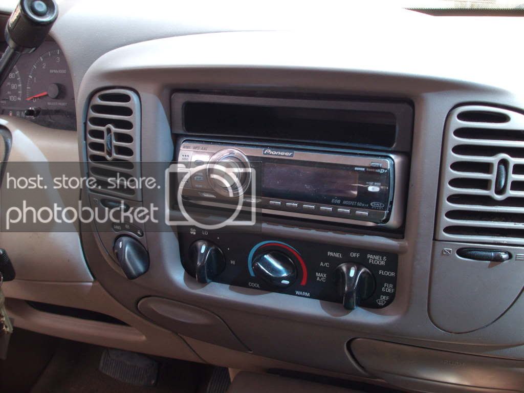

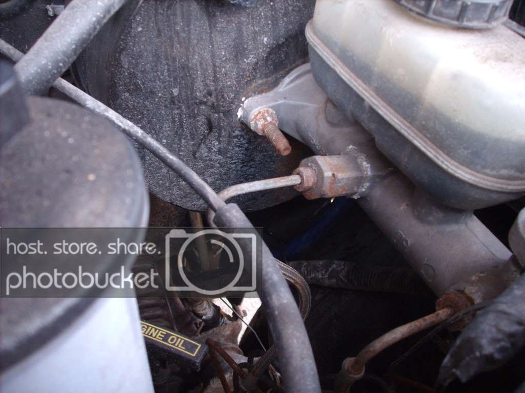

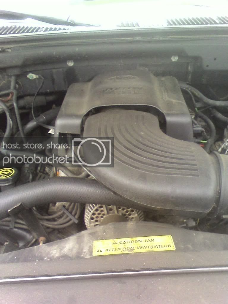

Couple of Pics Under the hood B4 the BIG Up Grade.....
PEEP the GROUND Wire LMAO

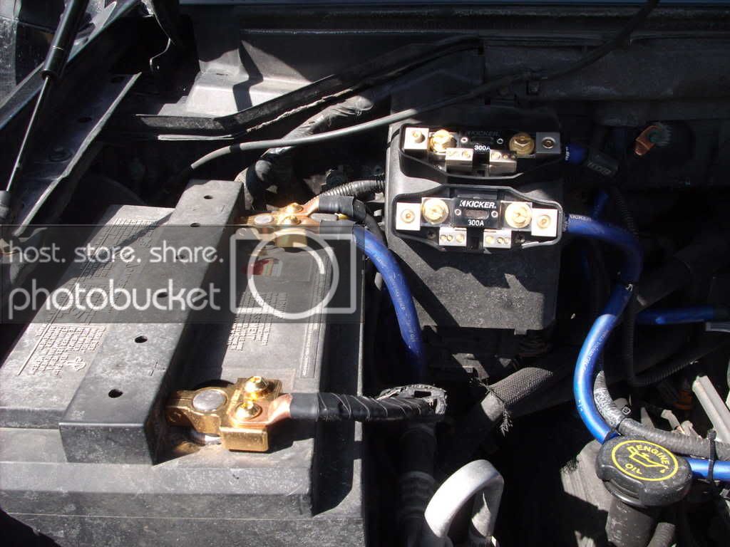

From that to THIS....
