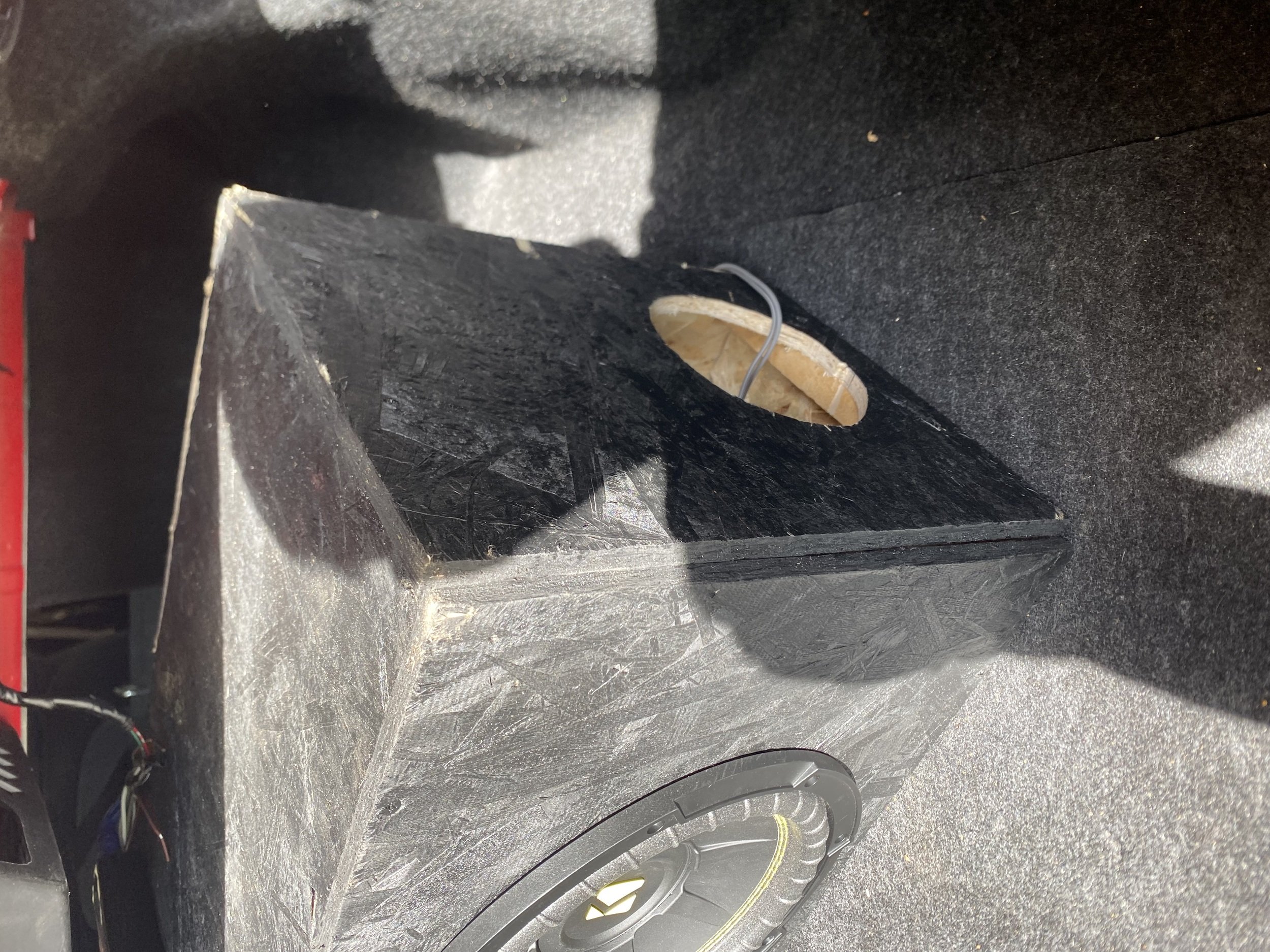

Here is a picture of the port if it helps. View attachment 39039
That's not a port its just a hole. That being said there is nothing wrong with trying to get some bump in the trunk and doing it yourself. Everyone here started out and some were great and some sucked, but everyone had to start. I would seal up that hole like others have said, also caulk the box on the inside all the way around. A good box will play loud even if the components aren't top tier. That's a decent sub and the amp should be enough. Your main concern should be getting some 4 gauge power wire to the amp, then some 4 gauge wire for the ground, and make sure its a good ground. I also recommend doing the "Big Three," its listed everywhere on here when you search. The big 3 three will help you get the most power and best possible ground from your setup.

How big/round is that hole? Maybe you could get the measurements of the box, determine the volume and then put a pvc pipe in the hole. Cut the length of the pipe to desired/needed tuning.
Id Aero-Port it to the rear if wanted to try porting. Sub rear Port rear in trunk space.. Seal that Montrosity up on the side. Id get a piece of 1.50" PVC approx 7" long ,and start from there.May end up fine after pulling and marking and cutting til tuned to where it meets his liking, Put back in and silicone around that. Done/Tuned.Deff get at least get a 300-400 watt mono amp.. Man thats got to sound like pure azz fo sho 👀👀:poop:
