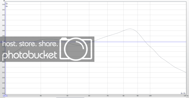

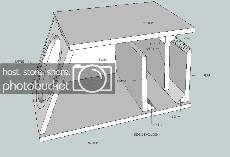

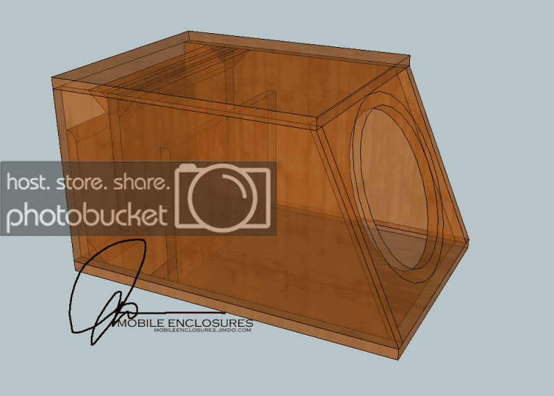

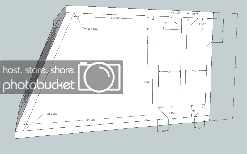

This is the sub enclosure design and response characteristics.
I picked the location in my truck because it helps me get the sub as far forward as possible, and it doesn't take up room from my family because it was already unused space.

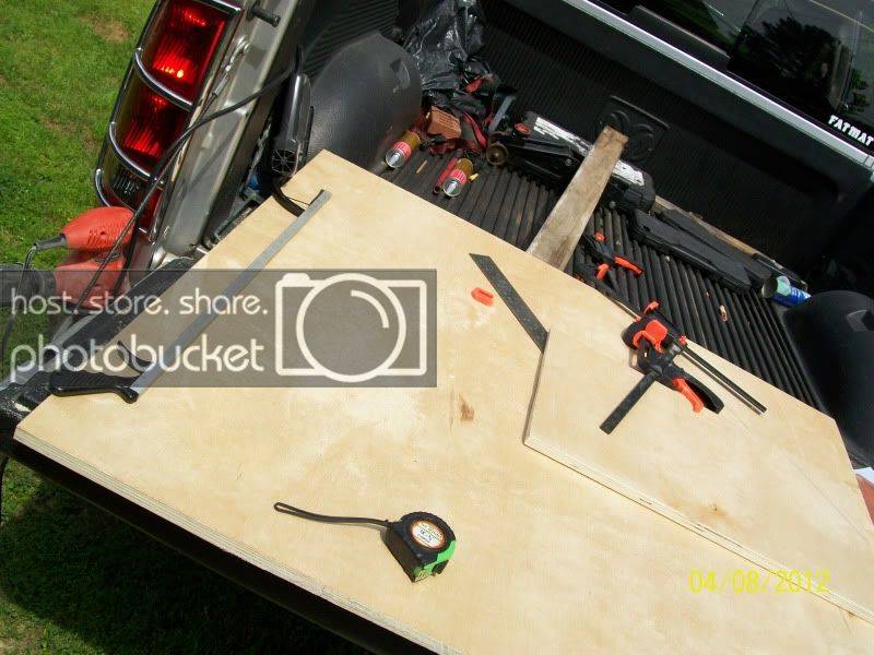

This is how most of us have to build enclosures vv

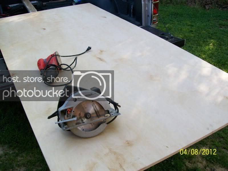

Just the back of my truck, a circular saw and jig saw (which I didn't have last build) and a palm sander.
The cuts will be rough, there will be mistakes, but those can be fixed. This build log will include the enclosure, amp mountings, and any other ideas i come up with to enhance SQ in the truck. I will add some tweeter spheres to the dash or A pillar's as soon as I can decide on a final speaker to run.

I know! Almost to 90hz before the drop off. It's really gonna help to hide the location of the mids in the doors and help the sub blend in with them. I have been having a really hard time with midbass staging, so i am hoping this is gonna help. It's so hard because the rules of the competing organizations prevent moving the midbass's from the door, so i have to try and get them to play higher (location and frequency wise). I think I am gonna have a lot of tuning, but fortunately I have more processing than any man on earth should have, lol
Lol that curve itself is making me want to do an sq build in my gf's car haha

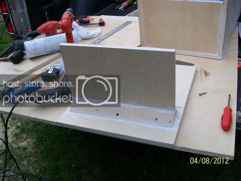

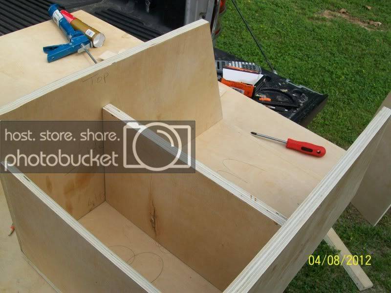

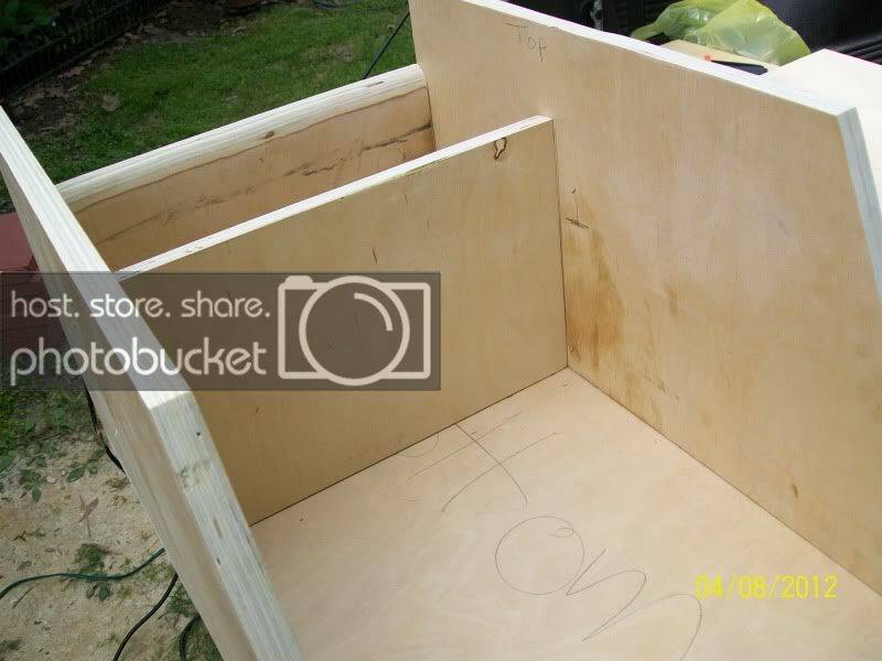

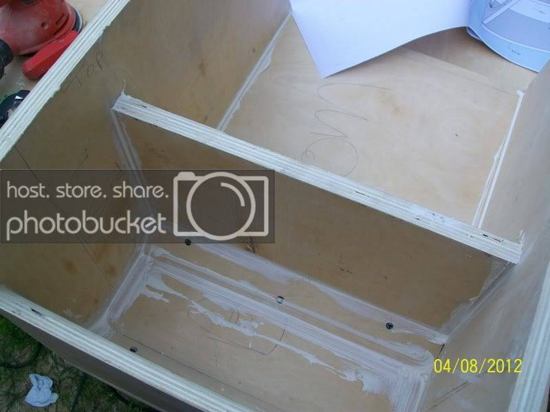

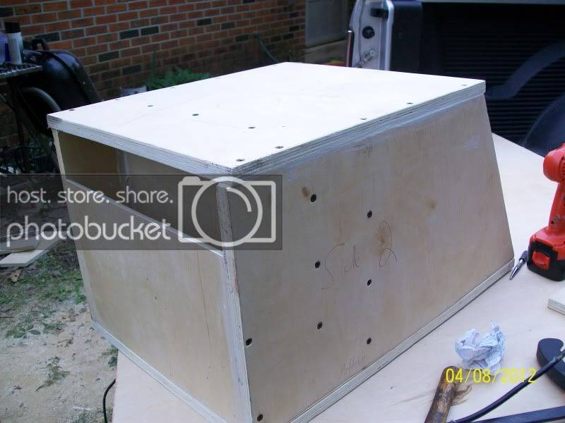

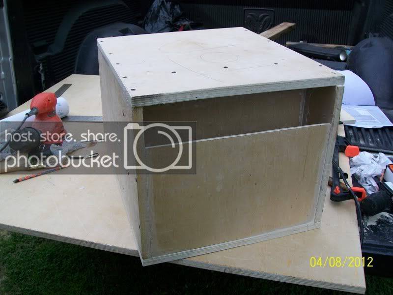

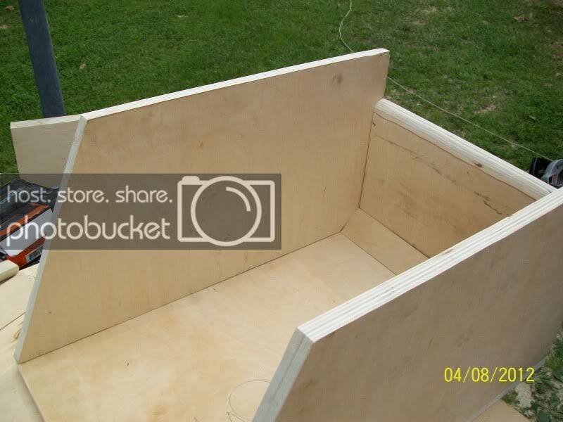

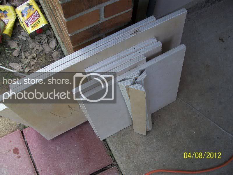

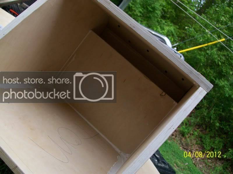

Okay fella's, here are the box shots. I really tried my best, and it turned out so much better than I had thought (at least I think). I have always used 1" MDF for all my SPL builds. I had a vendor that could get it for $65 a sheet and I just never bought anything else. Well I used the 3/4" Birch this time and I didn't realize how much lighter it is and it's rigidity is awesome! The box has to be 30-40% lighter than MDF, anyways, here are the pics!

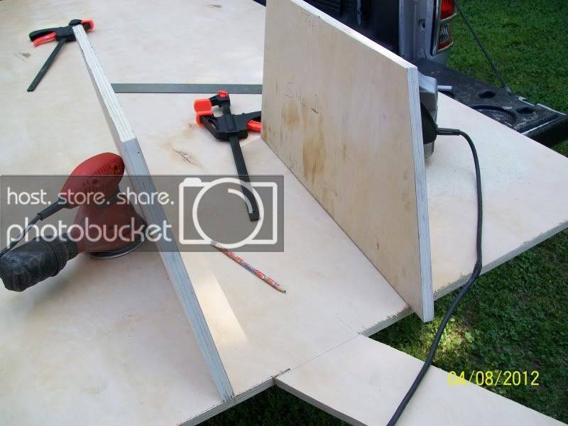

The 45's for the corner's were tricky as heck with a circular saw, but they turned out okay
All panels were test fitted and sanded down to make sure everything was a tight fit (kinda, lol)

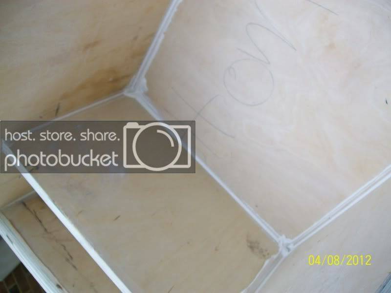

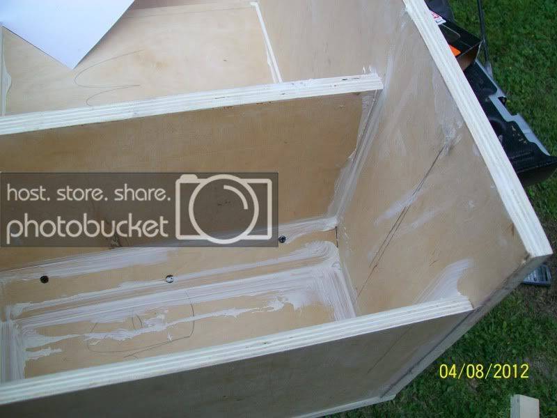

I always make a mess with the sealant/glue. No matter how much I try Ha ha

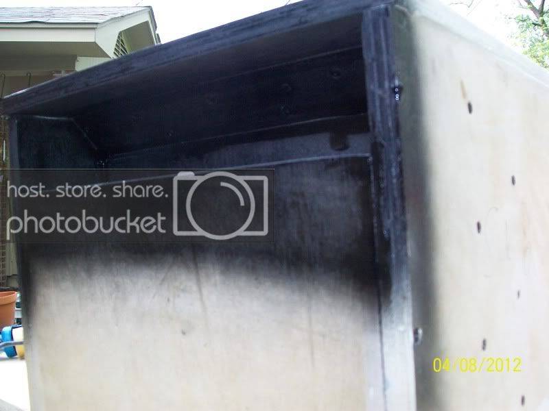

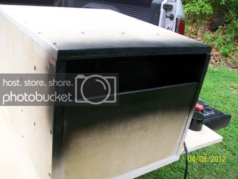

I decided to go ahead and paint the port black even though I haven't decided on a color scheme yet, but i thought I might as well do it while I have the chance!

So you cant walk but you can do all this? Makes me feel really lazy... I had someone else build my box. Mainly because I dont have the tools, but still
Good job it looks clean
