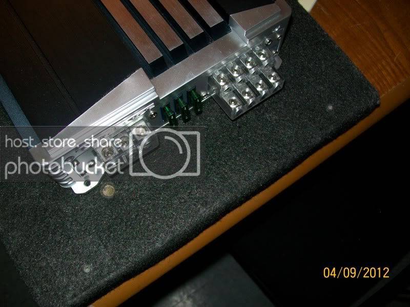

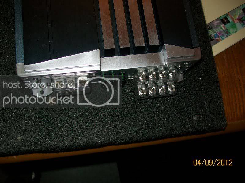

Got a question Fella's! I am preparing to cut the false floor and amp racks and I need some pro help. When I mount the amp and run the wire up through the wood it's mounted on, do I cut the hole first, and then cover? Or do I cover the wood, and then drill through the covering and the wood it's mounted to? Pic v
(This is the old amp rack and not the real one, just using it for a picture reference)
I am trying to make it look as clean as possible, so maybe a pro like @pro\-rabbit can chime in too. The covering is not carpet, it's more like a black denim.
I am still trying to find something that resembles Carbon Fiber, but no luck so far @kushy_dreams so I may have to pass on that idea. I really really liked that idea too
Drill the wholesaler first then wrap it. Use a Sharp blade and a small x cut over the hole. Pull the wire through and then push it back to het the carpet to look right in the hole.
