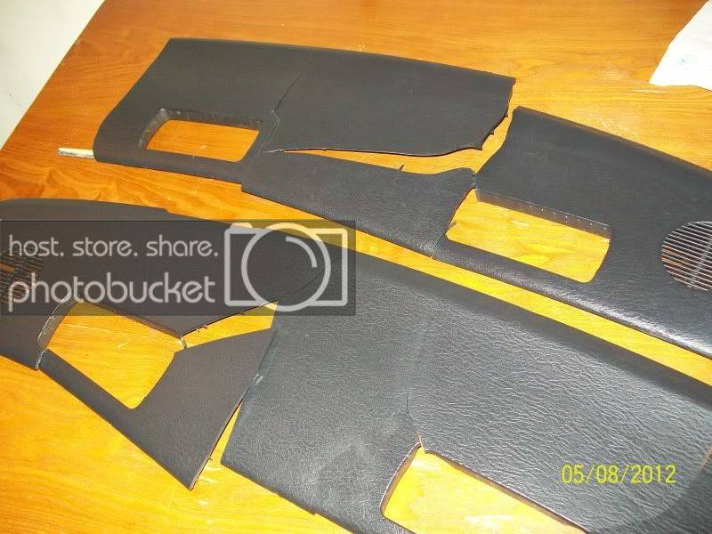

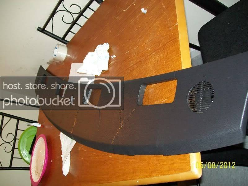

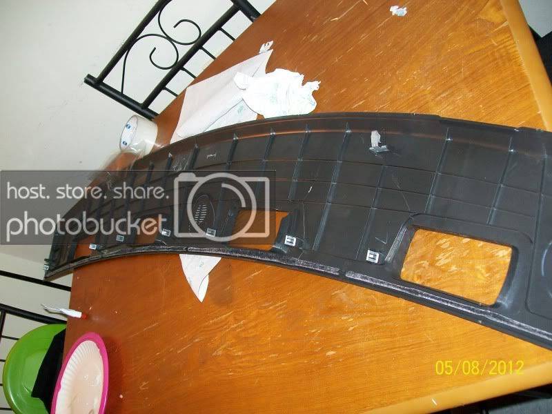

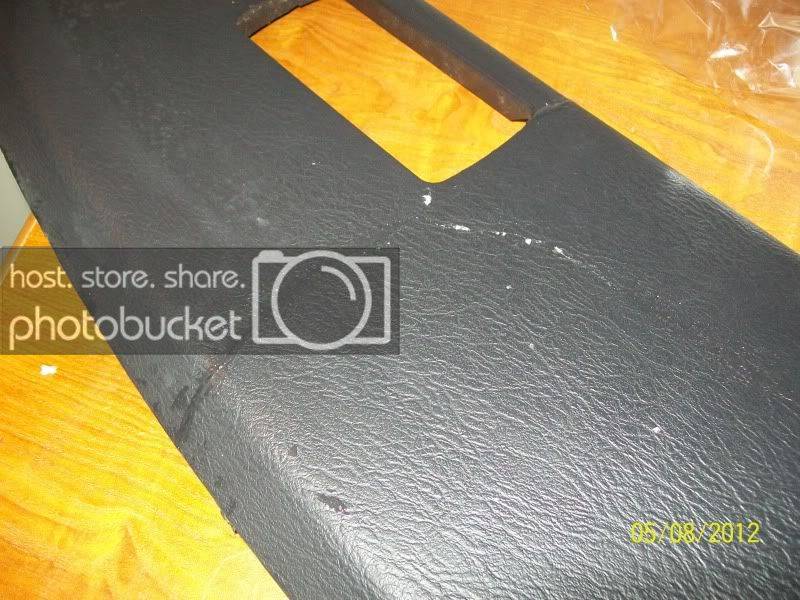

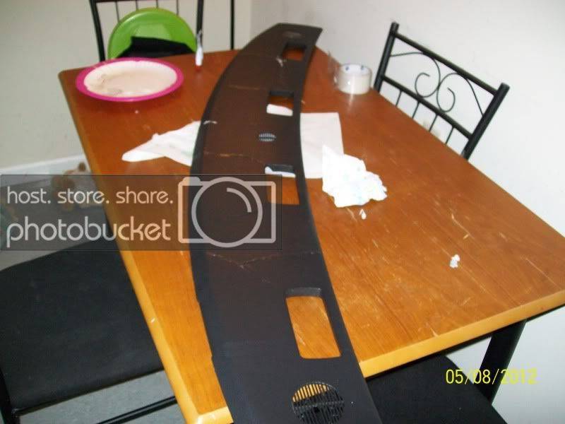

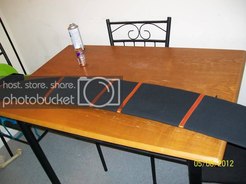

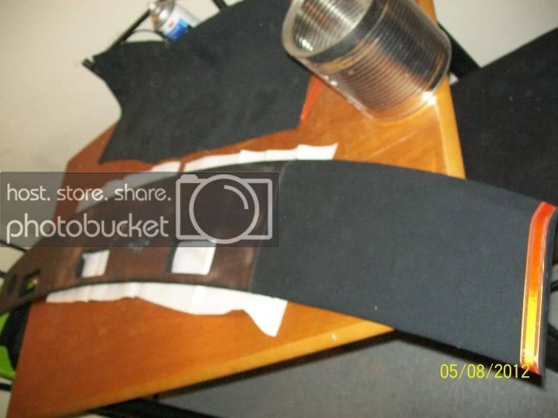

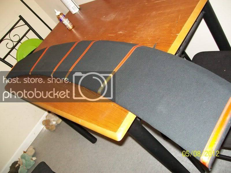

Well, I have been resurrecting my dash. I think all Dodge's like mine have a serious problem with the dash cracking, so I thought of a way to use up some left over denim material I used for my amp rack, and used it for my dash! I hope you like!

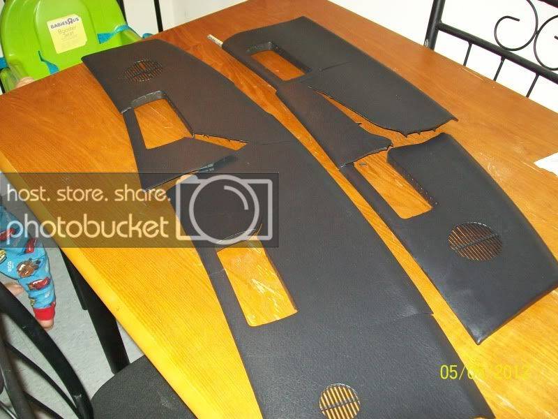

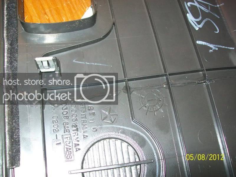

This is how the dash started out. In a million pieces!

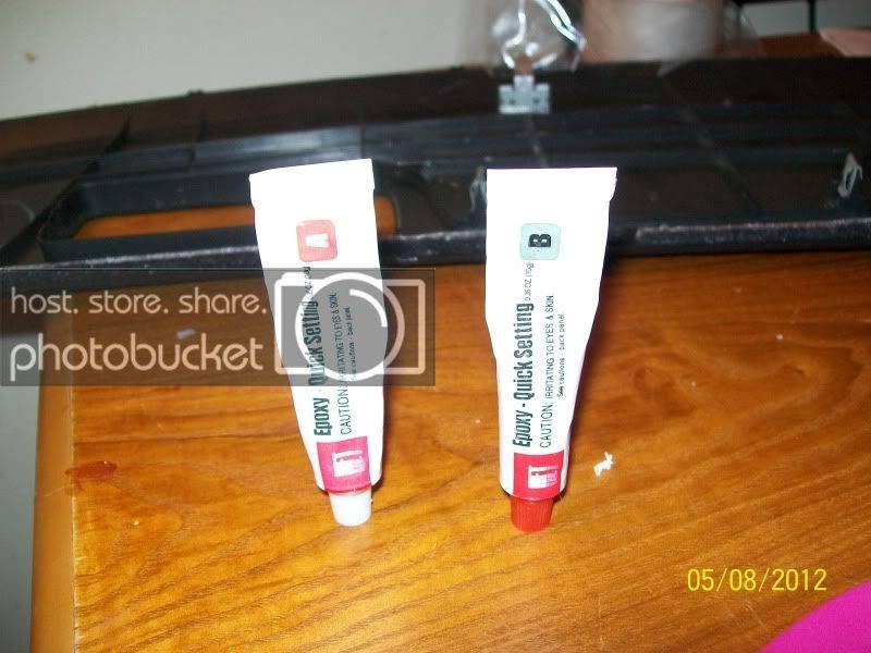

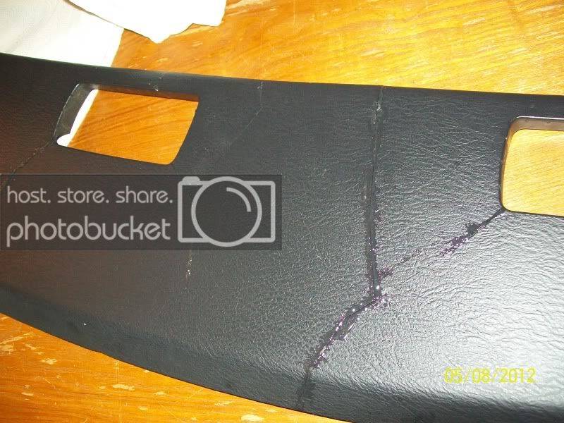

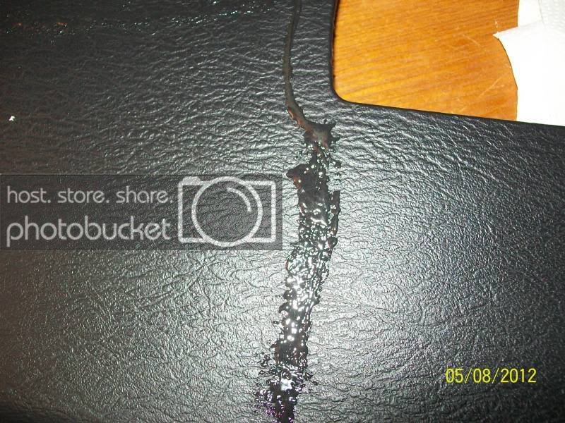

I used a quick setting epoxy to bind all the pieces back together
It's not pretty, hence I was going to have to cover it

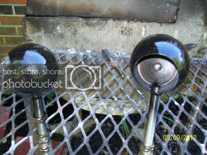

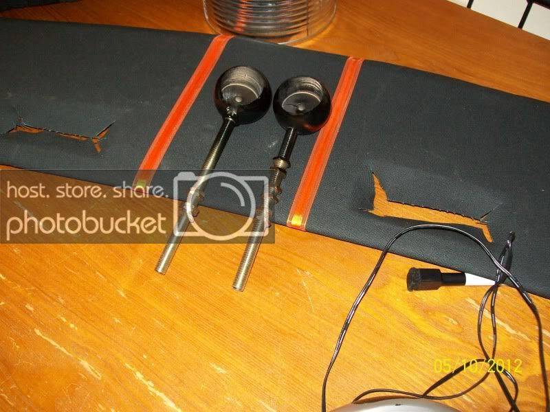

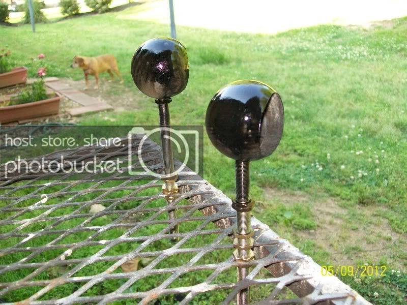

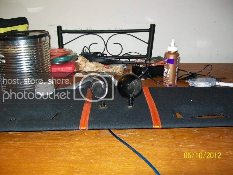

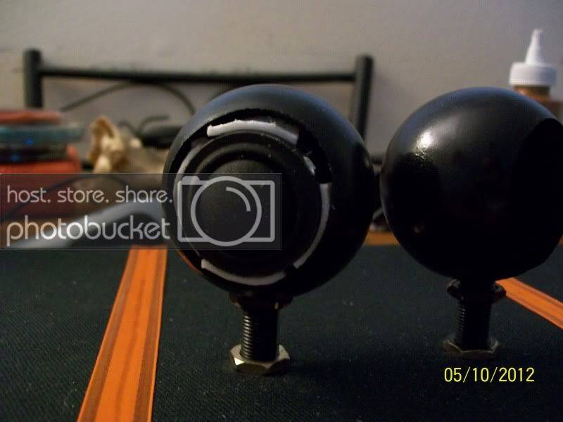

Here are some pics of the tweeter spheres. I need some help too.
I need help with finishing the front of the spheres
I was gonna put a metal grill over the front, but I didn't like how it looked. I need some ideas of things I could use to encircle the outside of the tweeter that would also be inside the diameter of the sphere. Any ideas would be greatly appreciated!!!
