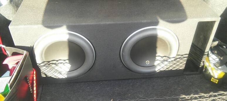

OP, I might also suggest rearranging which direction the subs/ports face and where they sit in his trunk. Some pics of this box might help as well.
Pic is here

That box doesn't look all that bad...but it could very well be too much port area. Who built it?
Awwwwww what's the matter? Don't like to be quoted?
A guy off Craig's list. He built it for 80. Too good to be true maybe?

No, its just built with a different goal in mind vs balanced sound. The box is loud is it not? it was designed for loudness. You'll have to give up some of that loudness for sound quality. Put things in to make the box smaller.

The port isn't to big the box is. You want the port to be able to have high displacemt capabilites. He needs at least 60in^2. I'd tuned slightly lower and go at least 3.25 for both woofers.
Very loud at low bass lines
