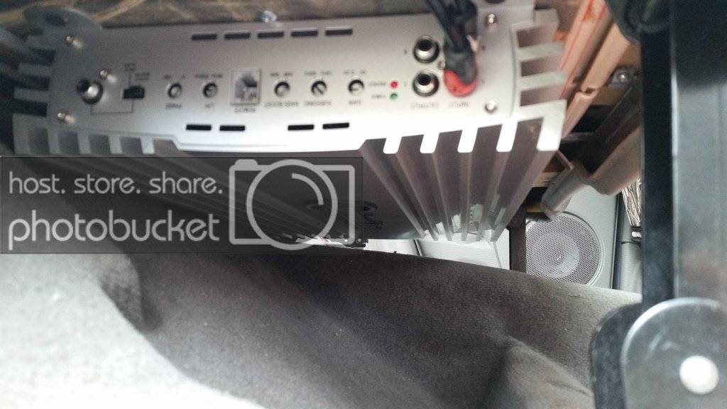

I ran the vfl120 and it was a beast. I asked T-Fade once and he said to set it up like any other 2200w@1ohm. I set my voltage to 46.9v at 1 ohm and never had any issues. I ran at 0.6 after rise all last summer. After about 2.5hrs playing almost full tilt on a trip, I reached back to see how hot it was. I was expecting it to be pretty hot, but the **** thing was barely warm. Stock 160a alt, knu 1/0, xs d3400, and big 3(more like big 5). I mounted mine where it had some room to breathe, which probably helped keep it cool at 0.6ohm. It was too long to let my seat fold down or else I'd still have it.
