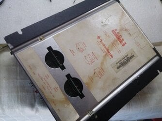

Attached photo of the old school Rockford Fosgate 4600X amplifier which give you the option to use the high level speaker inputs between the RCA inputs but this amp is so dated but had great sound quality as a 'series 1' entry level amplifier.
