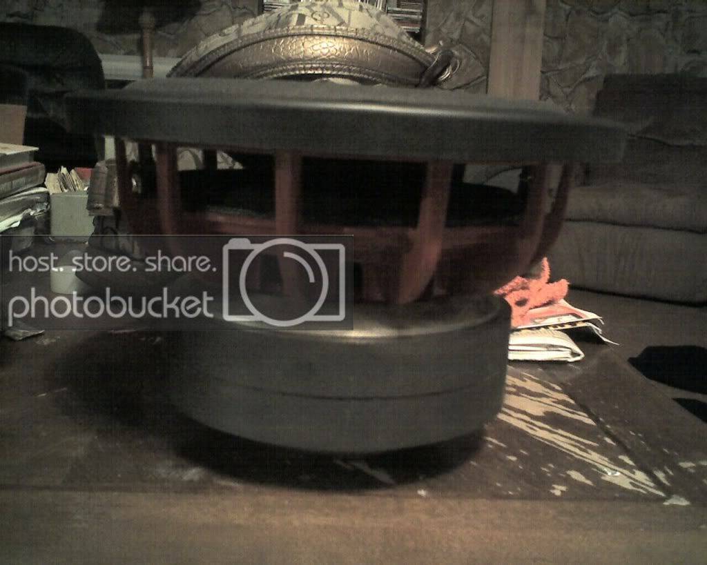

Ok guys. Long story short I picked up two jl 10w7s for 20 bucks each here locally. Coils spiders and cones are all fine. The surround is dry rotted beyond repair. Iv cut it off the cones and cleaned them up. Iv though about finding a taller more narrow surround and mounting it on the inside of the basket landing like a normal sub instead of jls gay wrap around mounting option.
my next question is if that doesnt work or throws off the t/s parameters so bad to where they sound like krap what could I do for a recone.
Iv read about people retapping 12spoke baskets to fit the motor. Only problem with the 10 is that it has a weird coil size. (2.75") Now my coils are perfectly fine.
Does retapping baskets and using the standard coils with new soft parts sound feasible to you guys or what?

Also pics and vids for interest
10w7

Wow what a deal. The W7 isn't a bad sub at all, fairly well rounded. Just fix the surrounds and sell me one for cheap //content.invisioncic.com/y282845/emoticons/biggrin.gif.d71a5d36fcbab170f2364c9f2e3946cb.gif
lol if i use them there going into a small 4th order blow through in my 88 s10. lol 8s are out would probley do them as 12s or mill the top plate and bore the crap out of them and make some badssa 15s out of them. btw mini belongs to a buddy of mine. 2 18" re mts and a sundown 3k at .5 ohms walled.
also Id rather use them as paper weight than give monies to jl. I would rebuild these from ground up for less than 100 each and make them louder.
