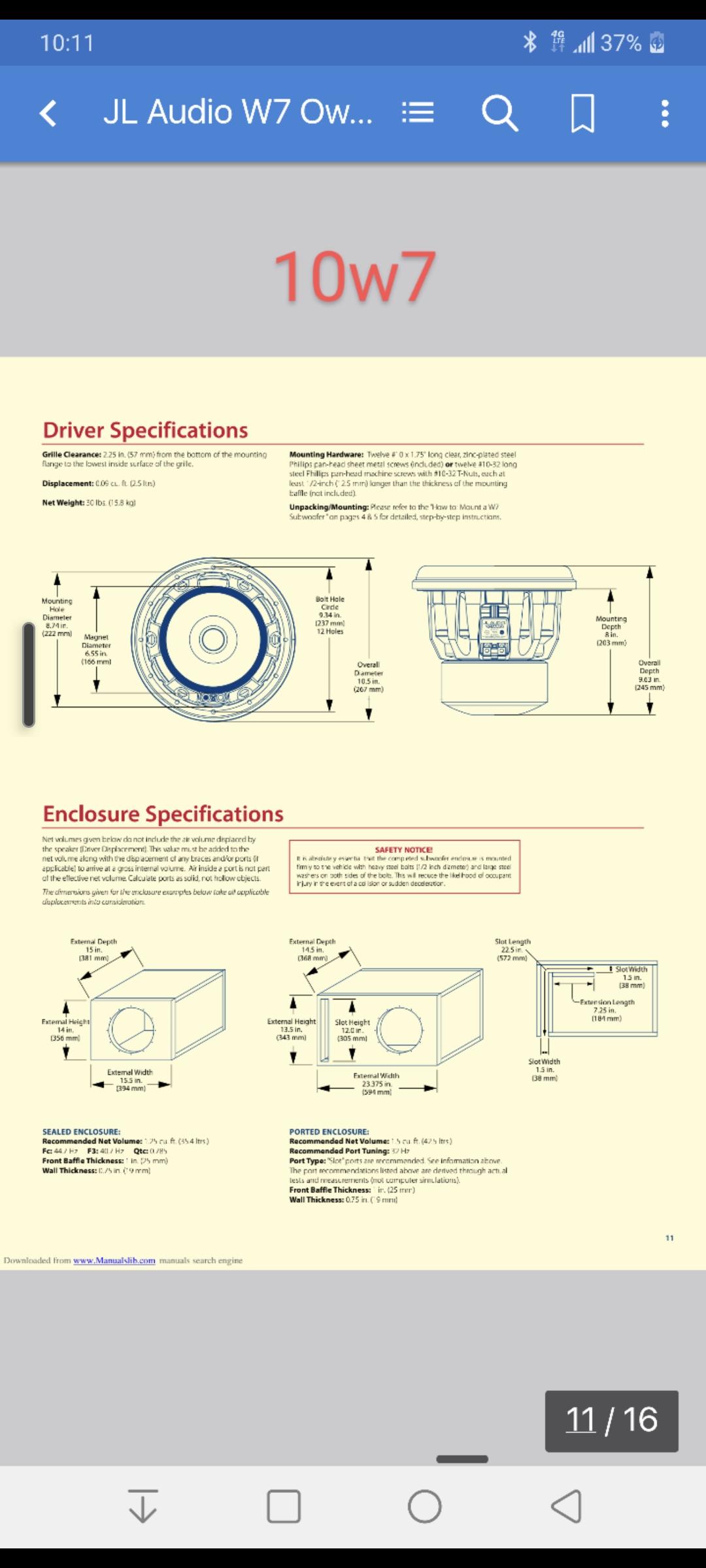

Has anyone ever put a 10 w7 under the seat of a F150? Is it even possible? I have 2 that's sitting in a closet and been there for YEARS. I'd love to get a box built to spec and use them but idk if it's been done before and I can't seem to find any pics or videos. Ive seen 8w7's but never a 10. I know I would need a lift kit. But will another 2.5 inches be enough space for those?

As long as the baffle is 11" high you will be good. The gross exterior volume difference between sealed and ported is 0.75ft³.
