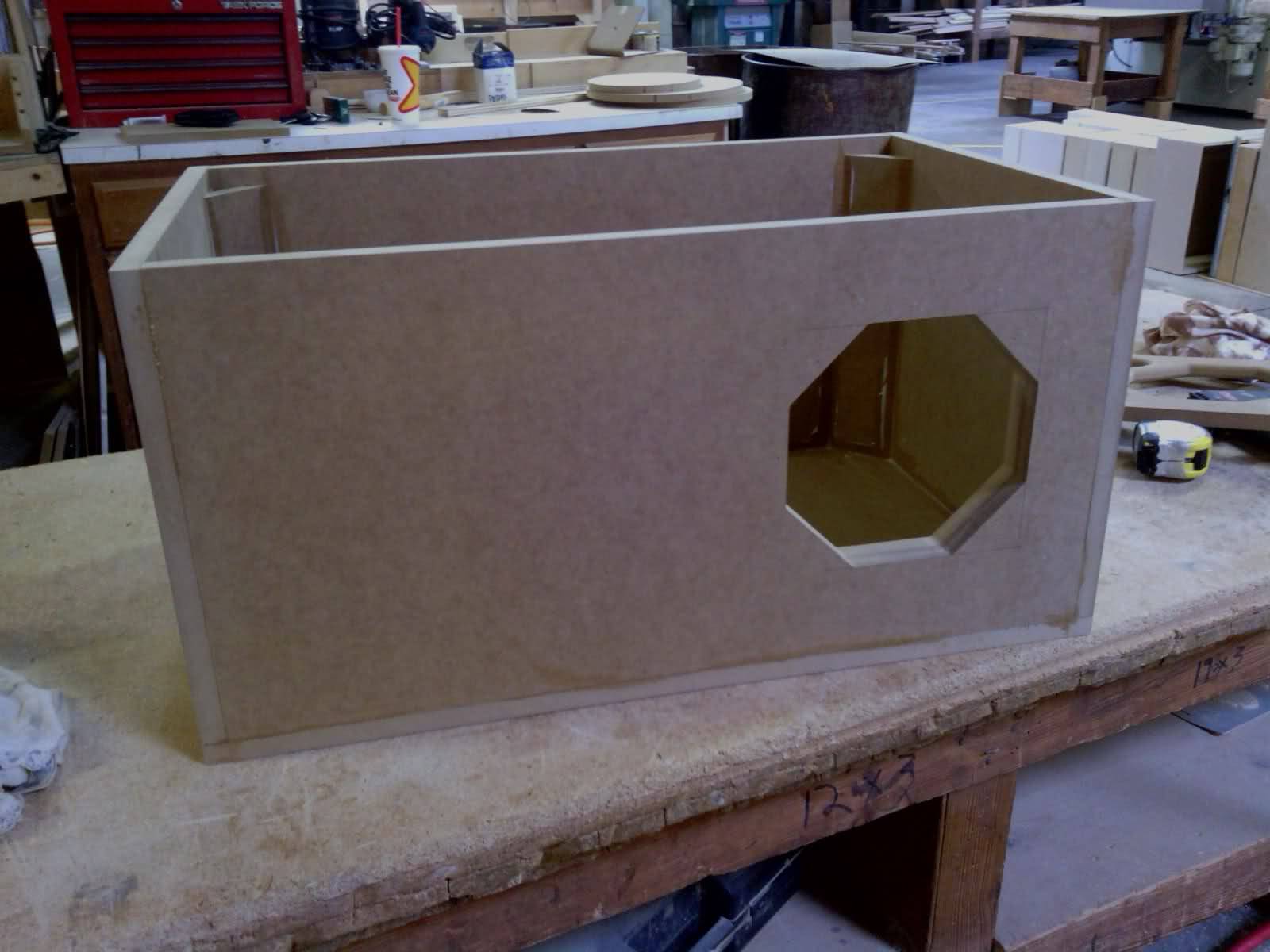

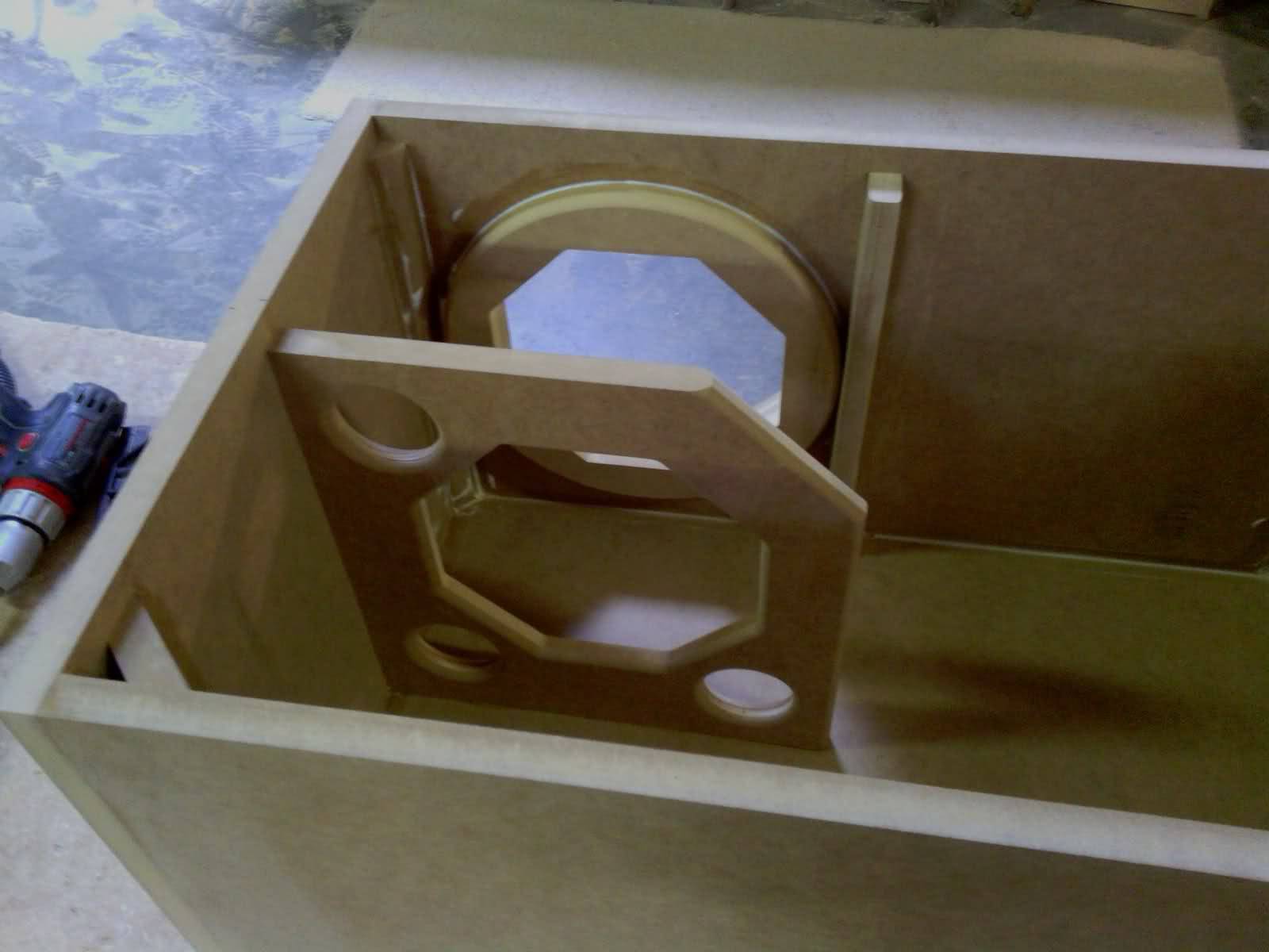

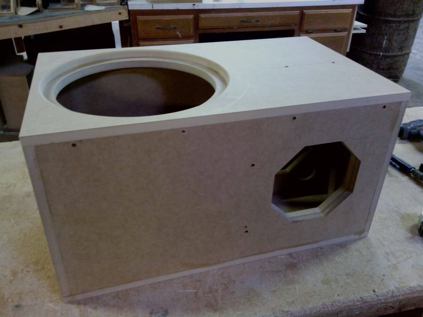

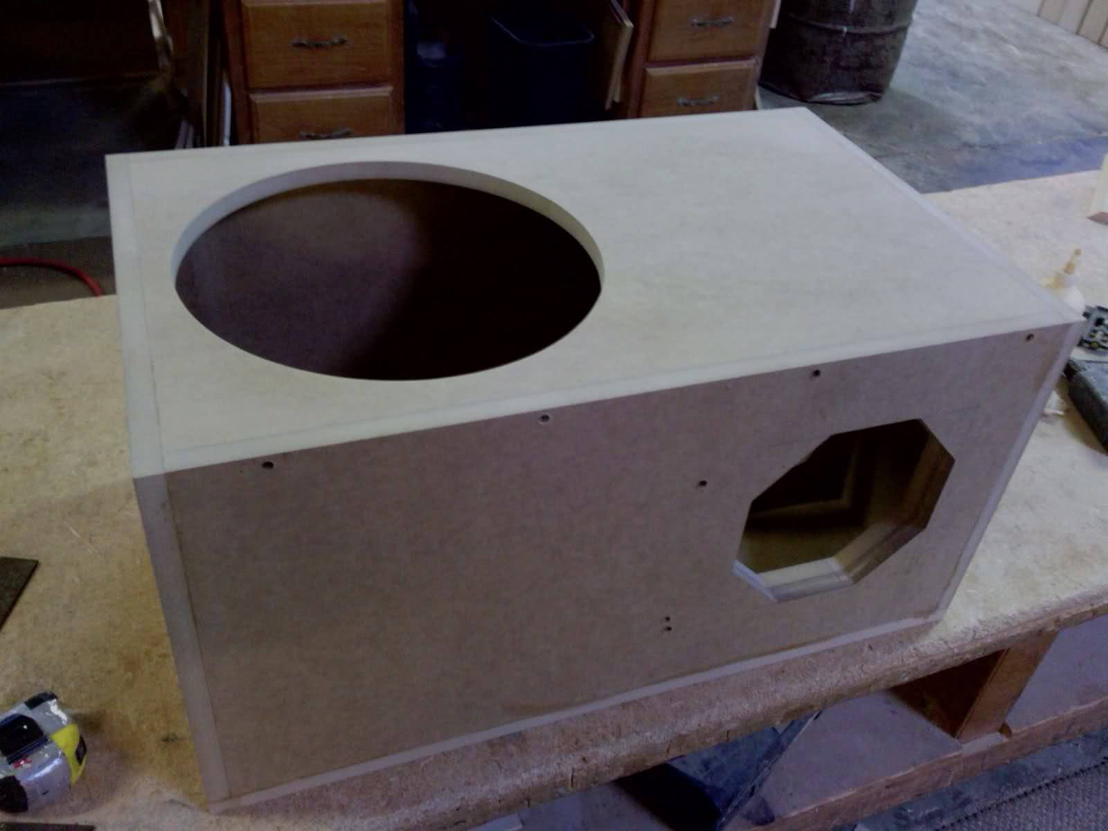

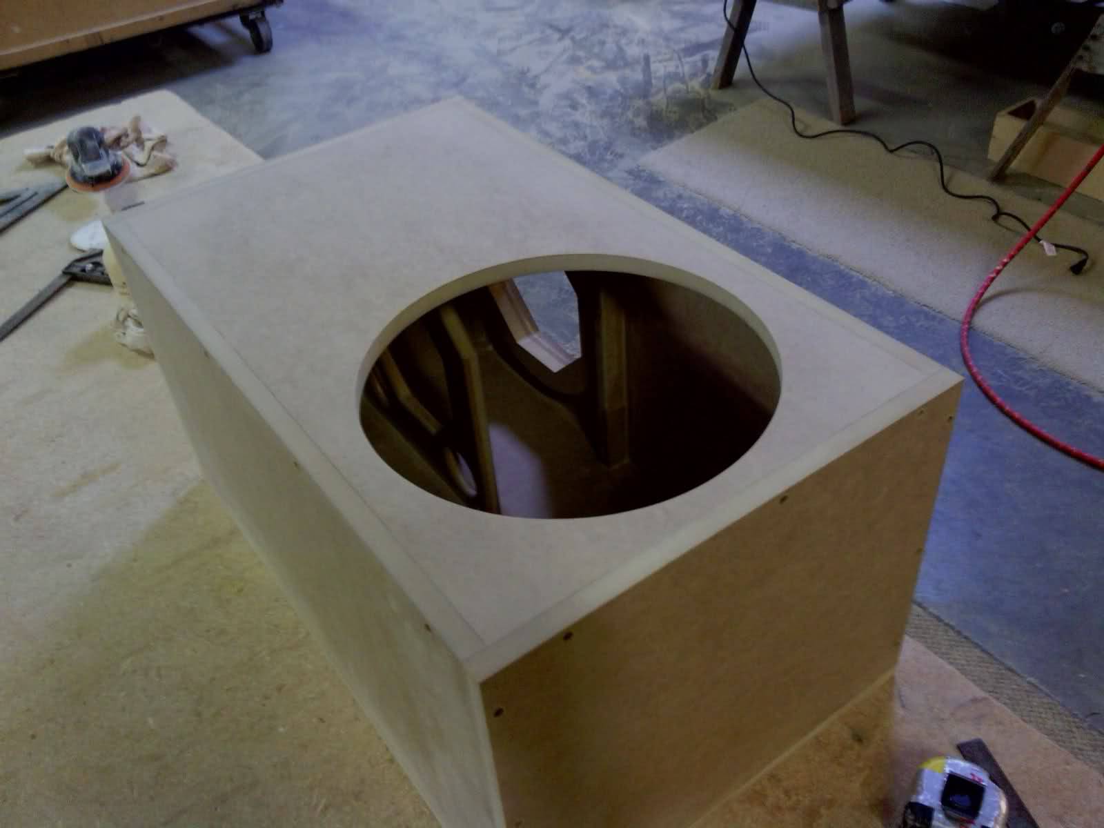

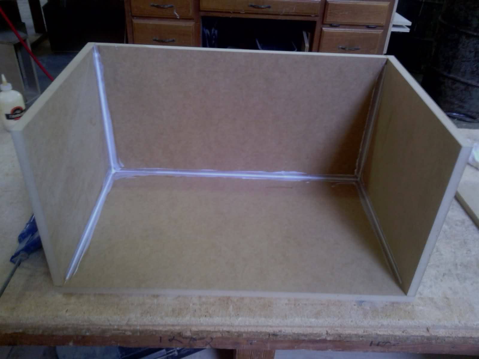

I'm building a new box, and will be experimenting with removable octagon ports.
The box will be 3.5ft^3 for one 15" Rockford Fosgate T215D2
I'll start with 3 different ports.
One with 33hz tuning, one with 38hz tuning and the last with 42hz tuning.
Here's some pics.

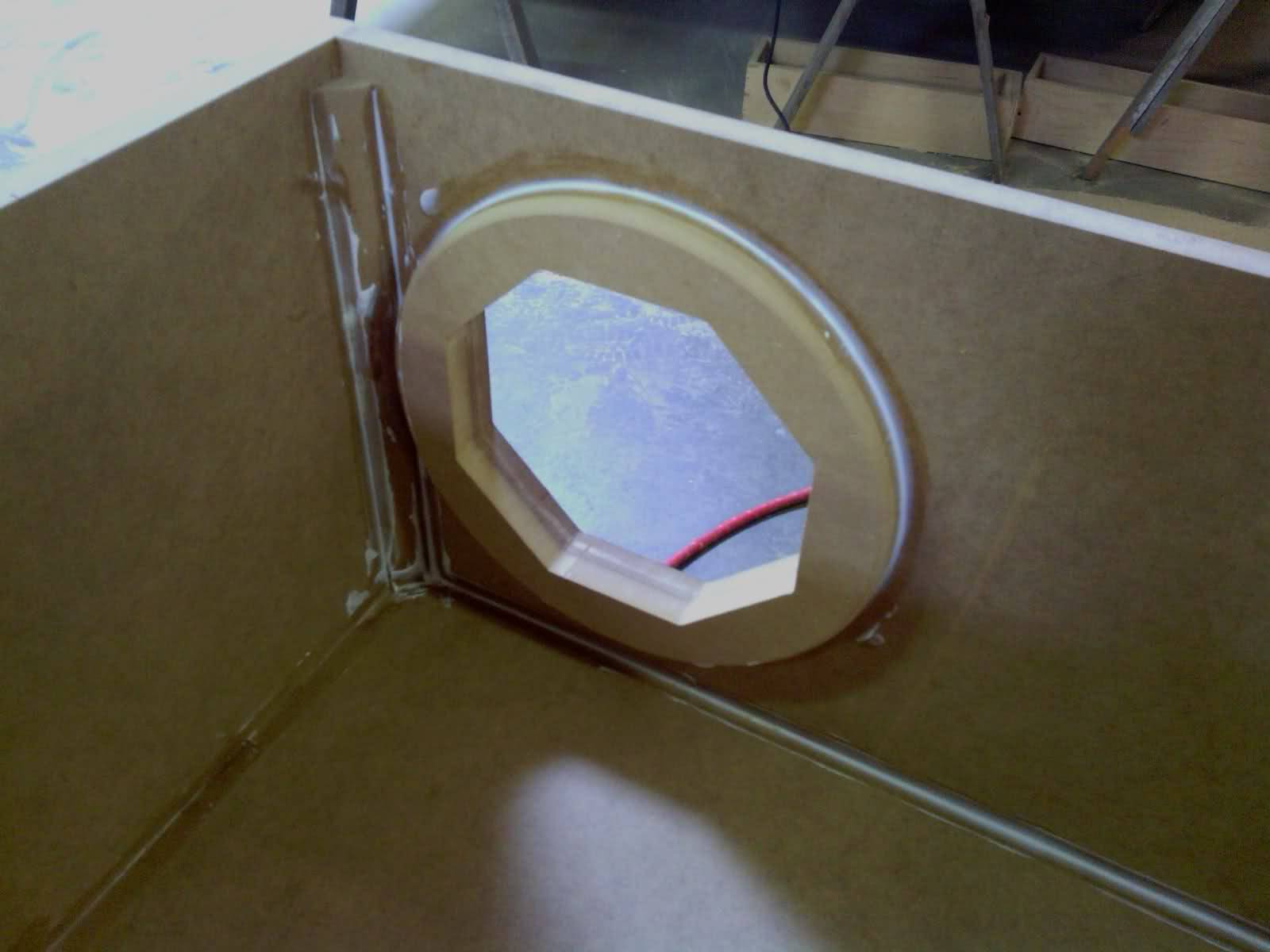

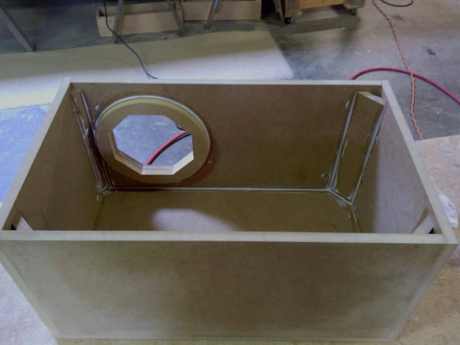

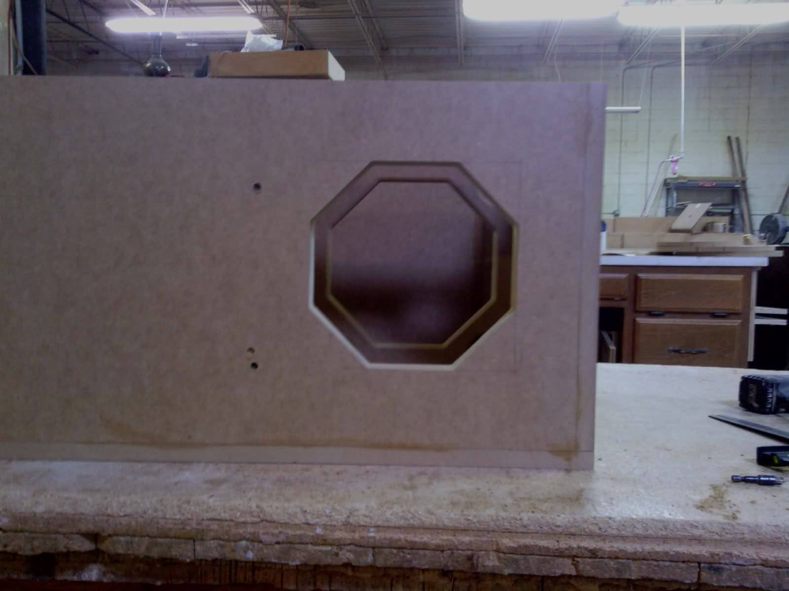

That was fast. What's the port area going to be with 3.5 cubes? 9ish?
I can go back as far as 10 5/8"....that would be tight to the box and tuned to 42hz
I'm building 3 ports. The 42hz, one at 38hz will be 14 1/8" and hang past the box 3 1/2"
Th 33hz port will be 20 3/8" and hang past 9 3/4"

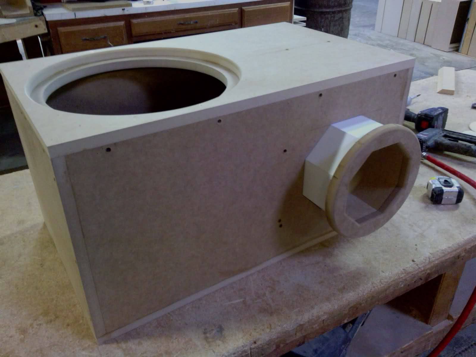

Easy to change?

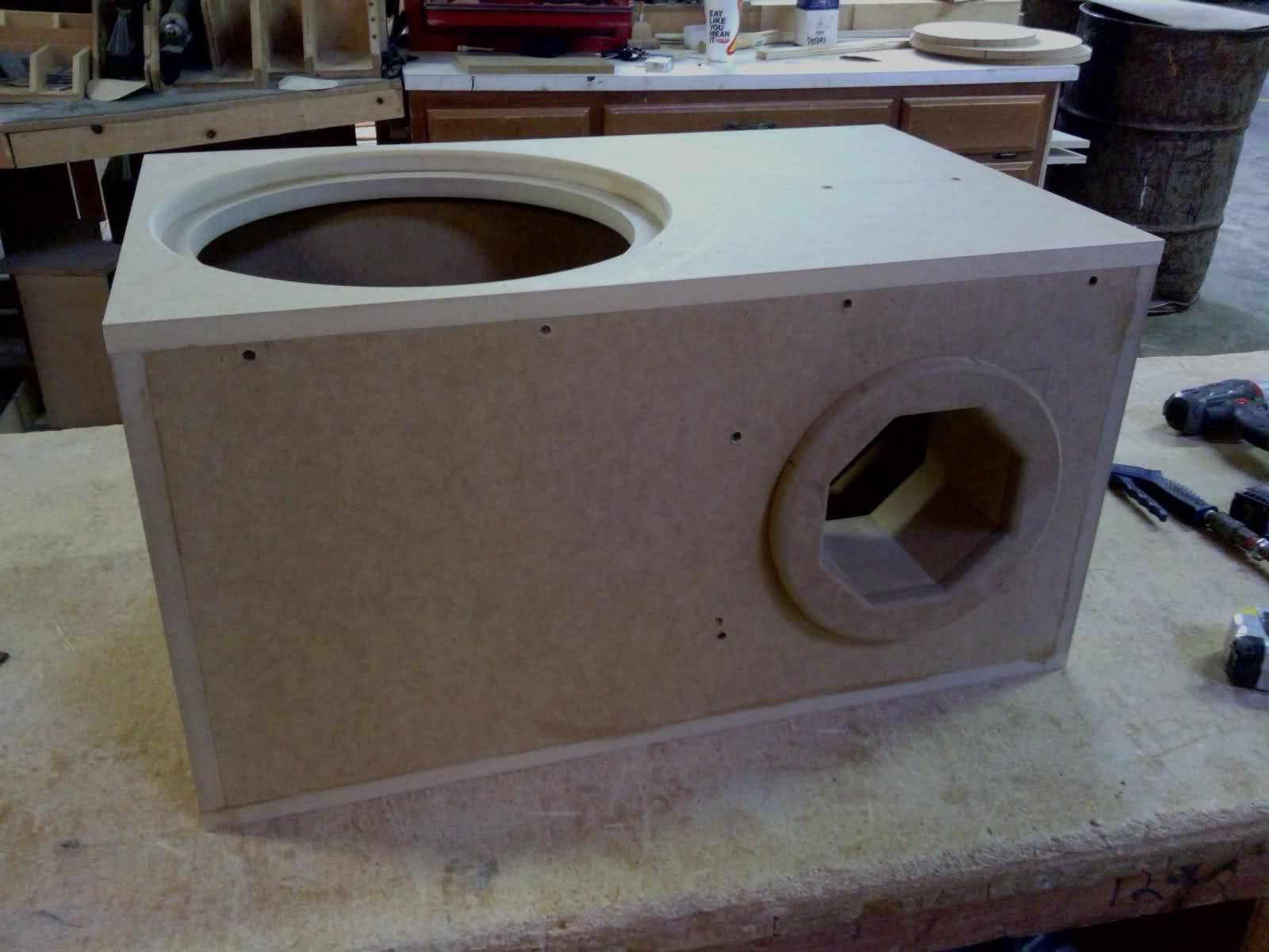

I think it will be...This prototype port fits virgin tight!
I'll probably make the plate/flange a little larger so I can screw it to the box.
The longer ports will have a plate attached to keep them 6 3/4" off the back wall.
I'll put weather stripping behind the plates to keep it air tight.
I think it will be...This prototype port fits virgin tight!I'll probably make the plate/flange a little larger so I can screw it to the box.
