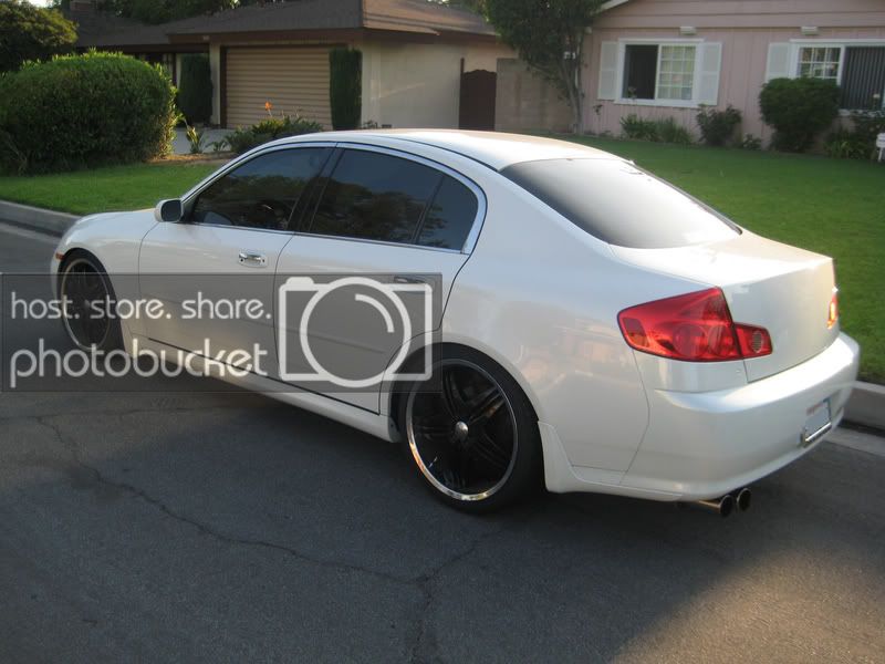

Just a little teaser till I get better more and better pics. Car is dirty right now and I actually will finish painting my emblems. Turns out I just needed to let them dry a bit longer before painting over them.
Here's the ride sitting on Falken 245/35/20's all around and Tein Basic coilovers. The drop is significant. Barely enough room to get a finger in the front and impossible to a finger in the rear, maybe if an infant were to try to they might be able to. No rubbing thus far and I dont have the fear of going over bumps or potholes as I used to. I'm loving it so far.
