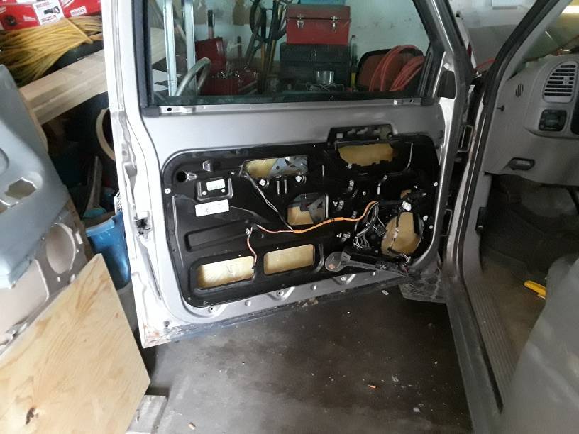

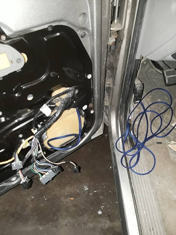

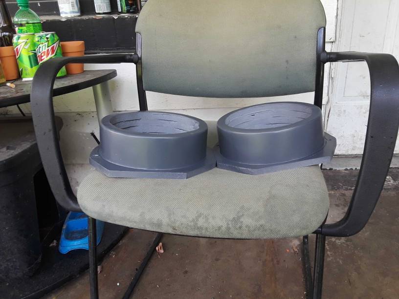

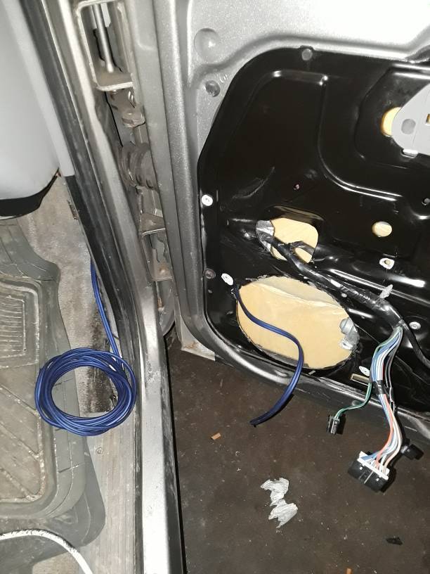

Got a little more done today getting pretty close to having these doors wrapped up finally. Got the adapters I made resined and some body filler on them. should be ready to sand and paint now. also got the sound absorption in, and speaker wire ran through the door. everything is put back together up to the door card, and I got the wiring harness loose so it's ready for deadener. Hopefully next time I'll be able to get the door card deadened, all the access hole sealed up, and the speaker adapters mounted. then I should have to do is put the door panel back on, and figure out what I'm going to do with the tweeters. after that it's time for the fun stuff, and I will be demoing the interior!

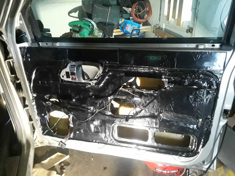

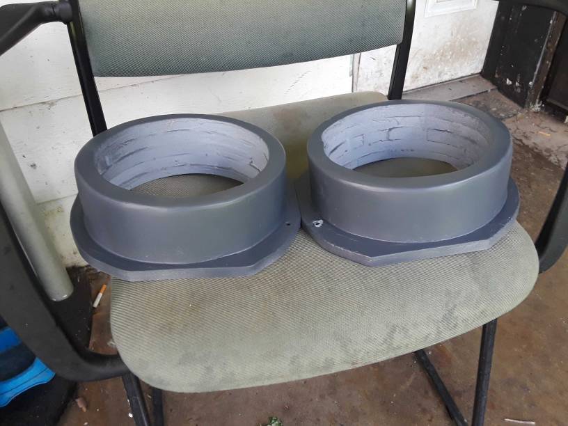

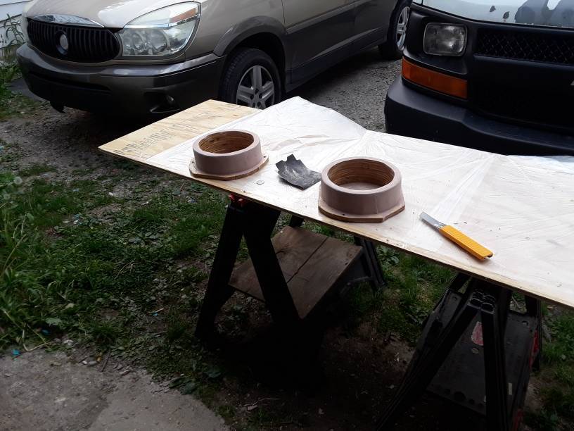

Not a whole lot done, but I am starting now and have the rest of the weekend so hopefully I will have some more pics by Sunday night. since last time I got the speaker adapters completely finished, and a start on the deadener. I didn't want to put too much effort into the adapters because they will be completely covered once I get the trim piece fiberglassed, but I'm not going to do that until after everything else is done, so they will show temporarily. anyways here's a few pics, more to come

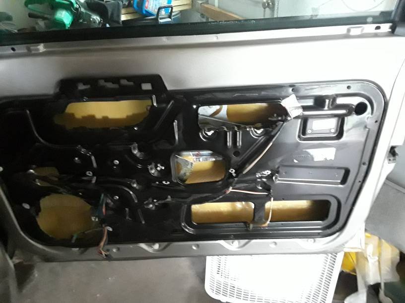

Oh ya op one more place to seal up is the vent under the door latch and I also put insulation in a bag and stuffed into accordion boot in jam around speaker wires too . Sometimes I get a little carried away but I actually don’t think you can in doors.

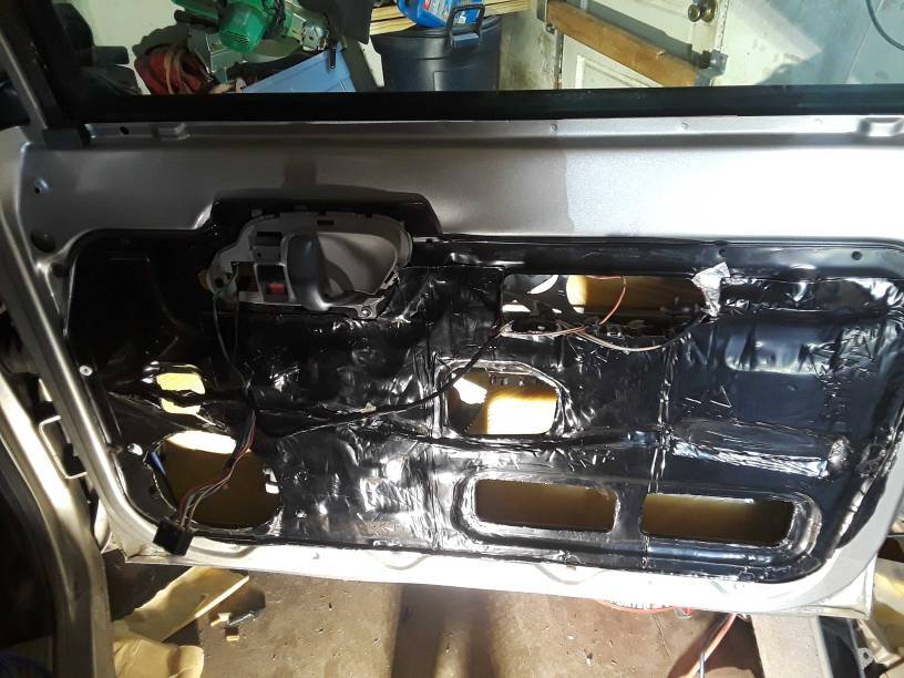

Just finished with the passenger door deadener about to start on the driver. good call on the accordion boot and vent under the door latch, i didn't even think about either. Looking at it now my truck doesn't have a vent, just the plastic access panel, but I will deaden and seal it with some C. C. F. Hopefully I can get all deadener done today then seal all access holes, and panels tomorrow. I would love to get these doors wrapped up this weekend and move on to guttin in the interior.
