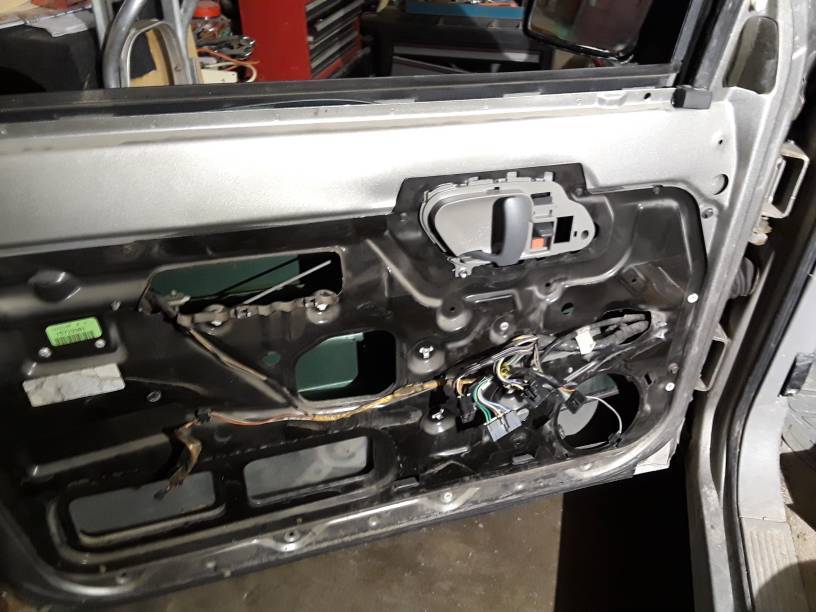

That's everything that I can think of that I already have ready to be installed. I started tonight and pulled the driver door panel apart. It is going to be a mother f****** b**** to get these eight in these doors. Hopefully the baffle will bump it out enough, but then I have to worry about it hitting the door panel. Not a ton of room back there. May have to cut the door panel and make a fake Grill to make it work. We'll see though. Still have a lot of sound deadening and other stuff to do, just trying to get a game plan together for now. Hopefully by Sunday I'll have something done and be able to throw up some pics..maybe throw a few of tomorrow just of the truck and getting started and s***.

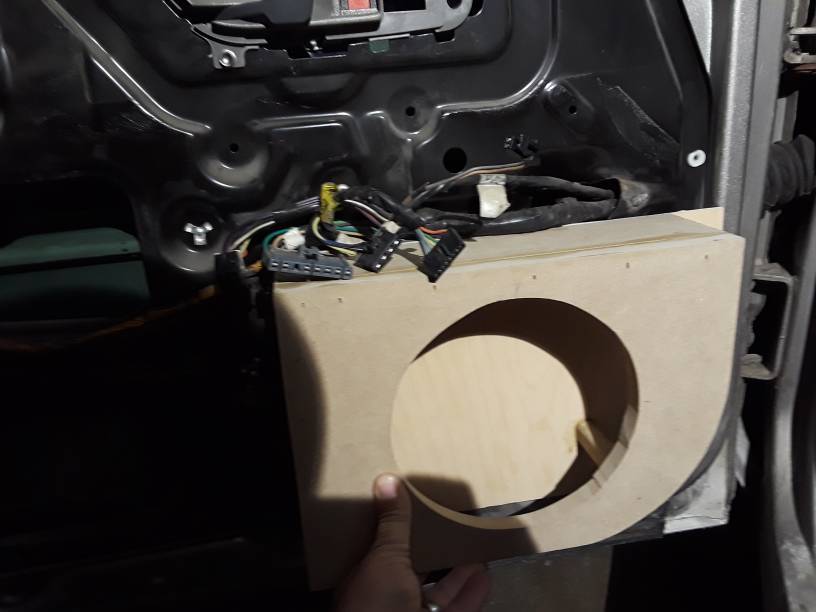

Man I'm sorry to hear about that, but I'm definitely glad you're on the mend now. if you built that box that looks every bit as good as the one I built, your definitely not a hack bro. actually I'm trying to figure out how I'm going to mount the speakers in the front doors now. definitely going to be harder than I thought. There's not as much room as I initially thought in there, plus there is a window motor or something mounted right next to the factory 6.25 hole. I'm hoping I can cut it in the other direction but the panel gets narrower that way. so I'm debating now whether or not I'm just going to build it out however far I have to, and then cut a hole in the plastic door panel that's bigger than the speaker and make some kind of Grill. or Mount the speaker to the plastic door panel and fill in the distance between the interior metal panel in the plastic panel and then still make some type of Grill.

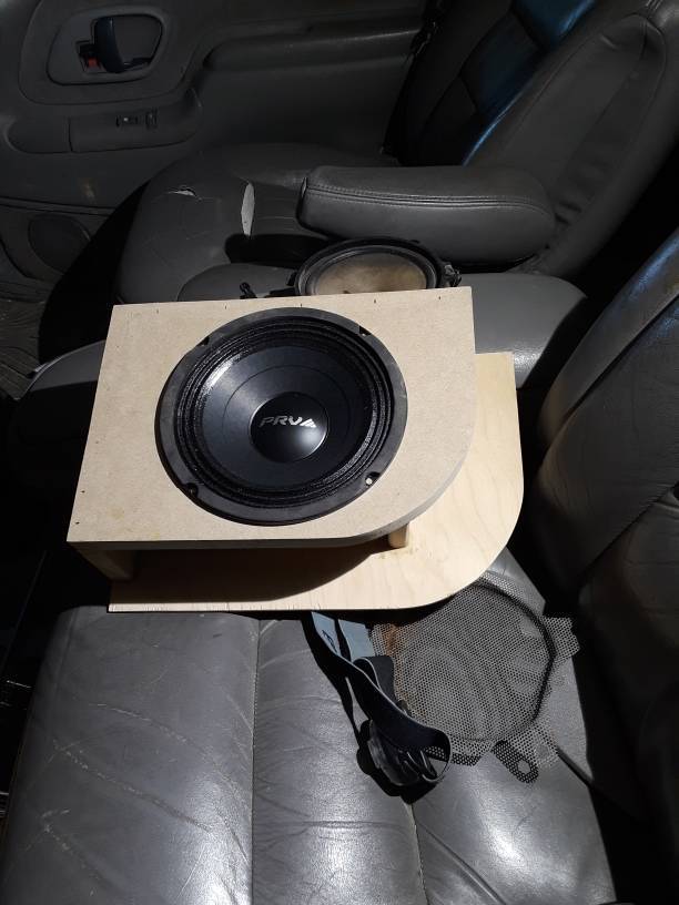

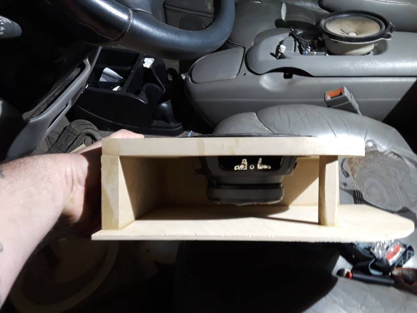

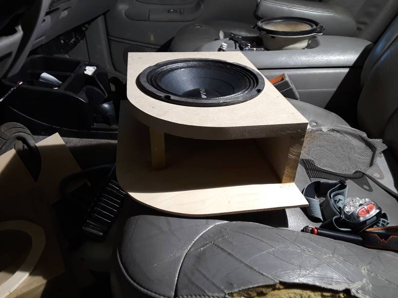

Alright so I made a little bit of progress this weekend, had some other stuff to take care of, so not as much as I would have liked, but at least I got something done. Got the driver's door tore apart, and started on some type of speaker pods, or whatever you want to call them. basically an MDF box that the plastic door panel will be notched around. got box or pod, whatever you want to call it, built for front driver and passenger door, still have to do a little bit of fiberglass to make the angles easier. hopefully can get that done today, and the passenger door tore apart. now here is where I need your guy's opinion, to me these boxes seem kind of small for an 8. even though I know it's not a sub, and when youtubing door pods a lot of people were running their mids in a lot smaller area. I don't know really, this is all new to me, and I am just kind of winging it. will probably add some polyfill since it's a sealed box, but if it is way too small I could still cut a hole through the back of the box and "vent" it into the door. although there's not a lot of room the hole or "vent" would probably be 6 or 7 in at the most, and would be directly behind the speaker, but would open it up to the entire inside of the door panel. another thing is if I don't need to vent it into the door how seriously should I take sound deadening and sealing off the door cavity, as the speaker will be in a stand-alone box at that point. if I could save a little deadener and some time, maybe worth it to use the resources elsewhere in the build, but will gladly do it if you guys think it will increase performance, or sound quality just let me know.
