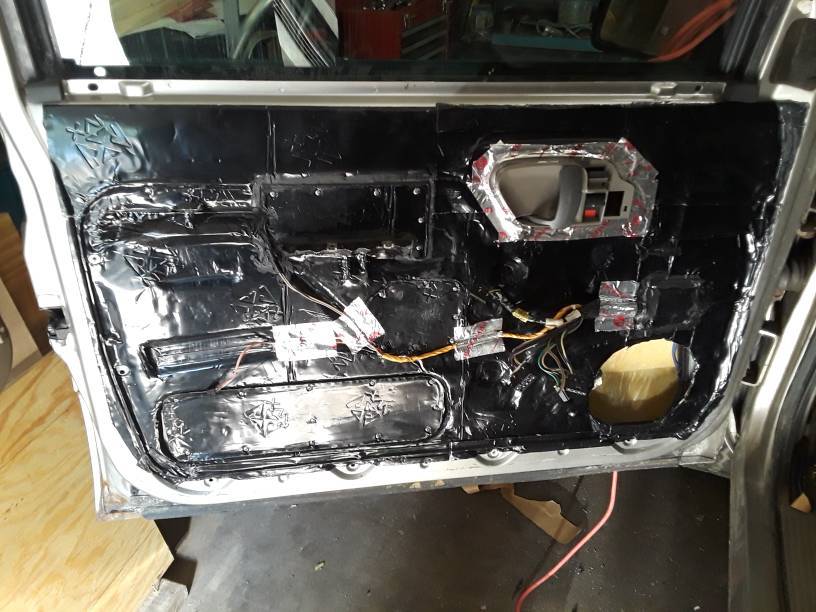

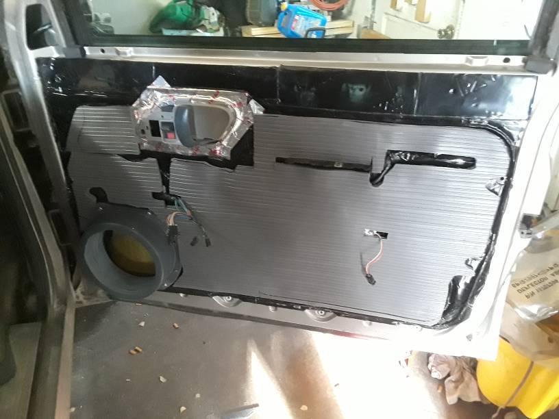

Driver door is deadened, and that's it for me tonight. first thing tomorrow I will be making panels with quarter inch Birch and a layer of deadener on each side with CCF gaskets to seal off all the access holes, and hopefully buttoning up everything else on the front doors.

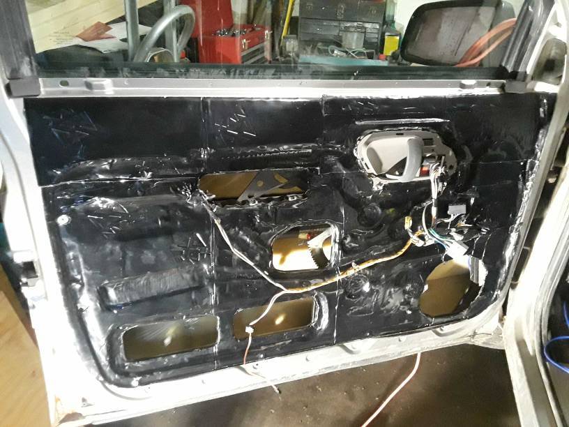

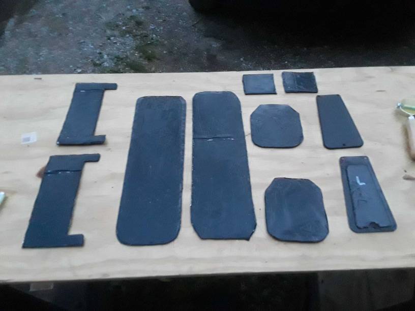

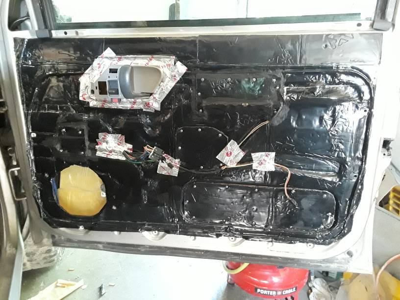

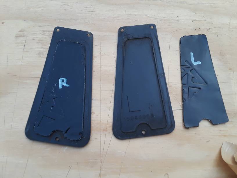

Well I didn't get as much done as I wanted to today, but I did get all the access hole covers fabricated and sealed with deadener on both sides. also I took the access panel under the door latches off cleaned them up, and put a layer of deadener on the back. was going to do the front and back but after thinking about it I think I'm just going to go with deadener on the back and a fresh CCF seal, because I feel like the deadener on the front will just get destroyed by the door opening and closing, but if I decide I do need it I can add it later no big deal. Man I really severely underestimated the time it was going to take to do these doors. So far I probably have roughly 35 to 40 hours tied up in them, and about 25 square feet of sound deadener, and probably close to 16 square feet of sound absorption made from ceiling tiles wrapped in plastic. Not to mention wood, screws, glue, fiberglass, Bondo, primer, and Plasti Dip for the speaker adapters. definitely a ton of work. at this point I feel like if this s*** don't sound phenomenal I am probably going to light this b**** on fire. Hopefully I can get off early sometime this week and get all these panels foamed, and mounted along with the speaker adapters. we'll see how it goes though. it's definitely crunch time with slamology only a couple weeks away, even though I don't plan on competing or anything, would still like to take my truck there. if not it is what it is there's always next year. Oh I almost forgot I wanted to mention that in my last post I said I was going to use quarter inch Birch for the access panels but at the last minute I decided to go with sheet metal instead because the Birch plus two layers of dead in her seems like it would just be too thick in some places.

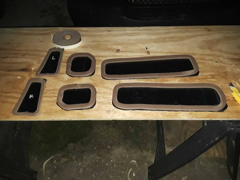

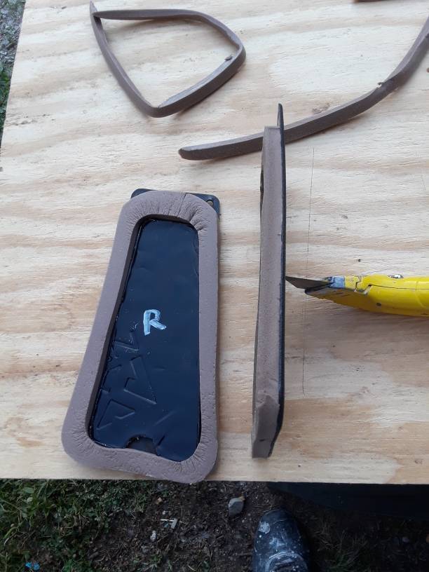

Was able to get a little bit of time today and got some gaskets on the access panels I made. I know it's a baby step but it's better than nothing. the other access panels I will probably have to silicone unfortunately because the shape is just too odd, and even though the panel's I made cover the hole the bumps and texture in the door still create some pretty decent gaps, that I just don't feel like foam is sufficient for. anyway here's a couple quick pics for ya

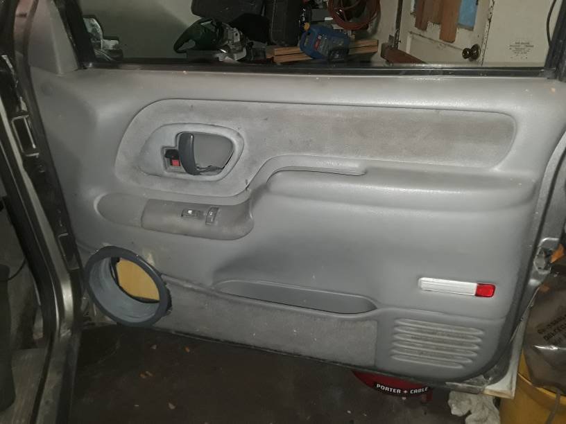

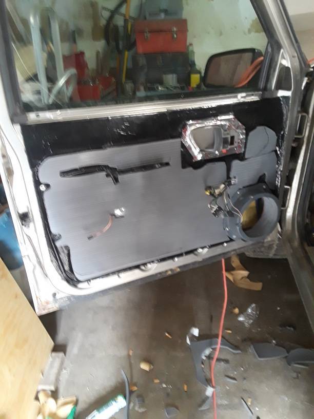

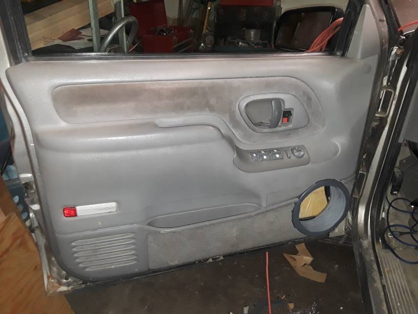

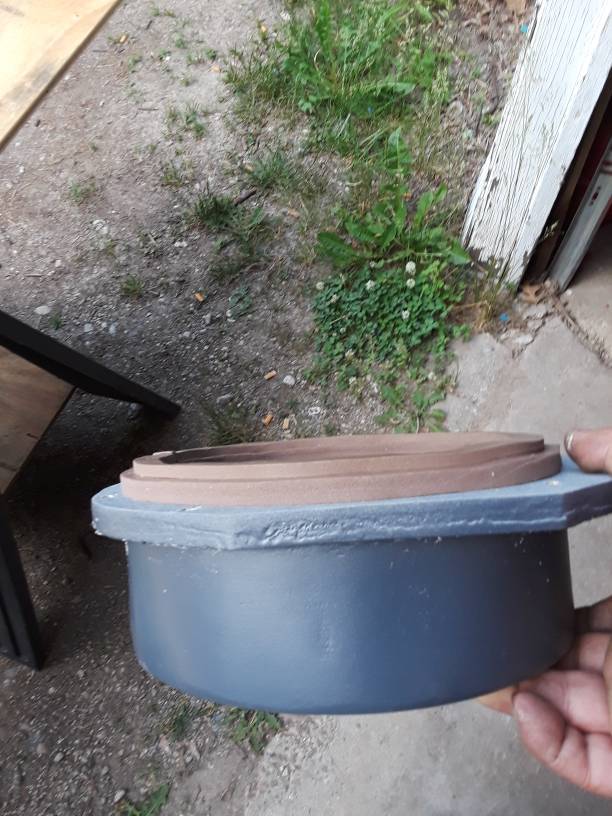

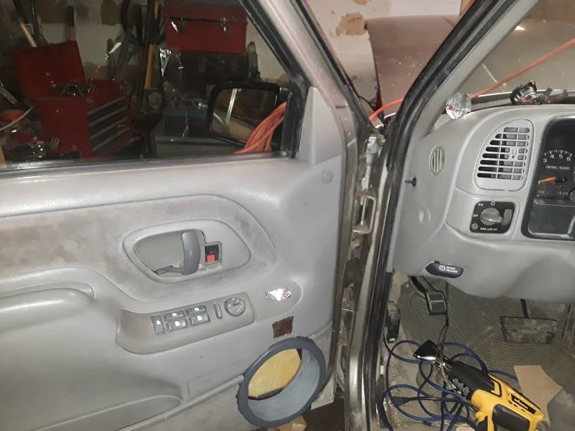

Finally, made some real progress. The doors are completely wrapped up, for now. Unfortunately I will have to pull the door panels back off in a couple weeks to put new mirrors on the truck, and change the lightbulbs, but I needed to make sure that the door panels would fit over the CCF, and that the cutouts for my speaker adapters lined up properly. Also when I pull the panels next time I will put some temporary trim around the speaker adapters, where I cut the panel, to hide the ugliness of it, until I fiberglass up the permanent trim pieces. Can't tell you how happy I am to be at this point though, finally feels like tomorrow is actually a new day, and I will be pulling the front seats out and running some more wire to the back for speakers, RCA, remote, voltmeter, and such. I've already got two runs of stinger pro series 0 gauge running to the back, and we'll be adding two runs of ground as well, but that will be done after the interior is back in, and they will be ran under the car. Anyway here's some pics.

Not going to mount the speakers until after the seats go back in to avoid any accidental damage. I also wanted to ask anybody who might be looking at this what your opinion is on where the Tweeter should go, in this last picture I marked the three places that would be the easiest to install with metal tape. If they go in the door, in either location, I should be able to flush-mount the tweeters which is what I really want no matter where they go. If the a-pillar is the best option then it will be surface mounted until after the build is done, then I will fiberglass up some Tweeter pods so they can be flush mounted. If none of these three spots look good feel free to throw out any other opinions. thanks in advance for any opinions or advice.
