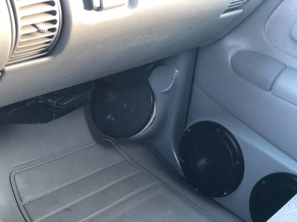

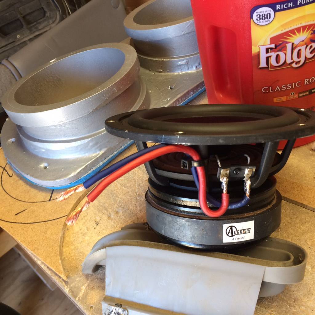

No cover goes over pvc and speakers mount sandwiching fiberglass between speaker and pvc because I wanted grills to mount via the speaker mounting screws , does that make sense ? Screw goes through grill, speaker, fiberglass and into pvc and the coupler ring is on there to make pvc the correct diameter to fit speaker screw circle ? Now if you were a lathe machinists kinda guy I bet you could turn out some nicer pieces but that ain’t me lol

Check here for dimensions and see if it will work an remember different schedules 20 thin wall 40 std thickness 80 really thick walled so if dimensions are not here just google and find the thickness that will work for you. Couplers and other fittings fit over outside so you can cut rings off of them to make a flange to screw speakers too. Then buy it on eBay if you have non around you

Huh ? Flare on coupler ? You mean the interference fit ? I used 6 “ pipe and cut a couple 1/2 rings off a coupler like this and glued them to the top of pipe to make a flange for speaker to screw down too and bottom to give glue more area to grip onto the wood panels but since these are bigger diameter than the pipe to fit outside of pipe they may work for you instead of pipe itself ? Depends on mounting diameter of speaker. I got lucky if fit perfectly on the Anarchy’s in 6 “ pvc
