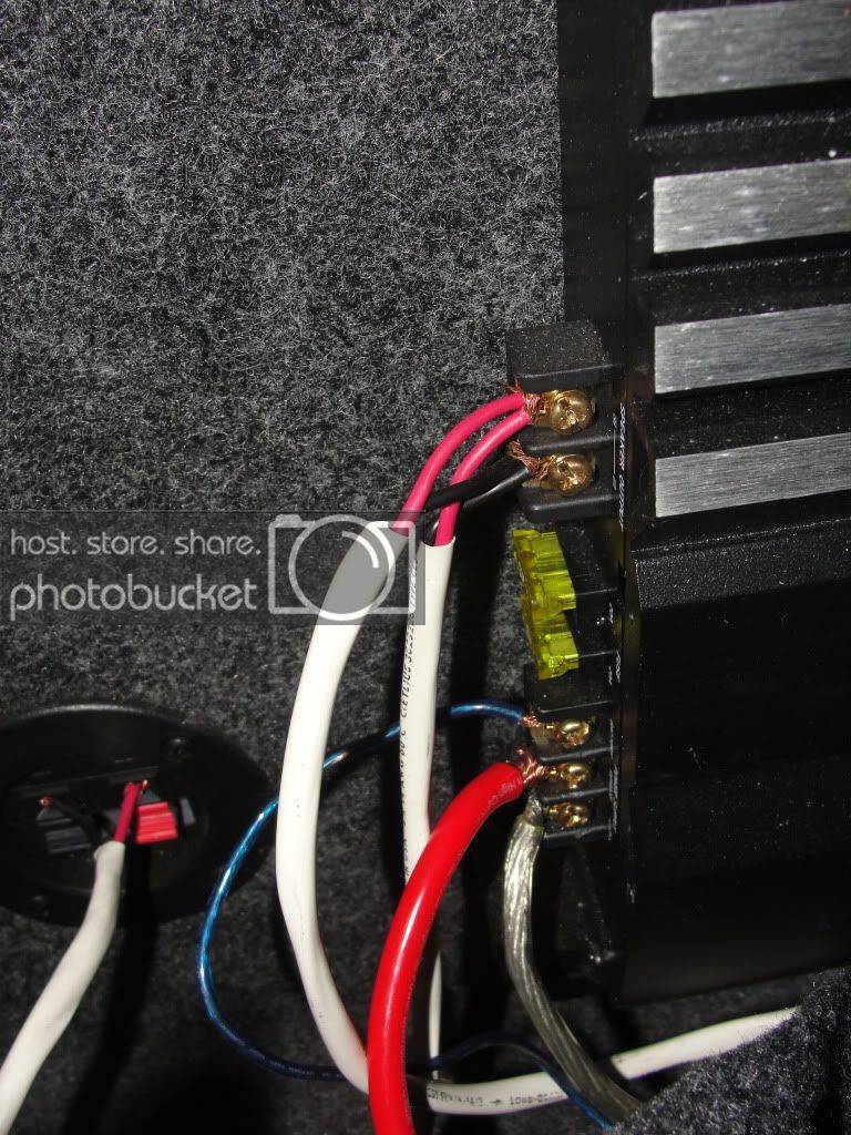

I don't know a thing or two about stereos but I've come across an issue. I had to put a spare tire in my car causing me to have to remove my amp box and subs. Upon putting it back, I had to reconnect the wires and now i am not getting power to the amp or subs. If the wiring stayed the same etc. must I reset something on the stereo or is there a larger issue? I am quite certain the wiring is the same etc. so I hope I am missing something...Hope there's an easy answer!

ABOVE: from top to bottom it says remote, battery then something else i can't read on the bottom 3 wires

The 12V positive/Battery (large red wire) and remote (small blue wire) are reversed, the remote wire should be in the middle. Fix that then see if it turns on, you might be SOL, with it wired that way it might have fried the remote from the head unit.
Yep, you're right. The red/blue wires in pic 1 need to be reversed.
Switched the wires, but no luck...However, the light did come on for a split second when made contact with the remote wire??? I checked the fuses across the vehicle and realized the fuse diagrams don't even coincide with the manual anymore. This car is wired so terribly...Well, If the head unit is blown what does that mean?

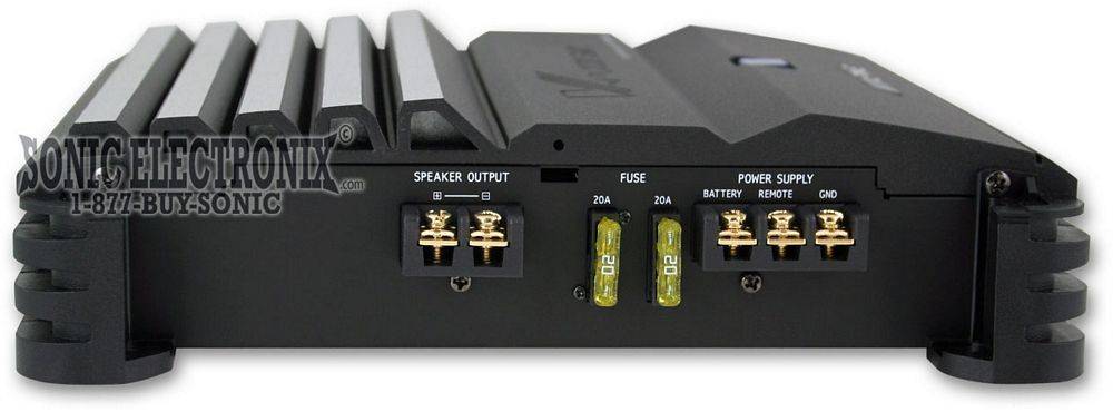

Here is a basic diagram of the amplifiers wiring.

Amplifiers use a low current 12V signal to trigger their on switch. The way you had the amp wired before, if the fuse on the red wire wasn't already blown, the red wire was providing the turn on signal. This meant the amp was trying to feed it's high current power supply from the small remote turn on lead and those circuits were not meant to feed that kind of current. So if you have an aftermarket head unit it could have damaged the internal circuit that provides the remote turn on signal, so you would need to replace the head unit or find a different signal to make it work. Since I don't know exactly what is installed. Do you even have an aftermarket head unit? If the factory headunit wasn't changed there is probably a line out converter providing the remote signal, in that case you would need to replace the LOC.
