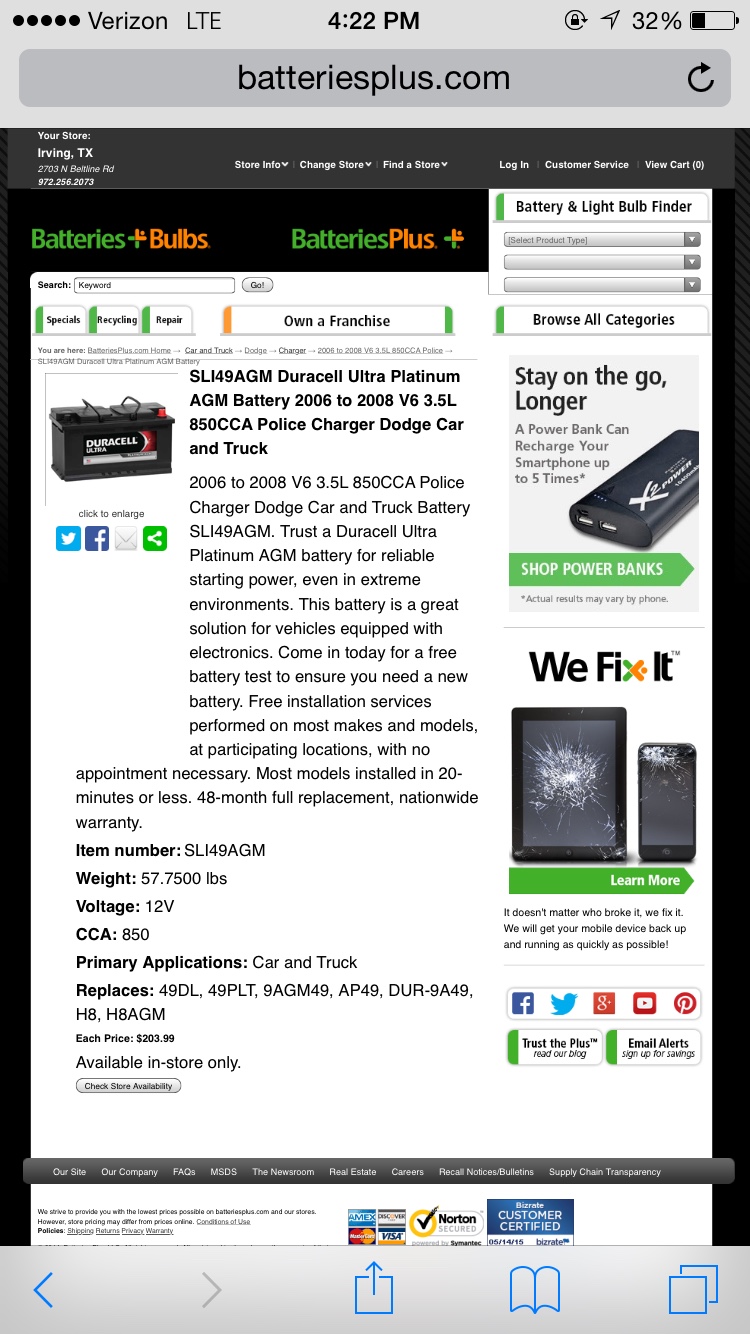

This a good batt? Don't think I need it. Car isn't dimming with ac and headlights on. Just wanted to know in case I do have problems after installing the 4 channel it's a class ab which I know isn't as efficient as the day class.
Looks the same as my Exide group 49's they are solid! Probably built at the same place
