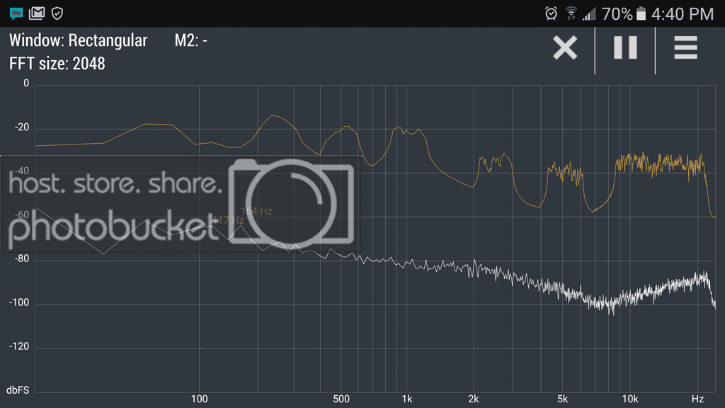

A phone app? Seriously. And where is left and right?
And **** that's some nasty high end. And where is the bass
Get REW, run it up to 90-95db. Get left and right full range.
Do I need to show you how to measure? Real question
its not scaled on the topend. where the bass? you sure you reading this right? nasty topend? don't worry i will get each driver once i have a chance.the topend is outstanding nothing nasty about it the scale is so small ill stretch it out so you can see.
Well you may like it but I'll tell you it won't score good on the top end. The rise should be a gentle roll off. Just looking at the measurement I'd say it's bright. As yes, where is the bass. Also next time use RTA not FFT.

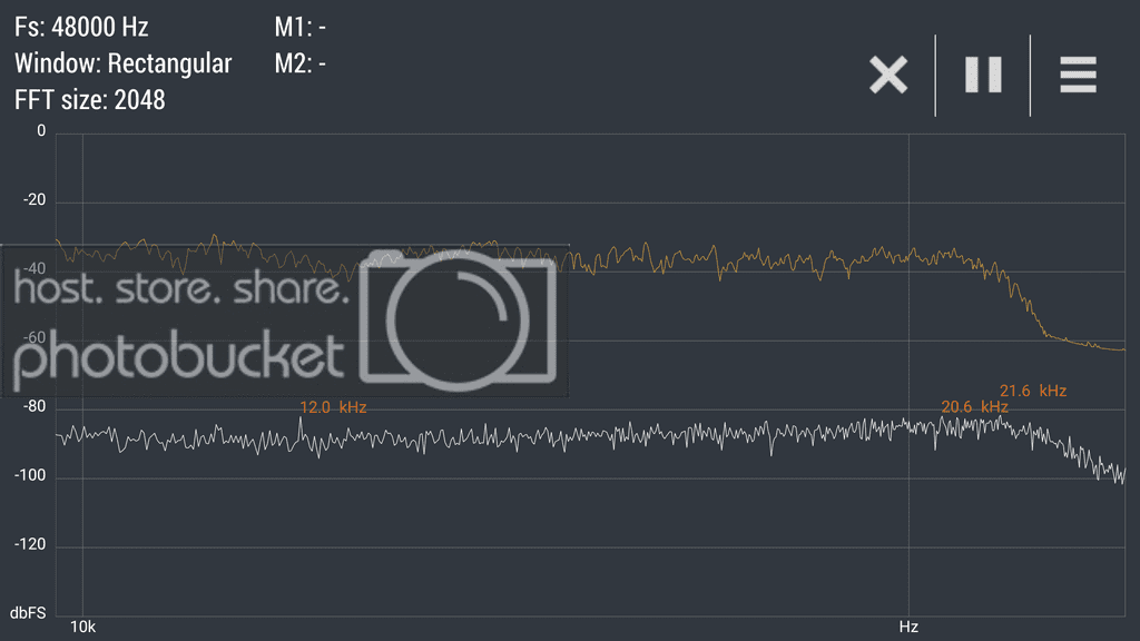

the sensitivity is really high. here it is stretched out. its **** near FLAT from 10k to 20k.
that's not smoothed let me see your FR it my "topend *****" its literality one of the best sounding car audio tweeters i've hear under 300 bucks.
its not brite i assure you coming from someone who HATES bright systems. its actually not bright the "bright" sound comes from the 2-5k region 15-20 is your air. they sound open and defined. notice how i have the 2-5k cut? thats why its not bright but its AIRY. ill be shocked if it does score good it really does sound excellent. id love to see your FR for reference but no way in hell your going to do that.. FYI my box is tuned to 38 right now because i'm testing so yea 20 hz is pretty low still more than audible but my subsonic is high because im seeling well over 2k clamped @ 30hz with not SSF..
also hearing sensitivity is much lower as you approach the limits of your hearing. so between 180 and 20k its alot lower than say 10k and MUCH MUCH lower than 5k. same for subbass. once you get down to about 30hz you sensitivity drastically drops off..
i adjusted the sensitivity FFT IMO is easier to analyze if your can get past the non smoothed response you can see its pretty flat.
