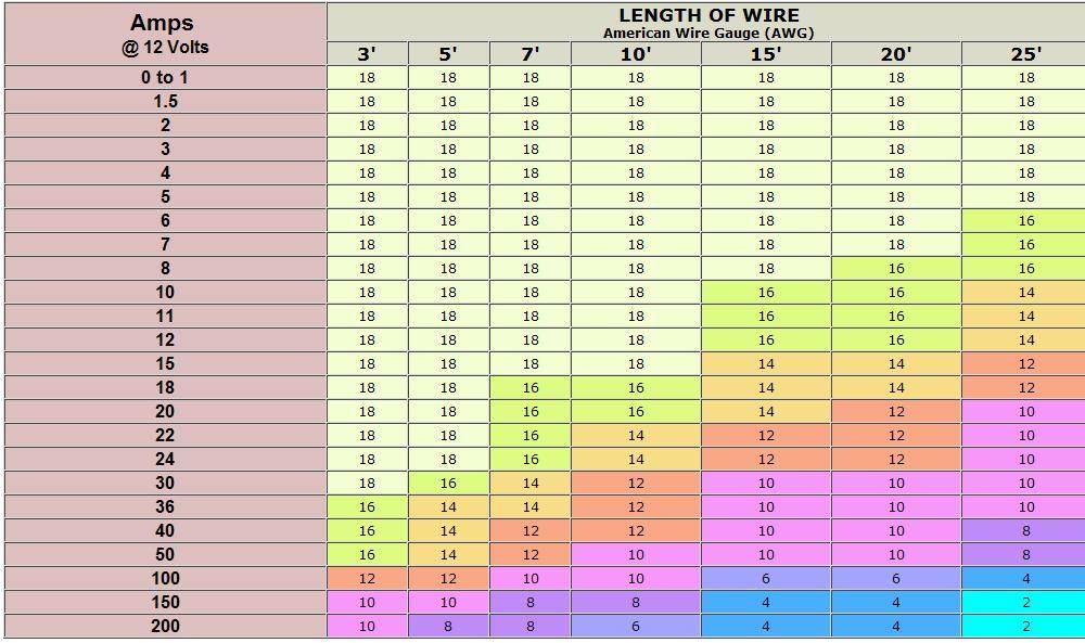

I personaly think using a distro block then running 4 gauge is completel retarded unless its to two amps... I mean seriously your only as good as your weaknesses so running a foot of 4 gauge is gunna have just the same affect of running 17 feet of 4 gauge... Cuz if 4 gauge could run the same current 0 gauge could no one would use it... I kinda picture it as a funnel, you run 0 gauge to 4 then it just get choked and adding a distro seems like it would just ad one more "restriction" to the system... am I wrong?
. am I wrong?
Yes. Completely wrong.
1 foot of 4 gauge will supply far more current than 17 feet of 4 gauge.
have you never seen a chart similar to this one?
Ya I know that... Im say using 16 feet of 0 gauge then a foot of 4 gauge... thats like runing water down 6" pipe then funneling it down to a 3" pipe at the end it will still flow the same amount of water if it was a 3" pipe all the way through since you can only flow so much water trough a 3" pipe so fast even if it did have 6" pipe leading up to it.....
That analogy is perhaps better suited to an eavestrough forum.
The flow of electricity is often described VIA the flow of water, but for your analogy to work more accurately, you would need to include the resistances developed by turbulent vs laminar flow in the system.
There is still a lot to gain by having the main run as 0 gauge and a short run of 4 gauge from a dist. block VS 1 single run of 4 gauge.
