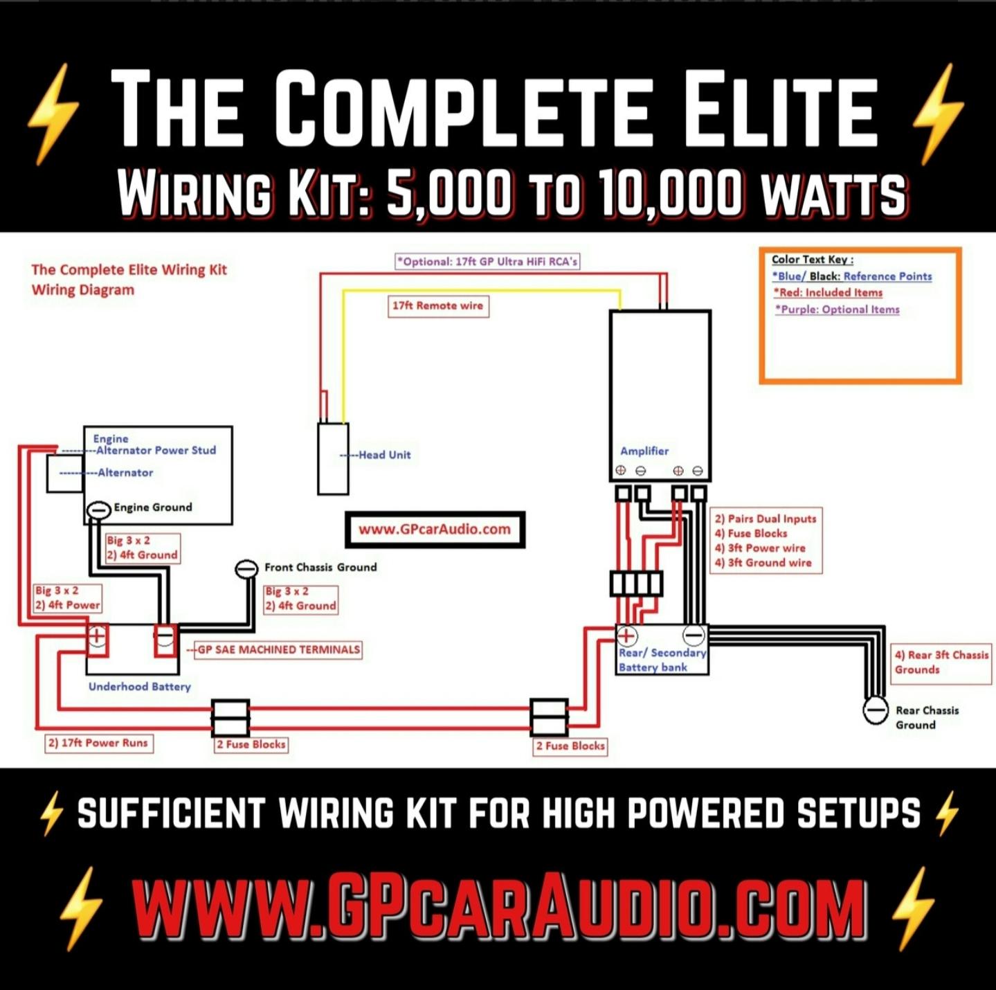

So i got the big 3 done today and this is how the shop did.
Alternator to postive battery
Then 2 grounds 1 from the battery to the chassis
Then 1 from the engine to the chassis
My question is was the engine ground supposed to run from the engine to the main battery? The wire diagram has it has that but the shop just ran it from the engine to the chassis.
I have attached the wire diagram I am following.
