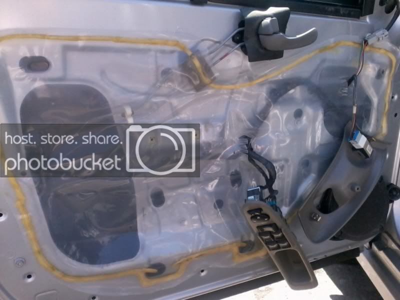

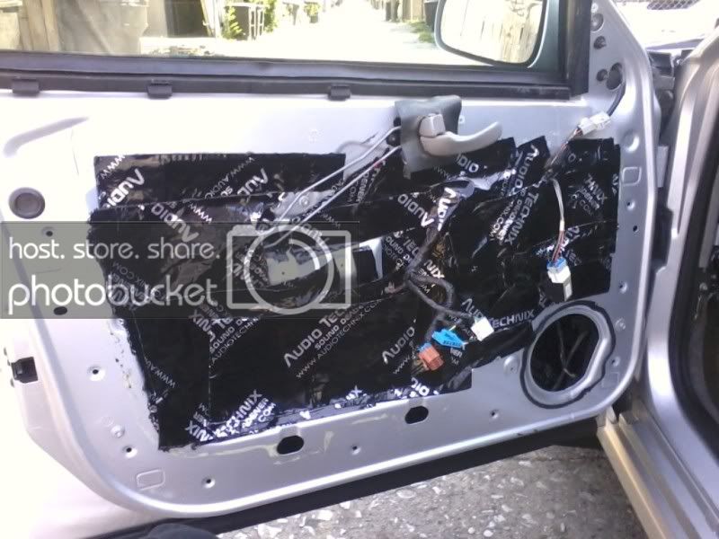

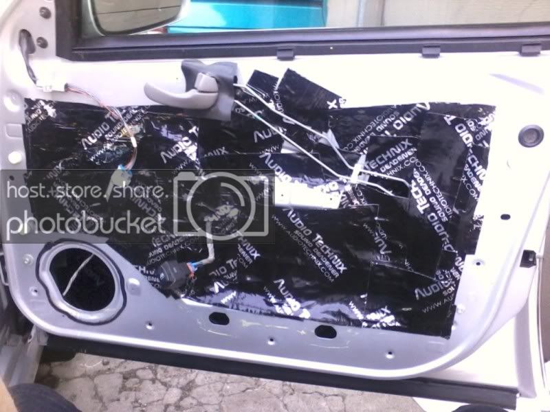

Alright i got both doors finished with about 2-3 layers on each skin. For the 3 holes on the out skin i used some steal mesh we had lying around to cover it than deadened over it. I was going to use the factory baffles for the speakers but they would not fit so i had to use the morel coax's i had lying around instead of the CDT's sometime this week i will get around to making some mdf baffles. Had some issues with the radio and trying to make it work with the factory amp so i got agrevated and left it for tomorrow
Before
After
I came out really happy with the way it sounded, especially it being just the coax's on HU power. Can't wait to hear how the CDT's will sound when i get them in there!!!

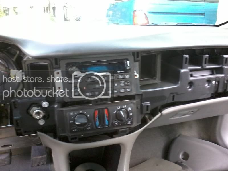

Have to take off the whole front dash just to get to the **** radio. Last 3 vehicle's i owned were insert tool and pull out!
there is a nice ground spot right behind the radio so i can ground it there, i think it might even be grounded there already haven't really checked!
