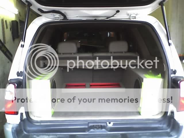

After all wires are ran inside car heres how it sits in back, for now.

Here's a pic of a 4Runner I did... don't mind the green tape... it's hold the beauty panels on while they dry. Two Orion XTR12's and two HCCA Amplifiers. Oz Elite components in the doors.
