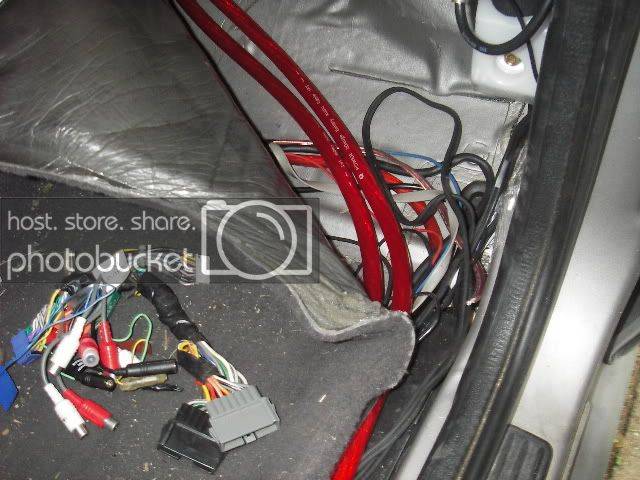

I worked on the electrical side a it this week.Since I can't do any testing till the weekend I thouht I would put in some of the 1/0 I got from Kent(thanks).
I ran two runs of positive for now to the back.I didn't have any voltage drop from front to rear after doing both runs so I should be fine for now.
FIrst pic

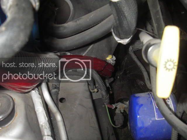

Here are the 2 runs coming through the fre wall on the passenger side.This is the usual place I try to run most of my power wires on any vehicle.Unless there is a groumet or the battery is on the driver side.

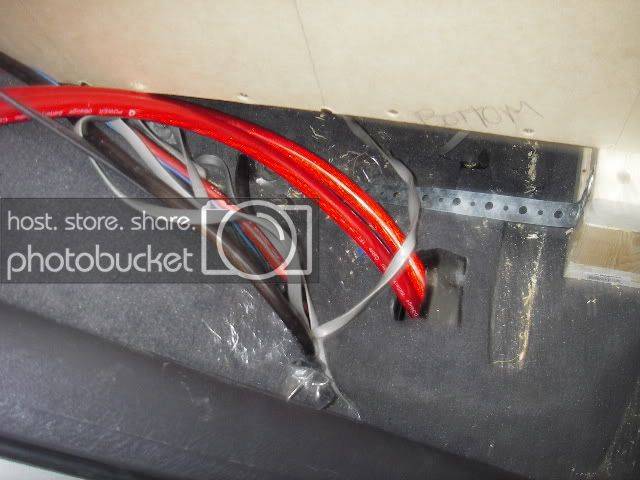

Here you can see them runnin along the floor board.With the 2 runs it is a little harder to get the carpet to set right.However I was able to make it almost disappear.

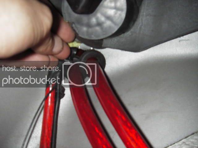

Here I ran it out the latch spot where the seat used to be.I was able to get 2 runs out of 25ft no problem.//content.invisioncic.com/y282845/emoticons/tongue.gif.6130eb82179565f6db8d26d6001dcd24.gif

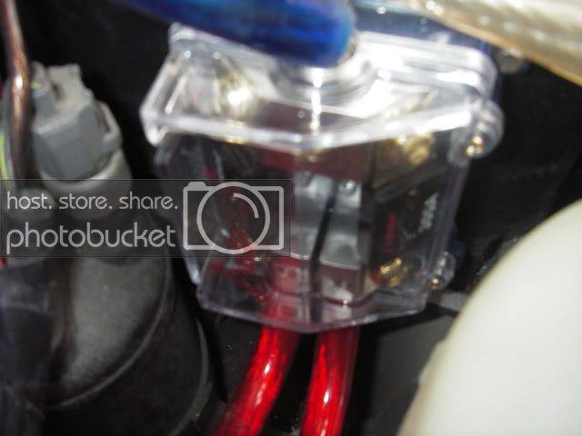

Here is the fuse block under the hood.I had to modihy it a bit seems how it was for 2 4ga wires.//content.invisioncic.com/y282845/emoticons/wink.gif.608e3ea05f1a9f98611af0861652f8fb.gif

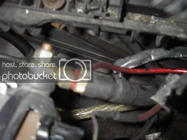

Here you can see the wires tied together and routed away from the engine to prevent them from melting(has happened to me in the past.)Sometimes I wrap it with some scrape deadener with the aluminum backing for exra insurance.

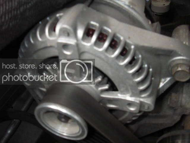

And here is the Iraggi Alt I got.Its got a custom machined pulley made of aluminum.This lightens the weight by about half.
