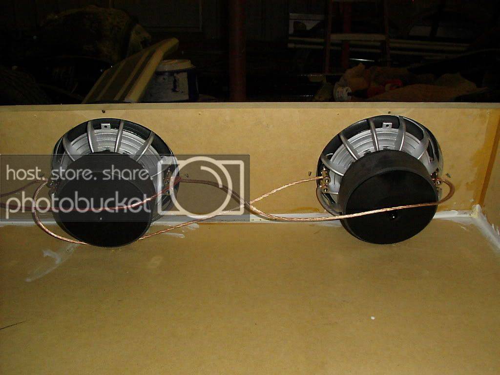

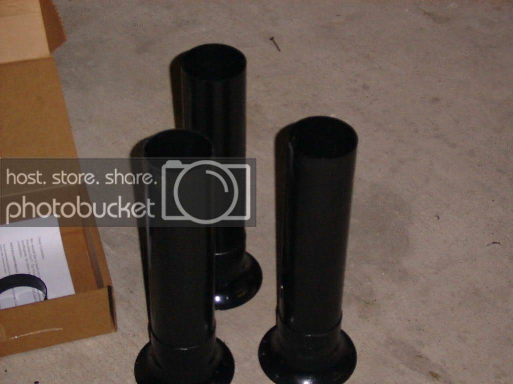

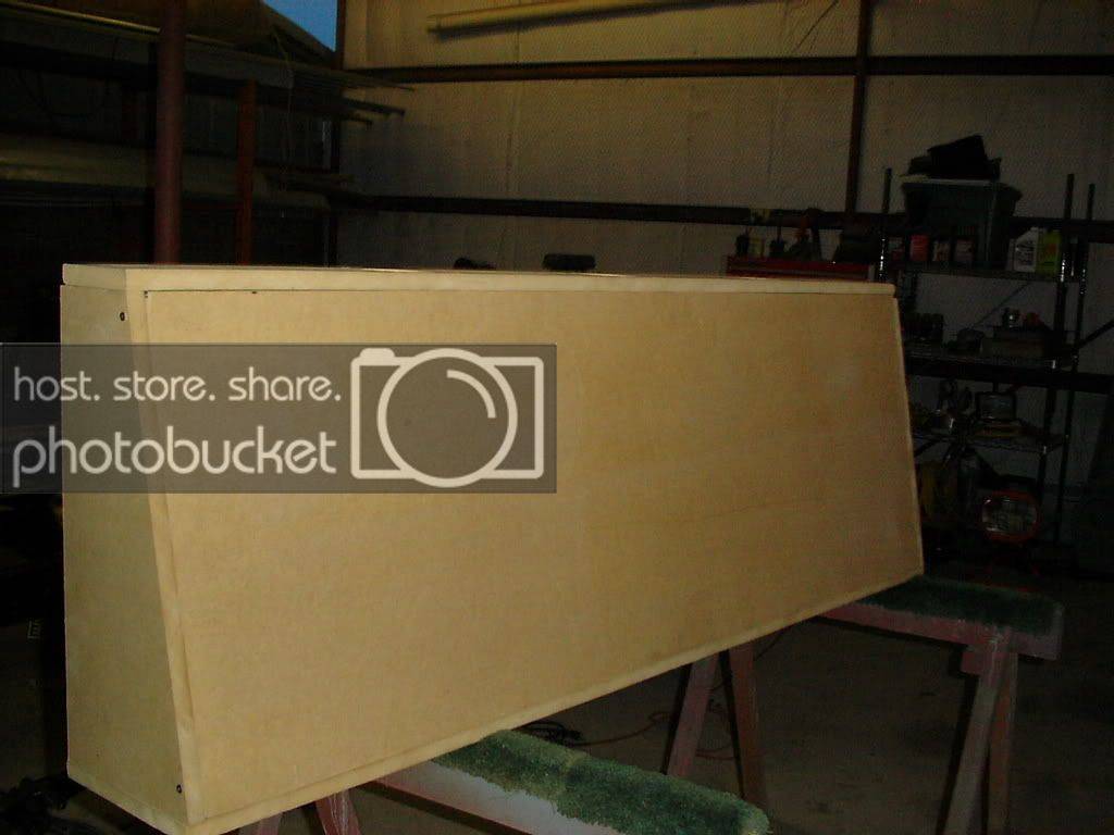

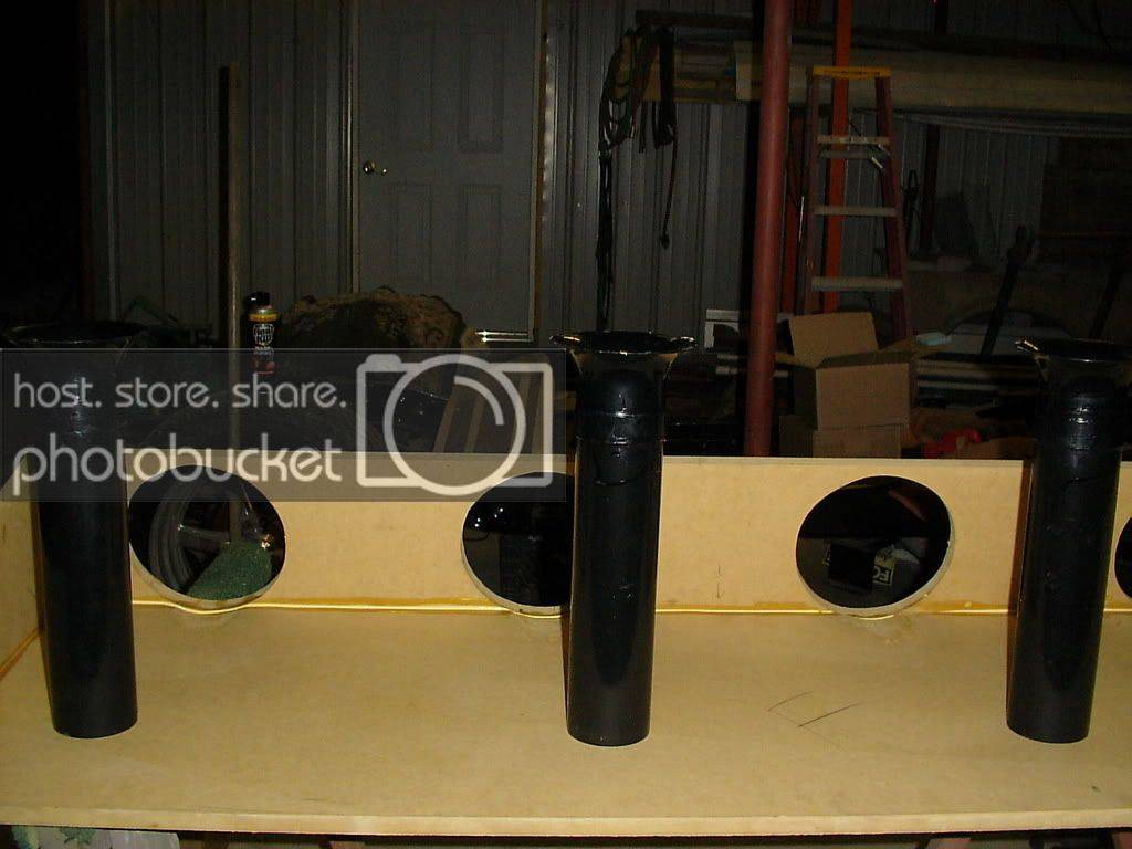

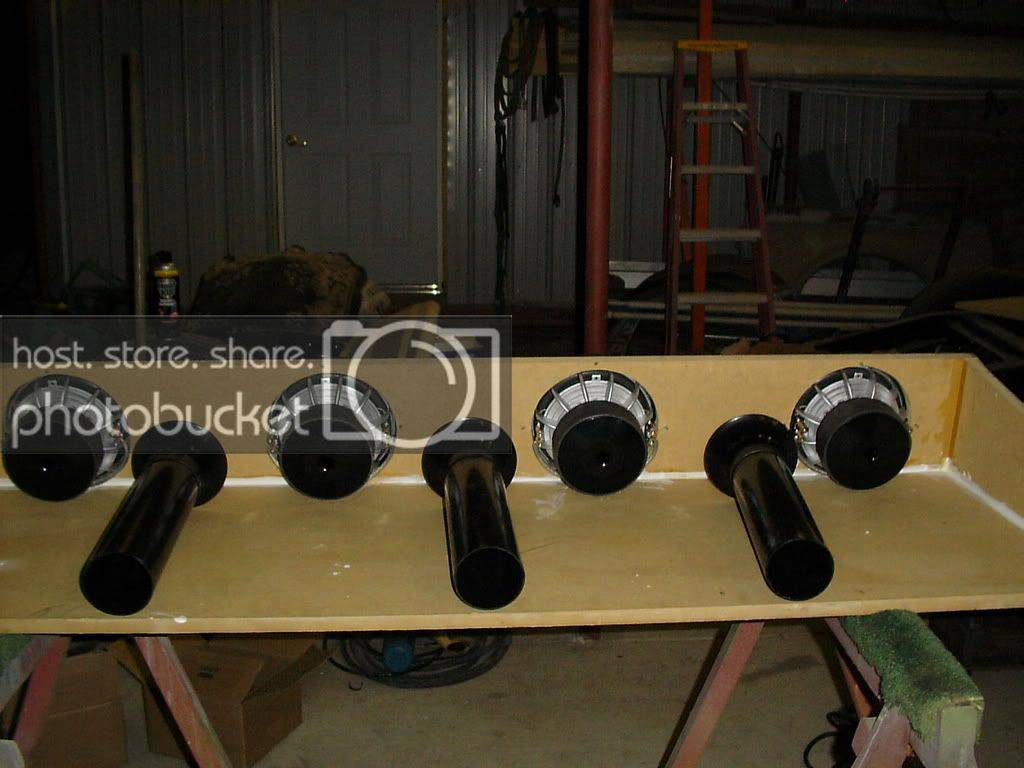

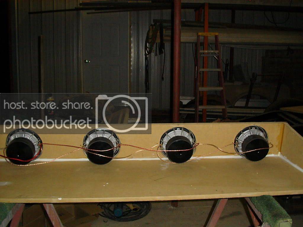

1994 GMC Sierra 1500 with 4 8" Assassins powered at 2 ohms by an Autotek mm1400.1. Each sub is seeing just under 300 watts. Box is 2.9 cu. ft. tuned to 35 hz. with 3 3" aeros.

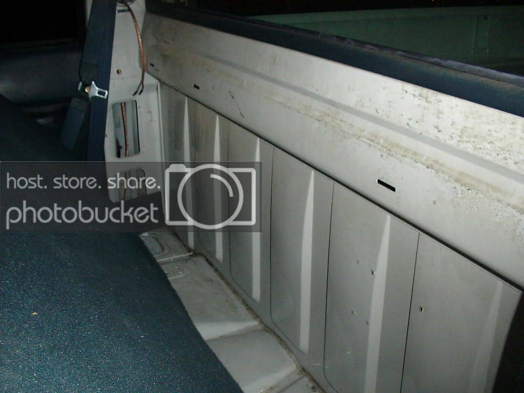

This is where the box is going

This is my friend's box build I helped him with. Turned out pretty badass. I will get some pictures of the box because we carpeted it and trimmed the ports down because it was tuned too low.

Yeah we had it tuned lower and then cut the ports down to tune it higher. IMO I think it still needs to be tuned higher because it still hammers the lows and gets **** loud. Louder than I thought. I am very pleased with it. It looks very good now that it's carpeted and you can't even tell he has a system that is until he turns some tunes on, which is the coolest thing I think. Yeah if I were to do another build for a truck I would do a 12 or maybe 2 tens. I wanted to do it downfiring though and we got a sick deal from Ascendant Audio on those 8's which the bottom of the box is only 8.5" wide and 4.5" at the top and a whopping 62" across. I will def. need to get some videos of this up on here. I think yall will be surprised at how much flex these 4 8's produce. Now I just need to get him a better head unit lol!

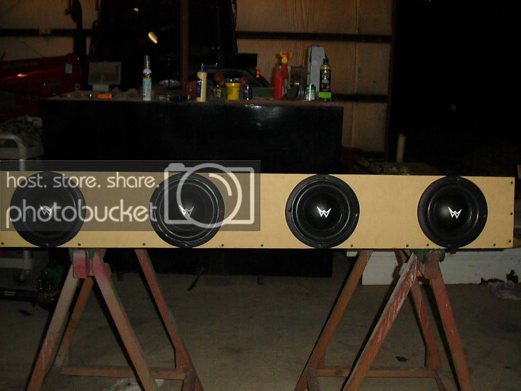

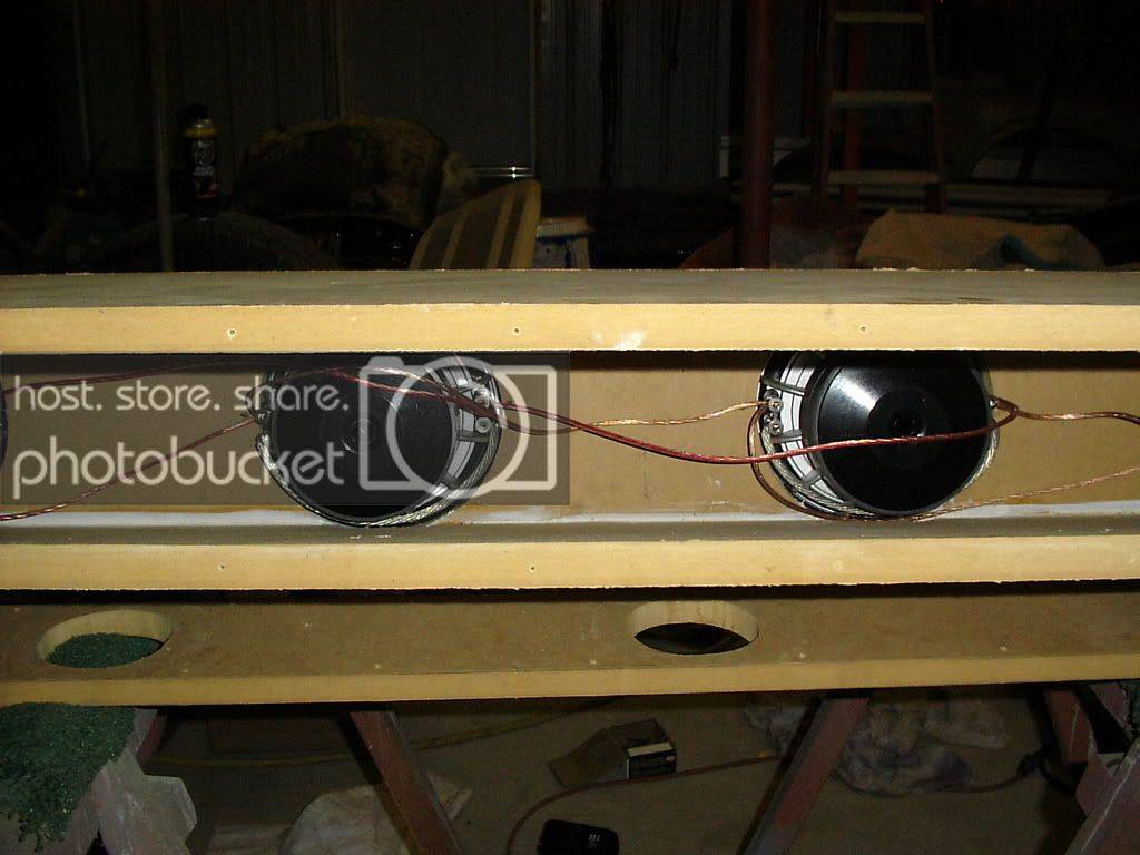

You can see in the 4th pic from the top where I had to trim the acutal front baffle down so the basket and motor structure would fit. If he wants to go bigger in the future then we'll build another box for 8 of these bad boys and throw some power on 'em. The ports come out right behind your head which I think is pretty cool
