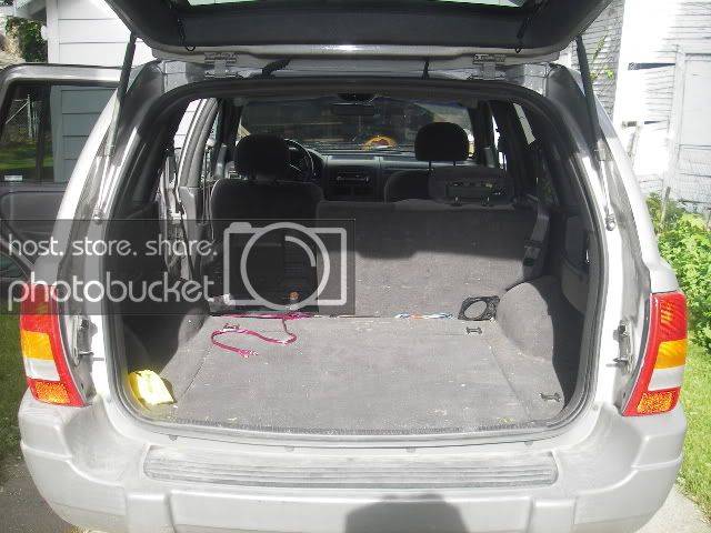

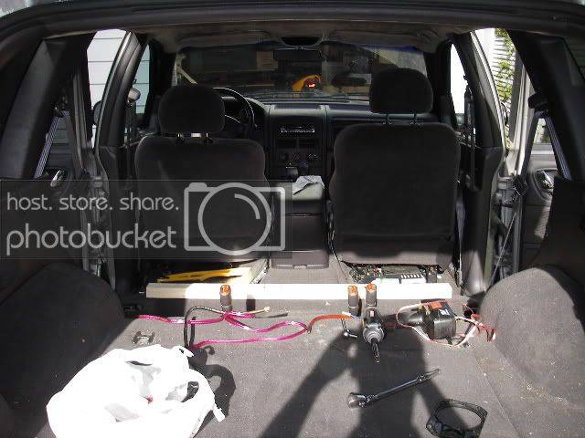

Here are some pics of the vehicle..

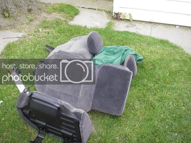

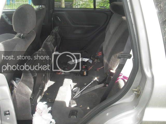

I started by removing the rear seats

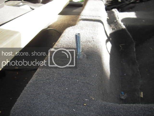

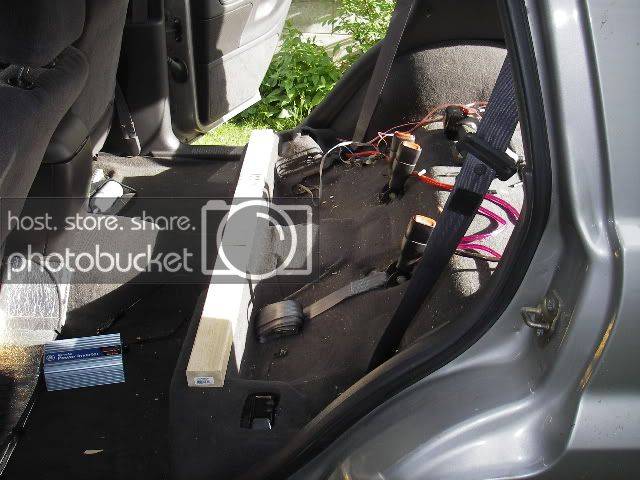

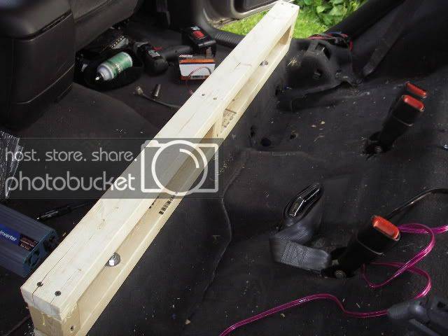

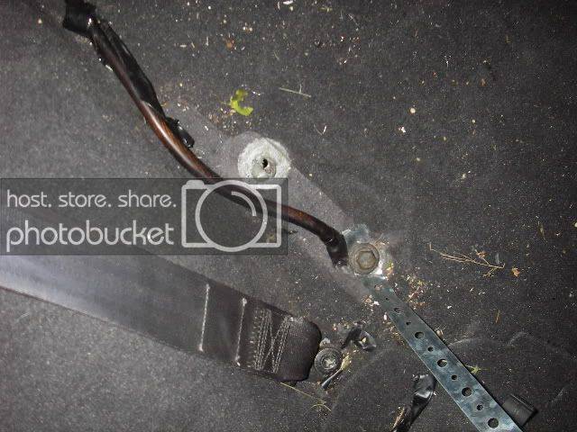

Then I fastened a piece of 2x3 with a couple of carage bolts to the body so the box will be secure.

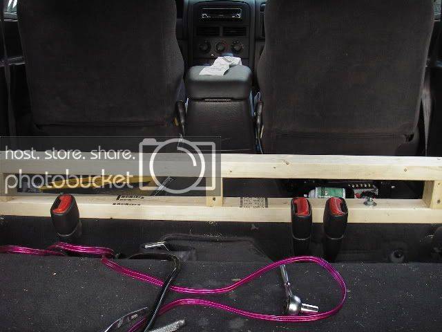

After that I built it up so the top would be level with the rear cargo area.

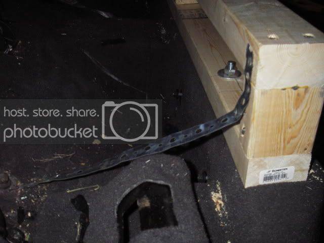

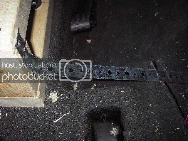

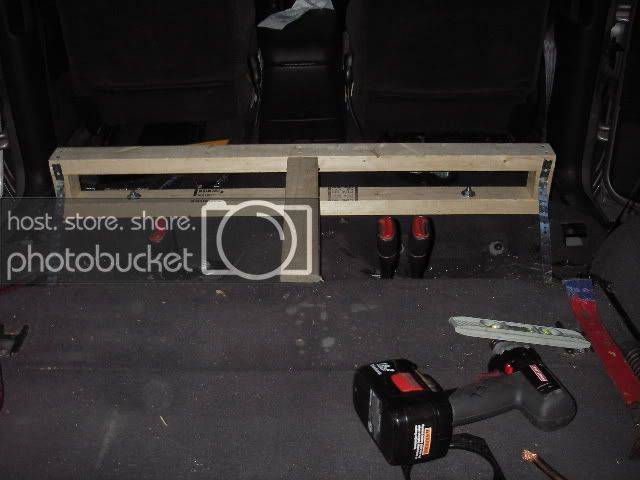

Then I added some strapping to brace the "wall" horizontily
I also added a piece of wood to the center cause it had a little wobble if you pushed it back.
nice start...i braced mine down to the frame but a little differently. yours looks a LOT tougher.
ill tell you what...that SUV is gonna be LOUD AS HELL!!
GL on the build. cant wait to see more pics
Thanks guys.I just did a little tonight to get me in the mood for this weekend.Gonna be some long days.
I plan on doing double wall all around.So it will be twice the work.Lots of screwing:)
