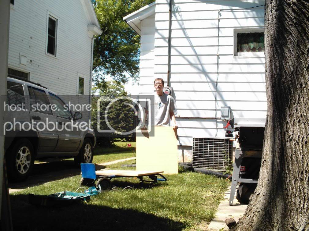

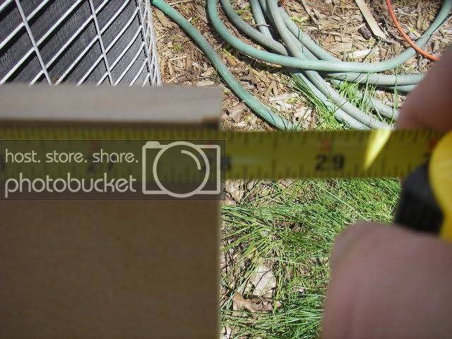

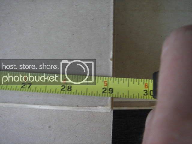

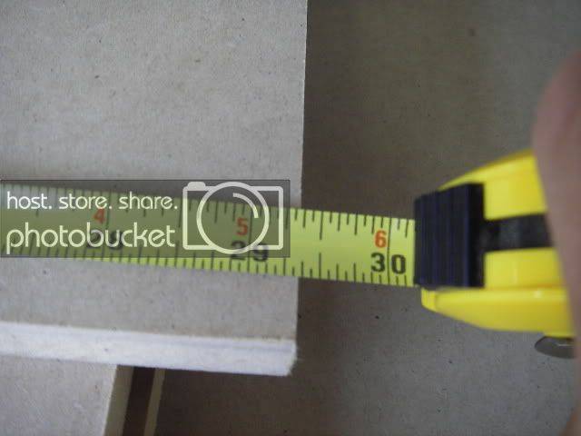

Ok here is why you never have Lowes cut your shit!
I asked the guy to cut me 2 pieces at 29".I egt home and look what I ended up with!Good thing I anticipated them being off.I really needed it at 28".I only had them cut the wood was to make it more managible for me.Since I am doing this on my own pretty much.

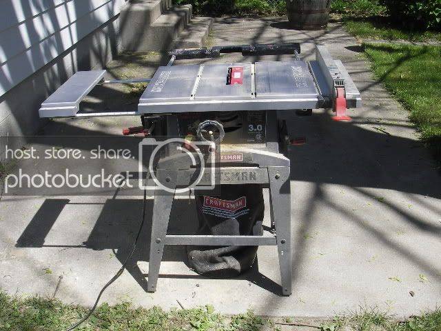

Here is the star of the show:D

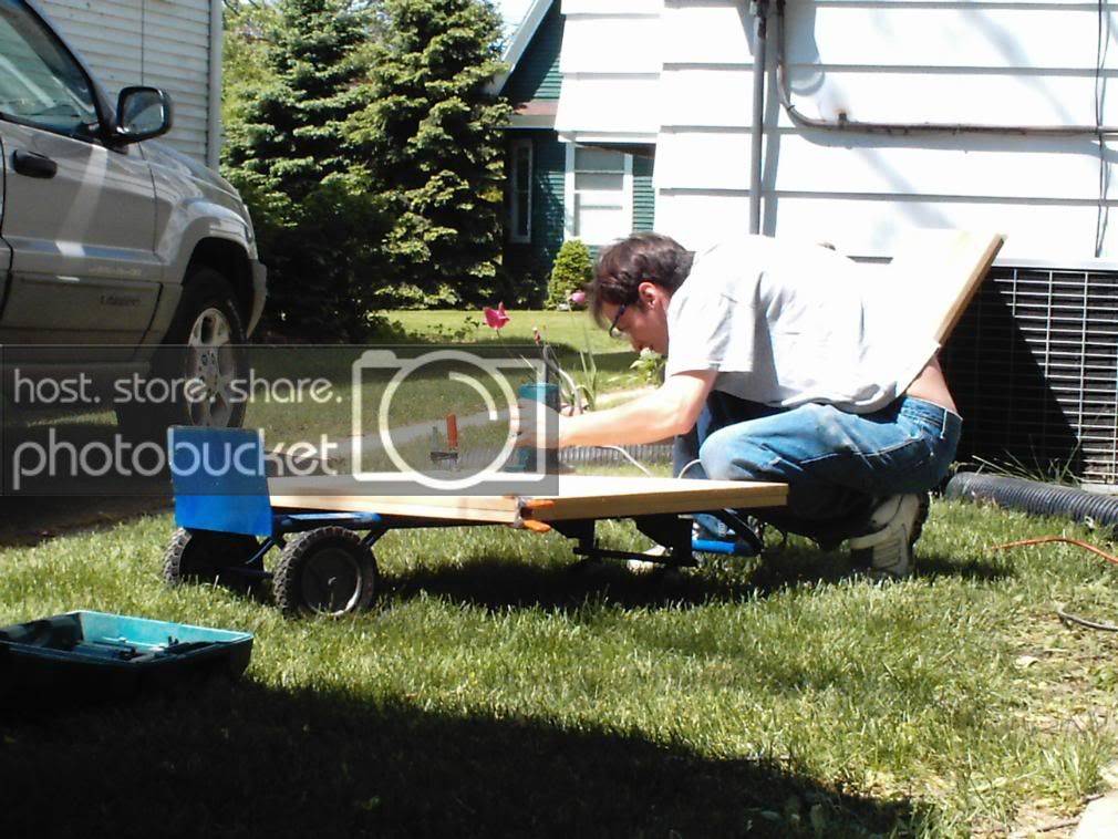

I guess it was of me using the router to clean and strighten all the edges.

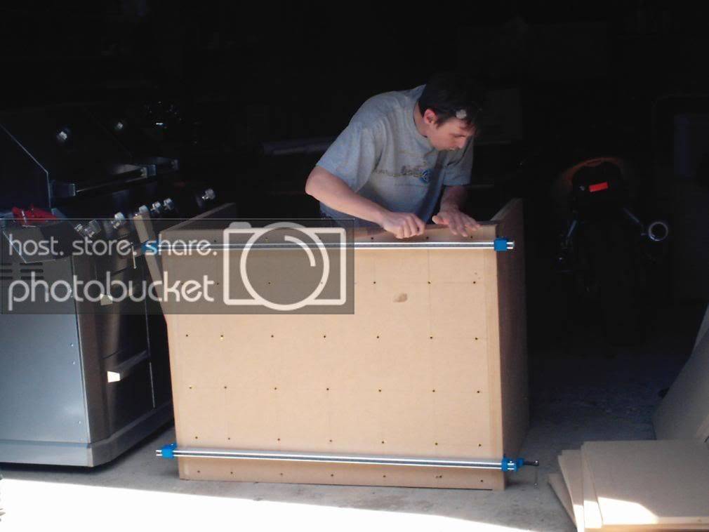

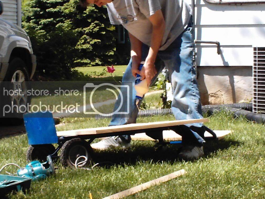

This one is of me spreading glue to secure the 2 pieces of wood together(1.5";))

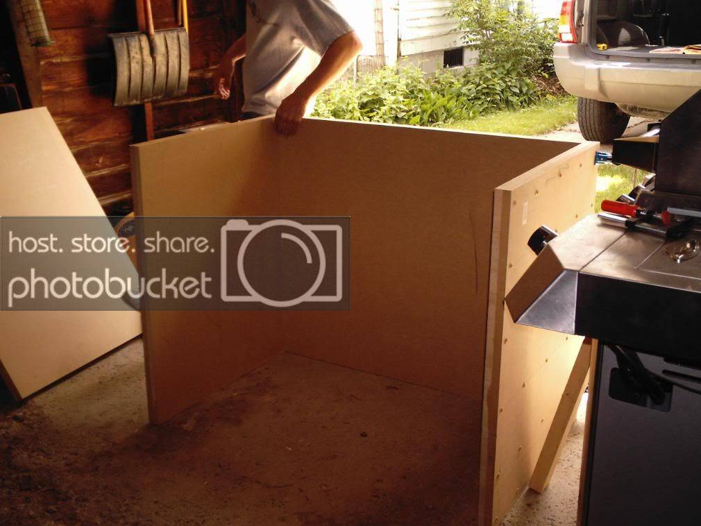

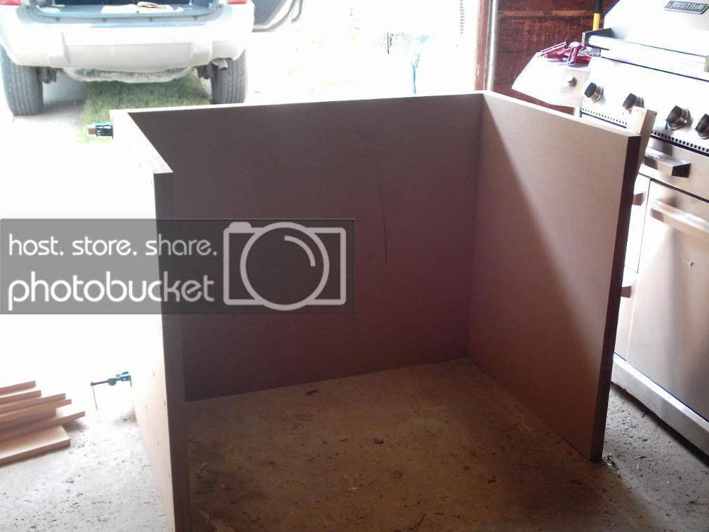

These are a couple pics of the sides and back together for a dry fit.
Me working on the sides to make sure there flush.

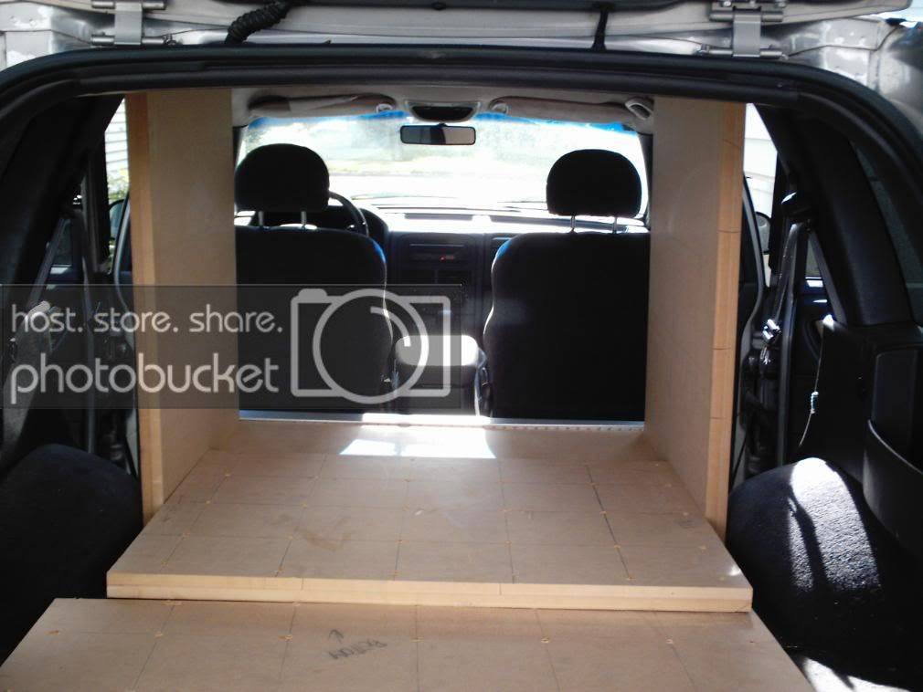

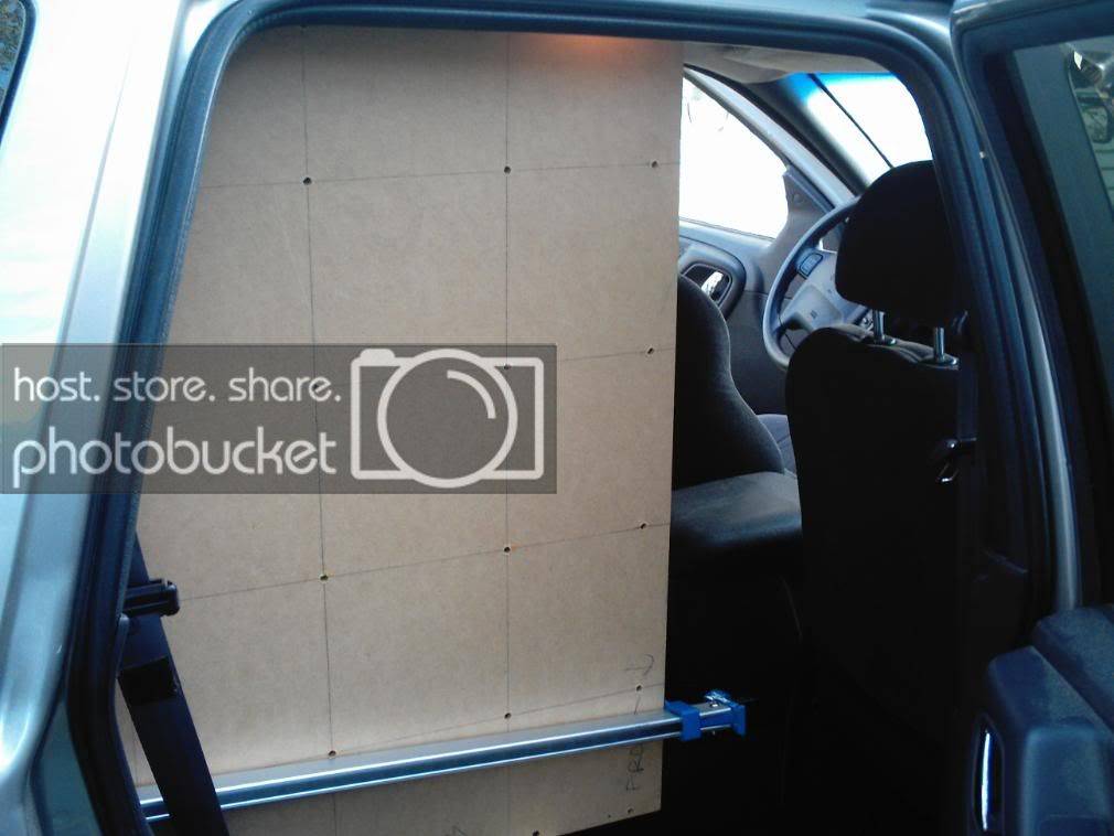

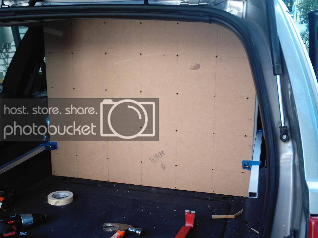

This is a test fit of the box in the vehicle.

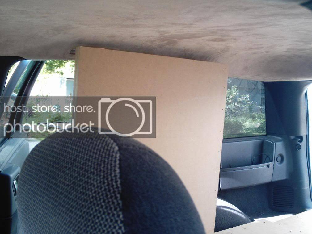

Well I ran into a little problem with the sizing.I thought I could fit 34" in so thats what I went with.
But theres a problem when i tried to fit the top in it wouldn't fit!//content.invisioncic.com/y282845/emoticons/eek.gif.771b7a90cf45cabdc554ff1121c21c4a.gif
So I had to cut 1" off it to make it work.....

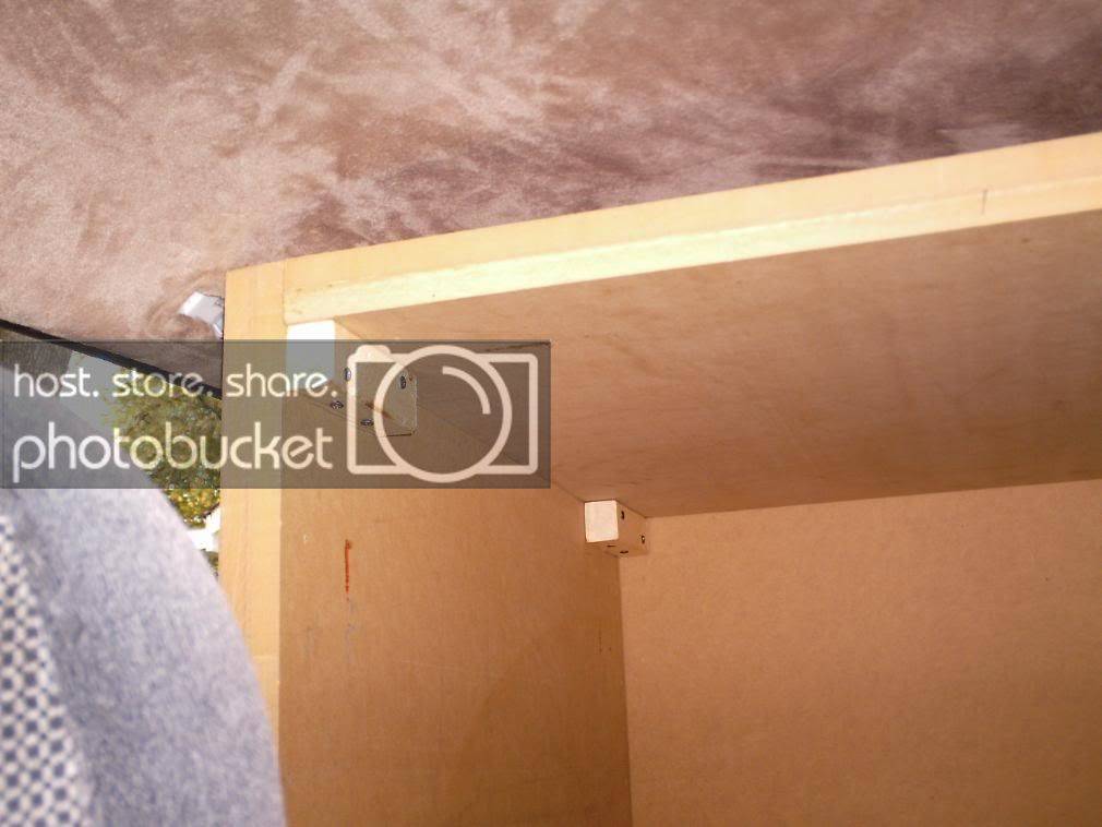

Got the back on as well

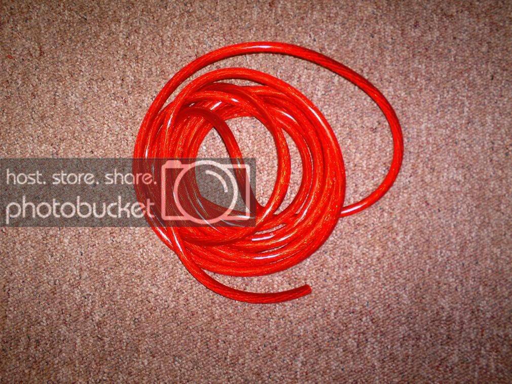

I drilled a whole in the firewall on the passenger side.That is how I ran most of my power wires for the last 12 years.Just easier then trying to find a spot that is useable.However if there is one(rubber graumet) and will work with the wire I am running then I'll use that.As for the ground I use one of the rear seat bolts that I cleaned up as the ground.I am still debateing on using this for this application or if I should run a full ground wire.
If you look at one of the pics you can see where I am talking about.It is the piece of black wire wire I attached the strapping to.
Definately do it, with the power your running I think it would be safer to run a full length ground.
Oh and I have the same table saw //content.invisioncic.com/y282845/emoticons/tongue.gif.6130eb82179565f6db8d26d6001dcd24.gif
I wasn't getting much voltage drop at the amp using the frame ground.However things may change.With the old setup I was getting some killer impeadance rise(probably from the box) so the current draw wasn't tremendous.But I think with the bigger box that might change a little.
Has anyone noted any differance when switching from a frame ground to a full length?
Keep in mind I will also be running a battery bank in the rear of the vehicle as well as the sock battery location.
